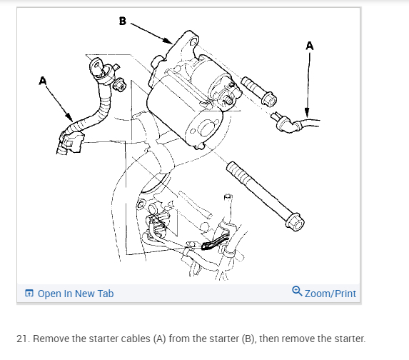

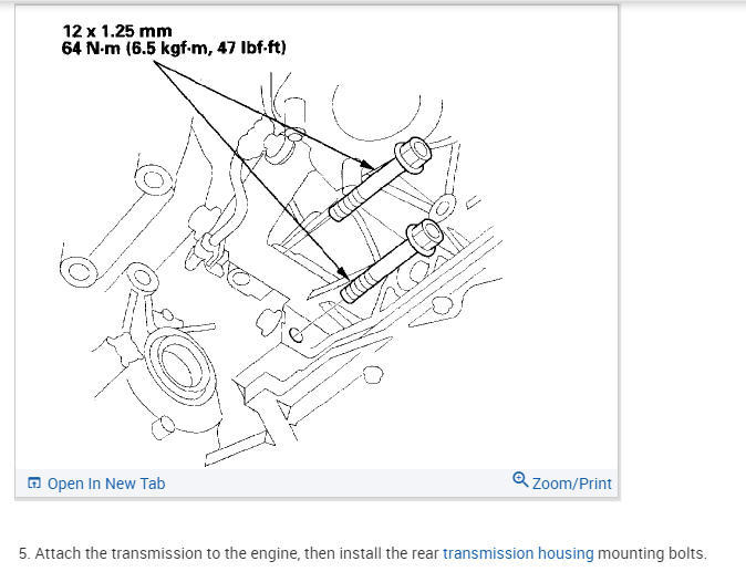

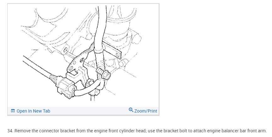

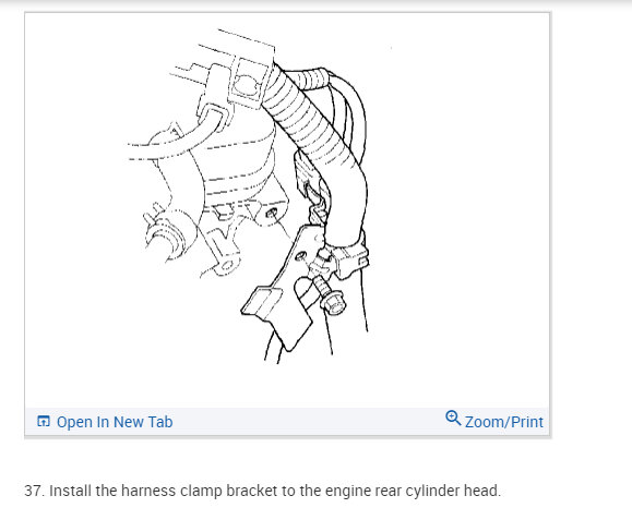

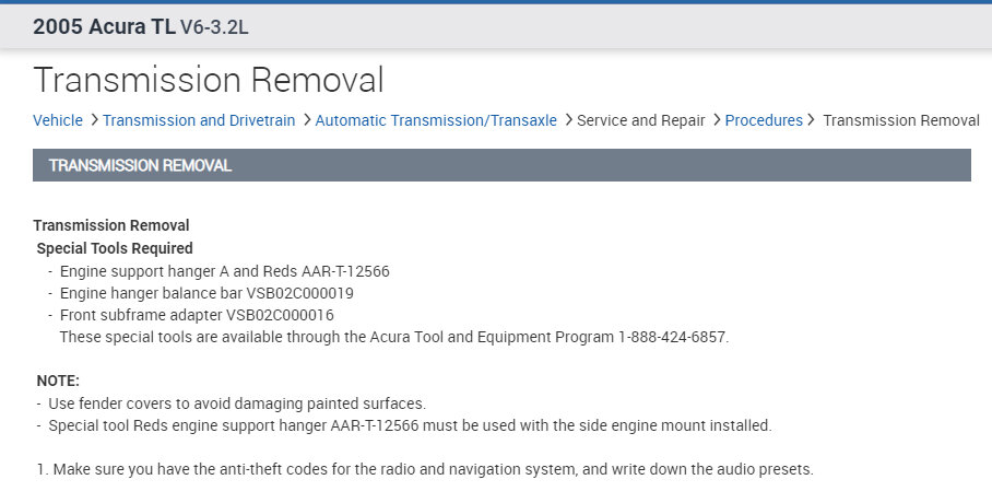

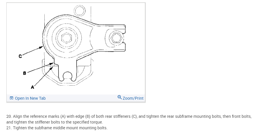

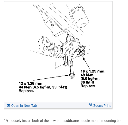

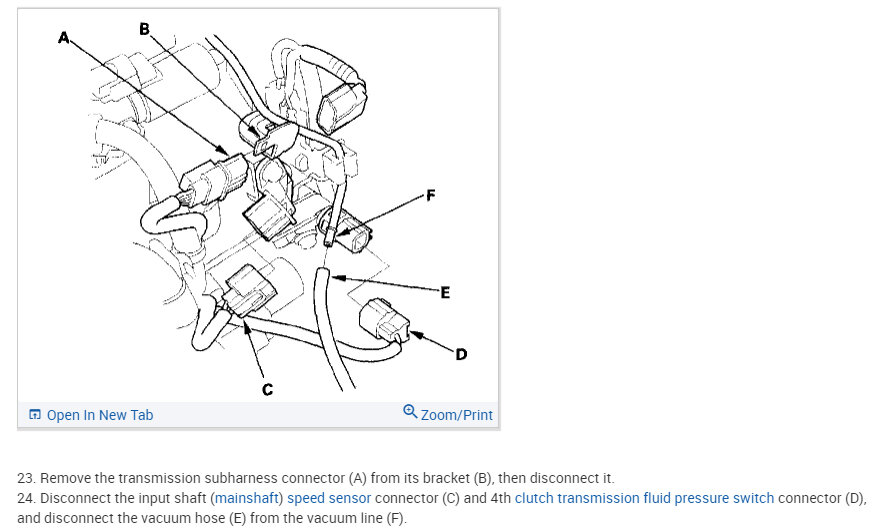

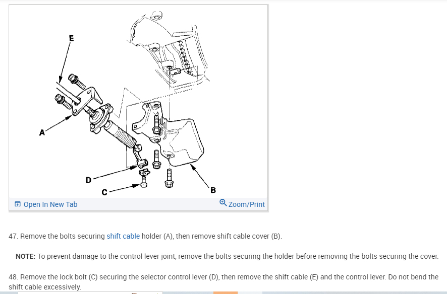

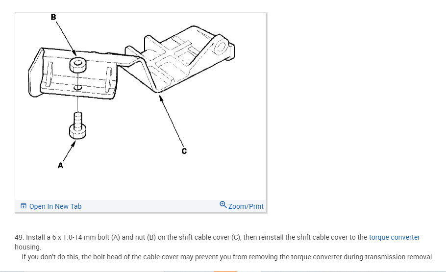

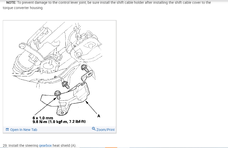

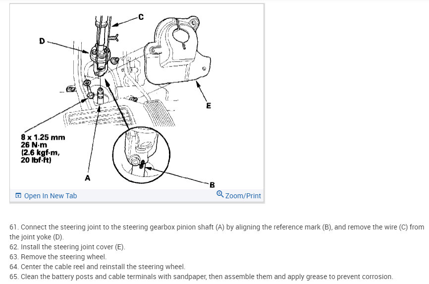

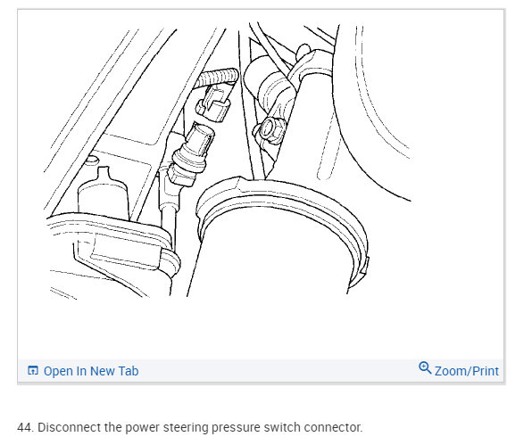

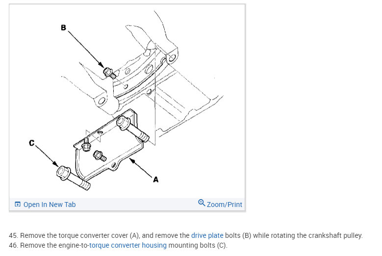

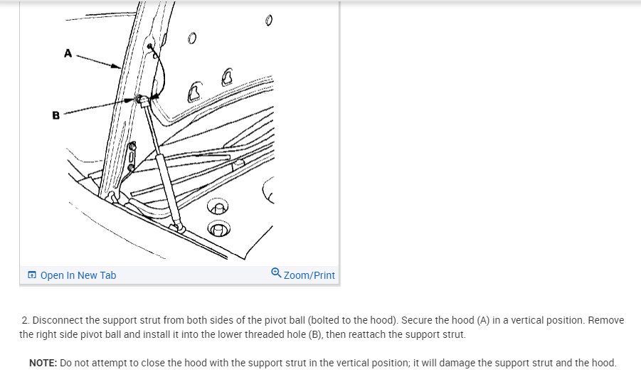

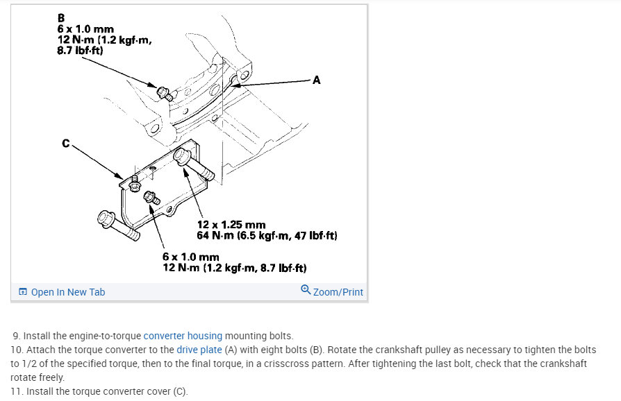

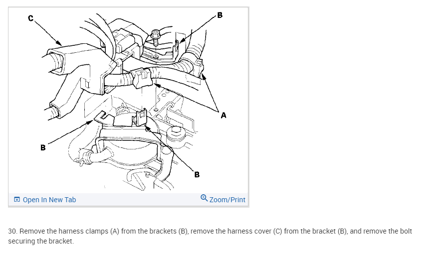

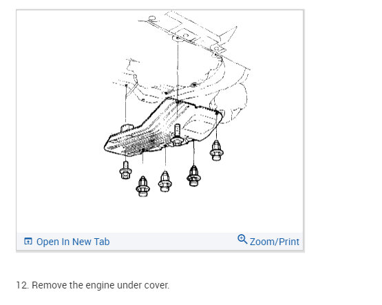

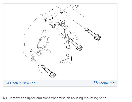

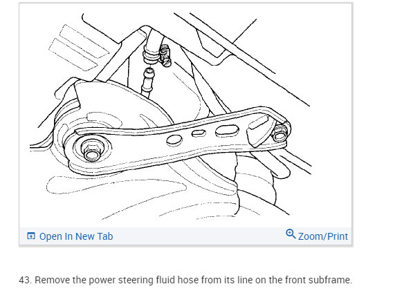

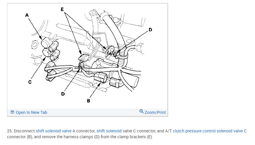

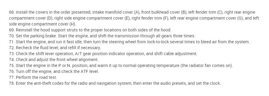

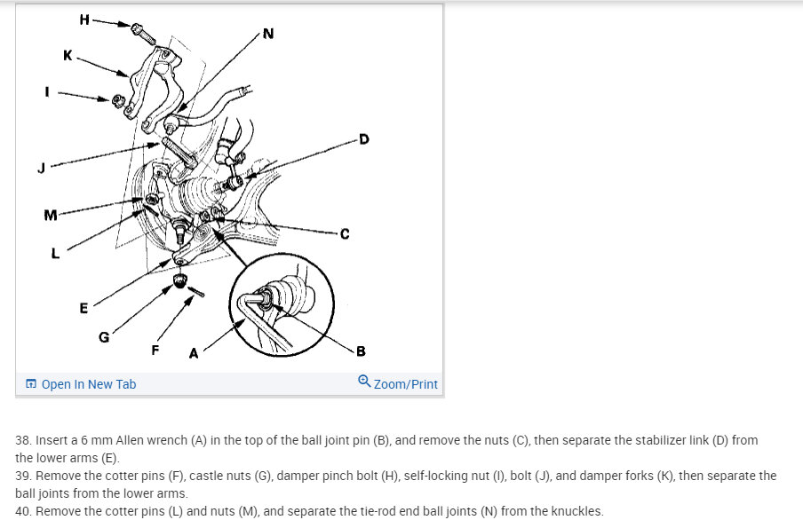

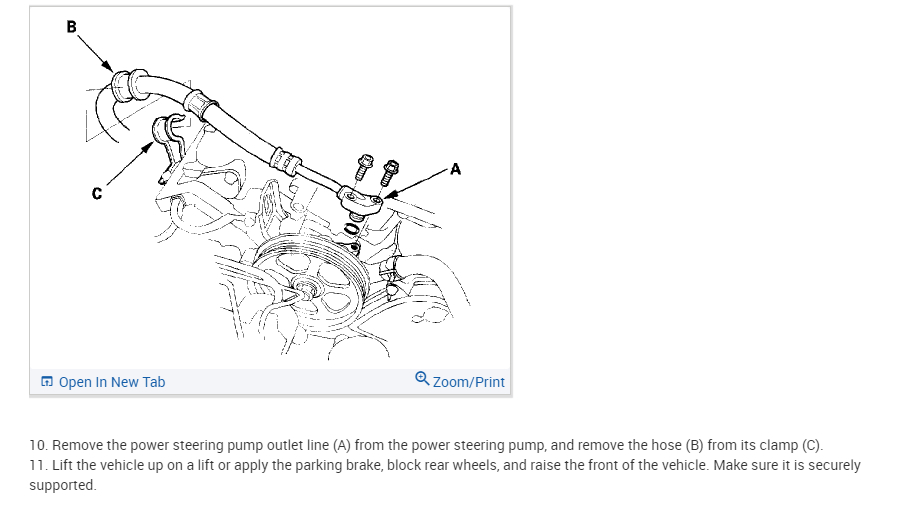

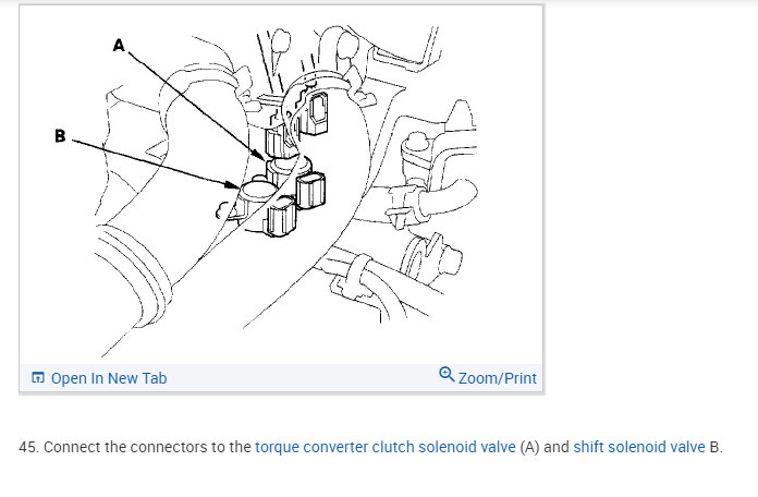

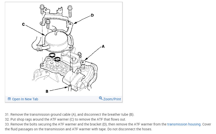

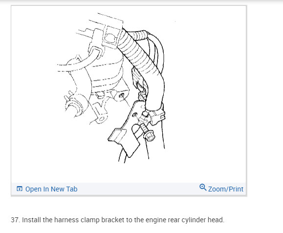

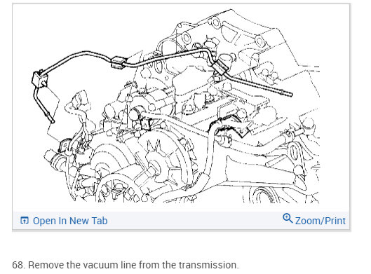

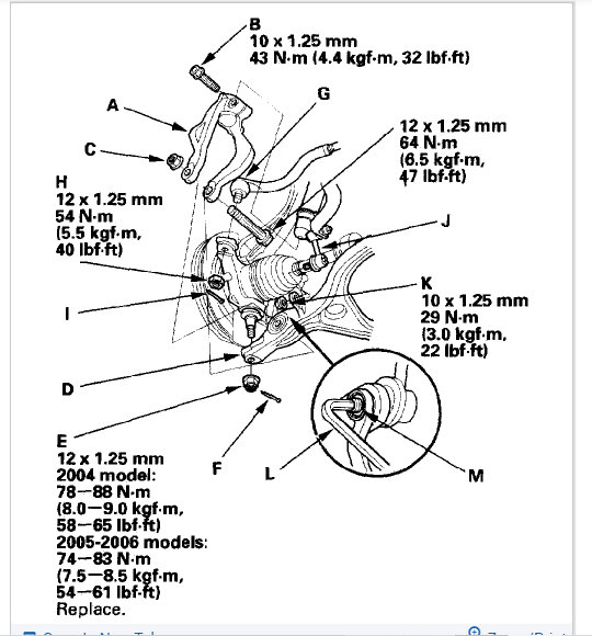

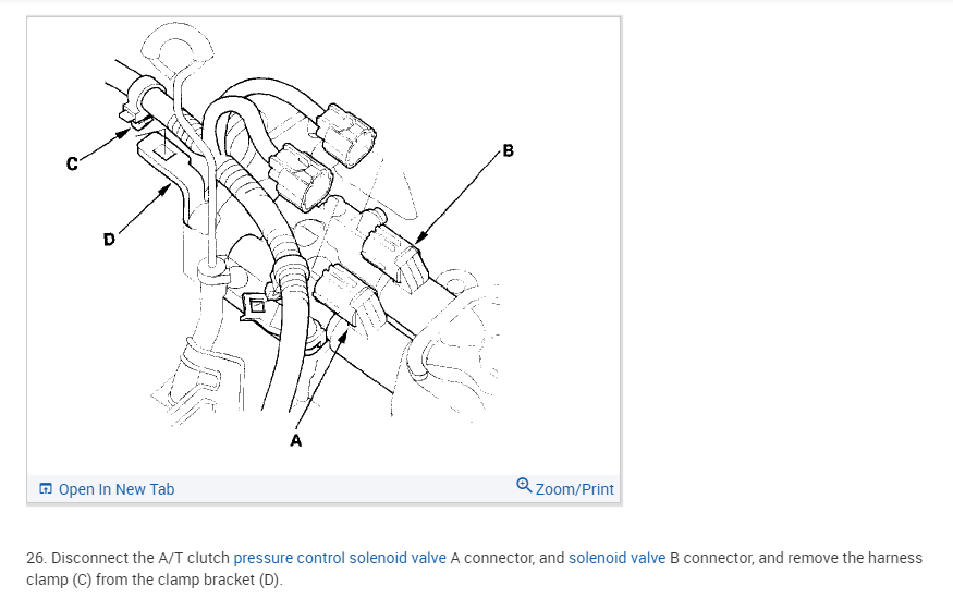

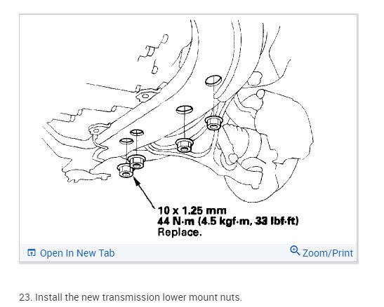

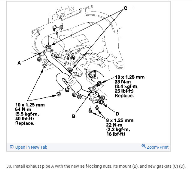

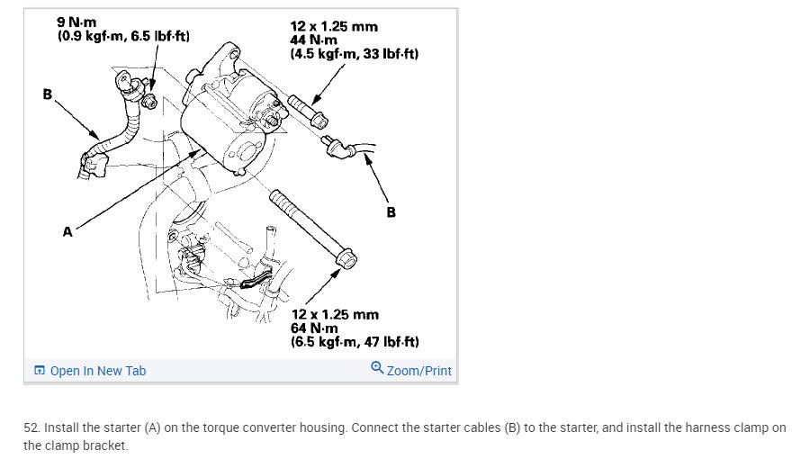

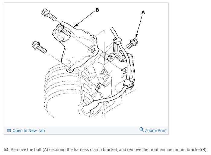

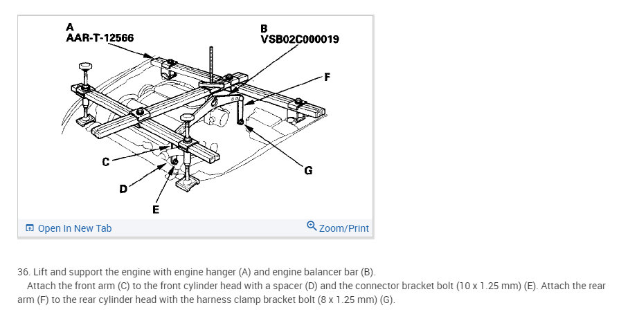

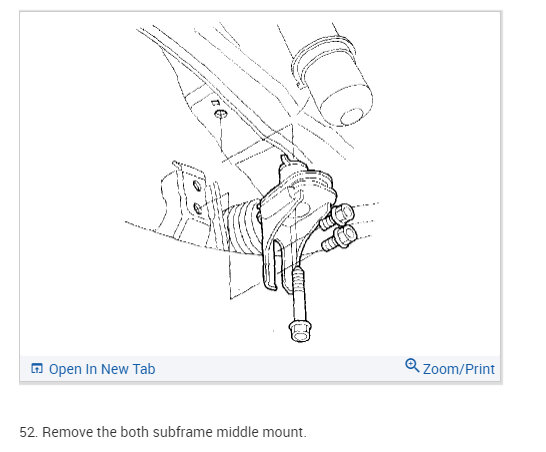

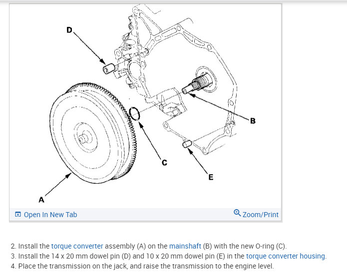

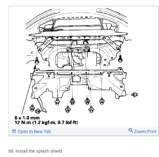

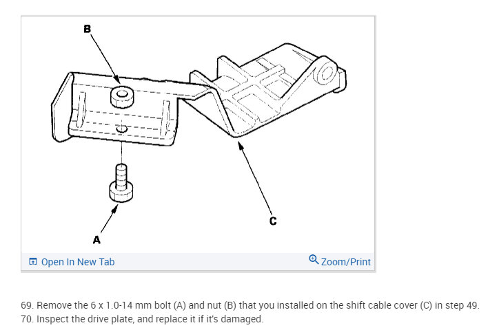

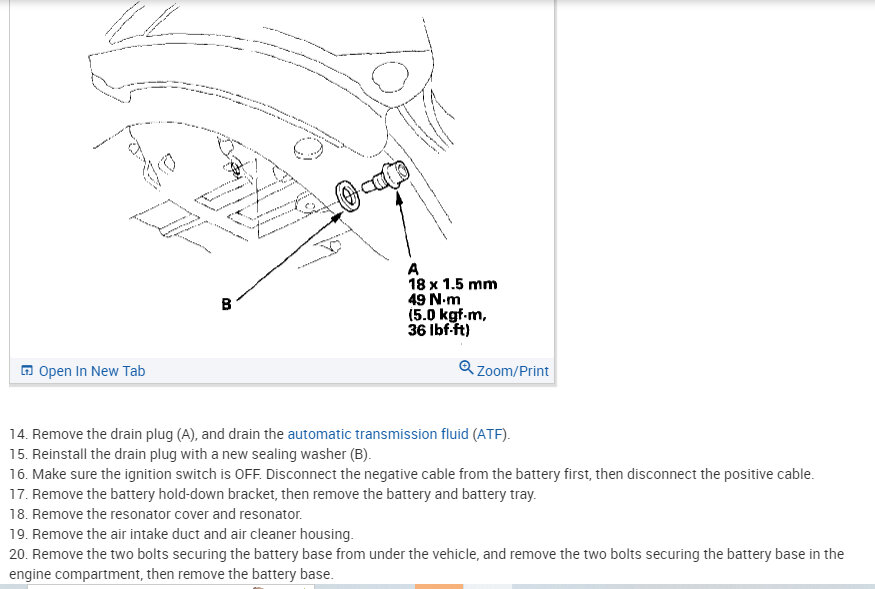

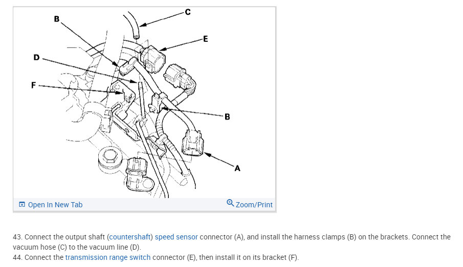

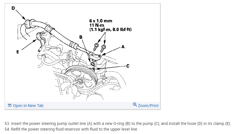

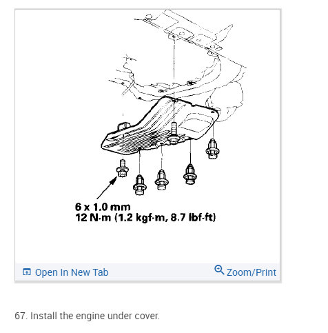

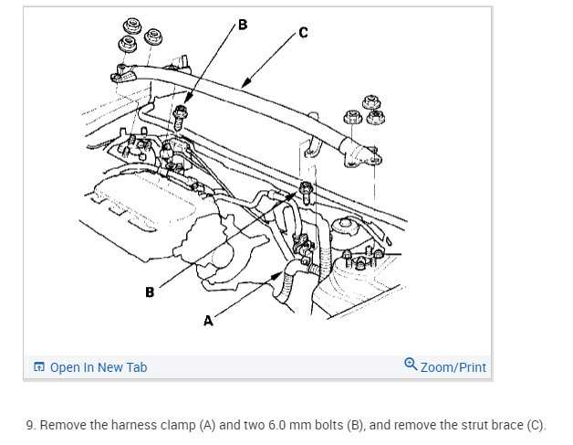

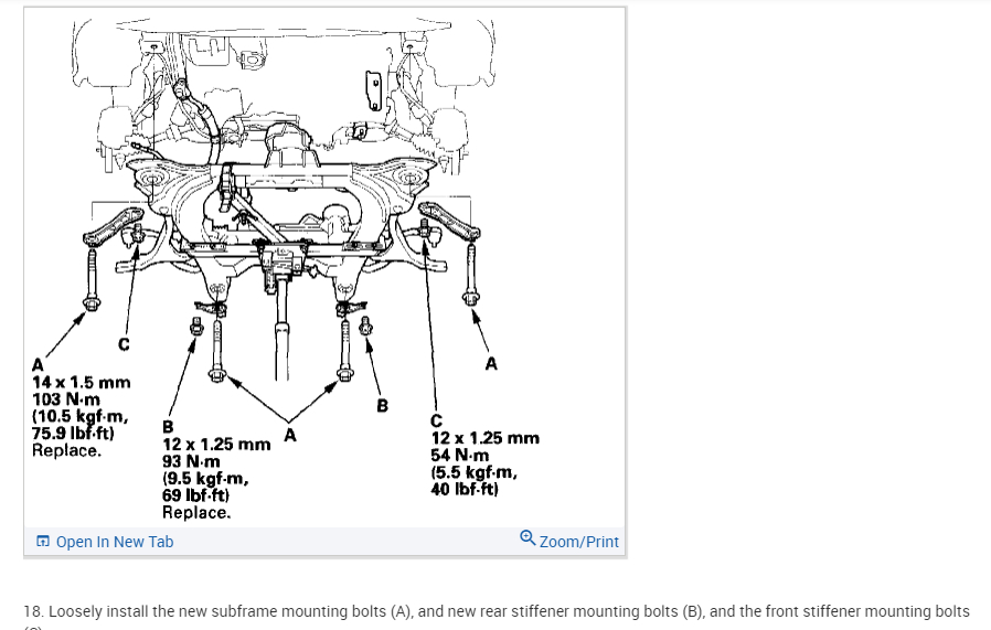

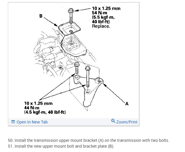

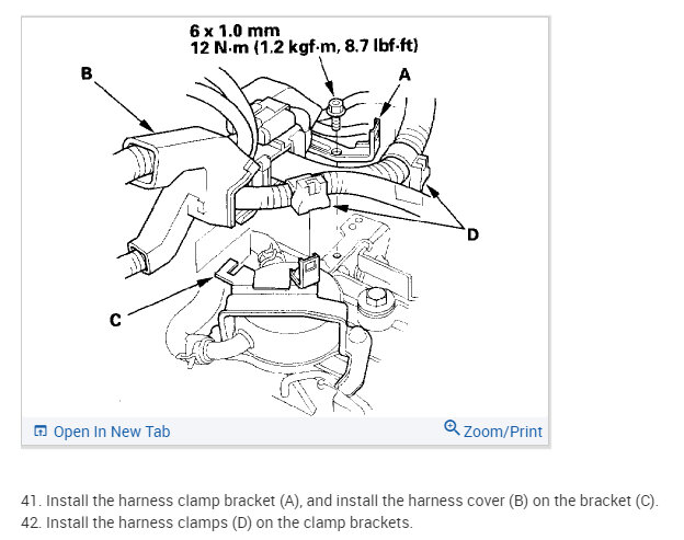

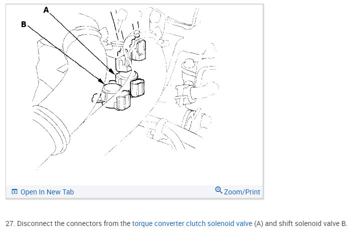

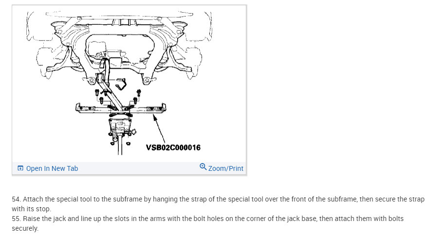

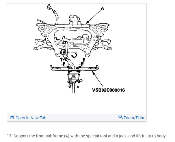

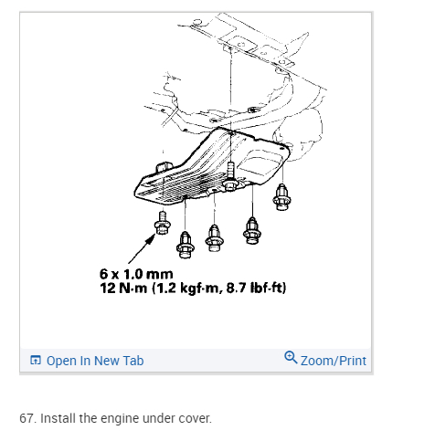

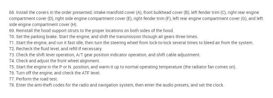

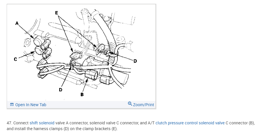

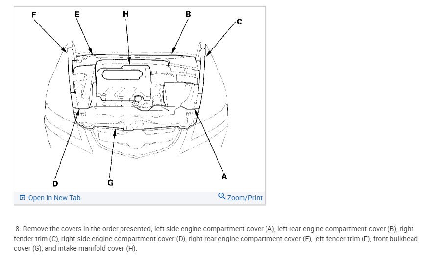

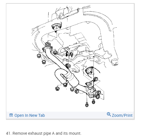

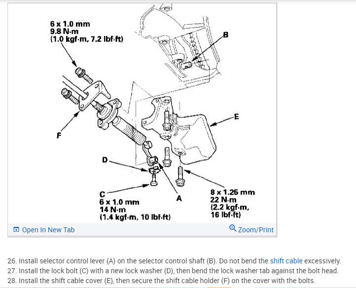

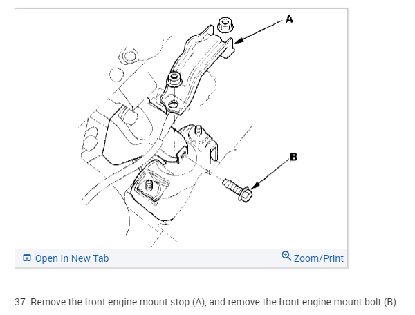

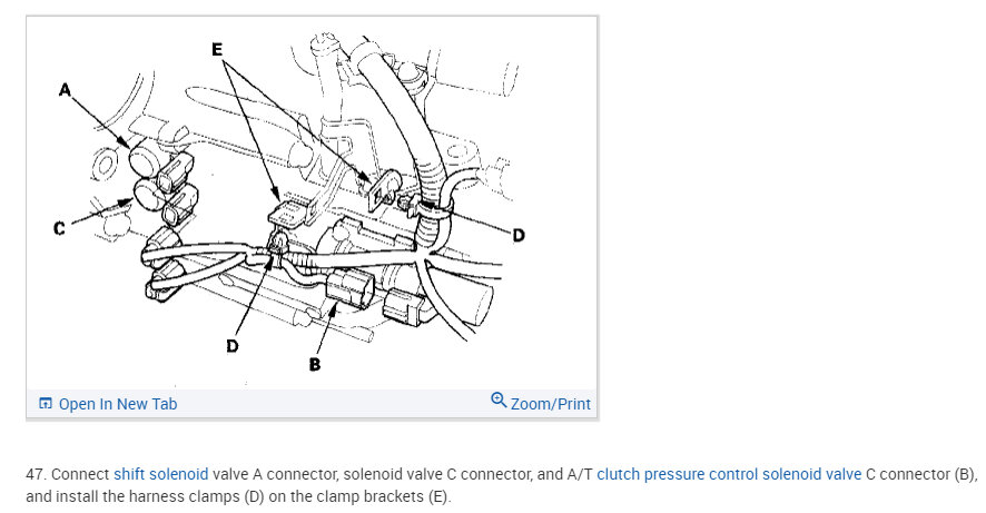

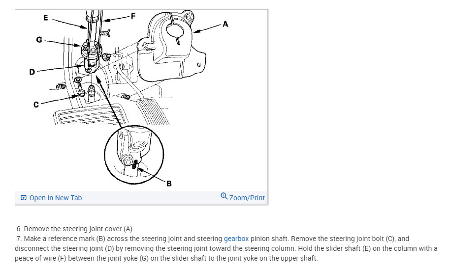

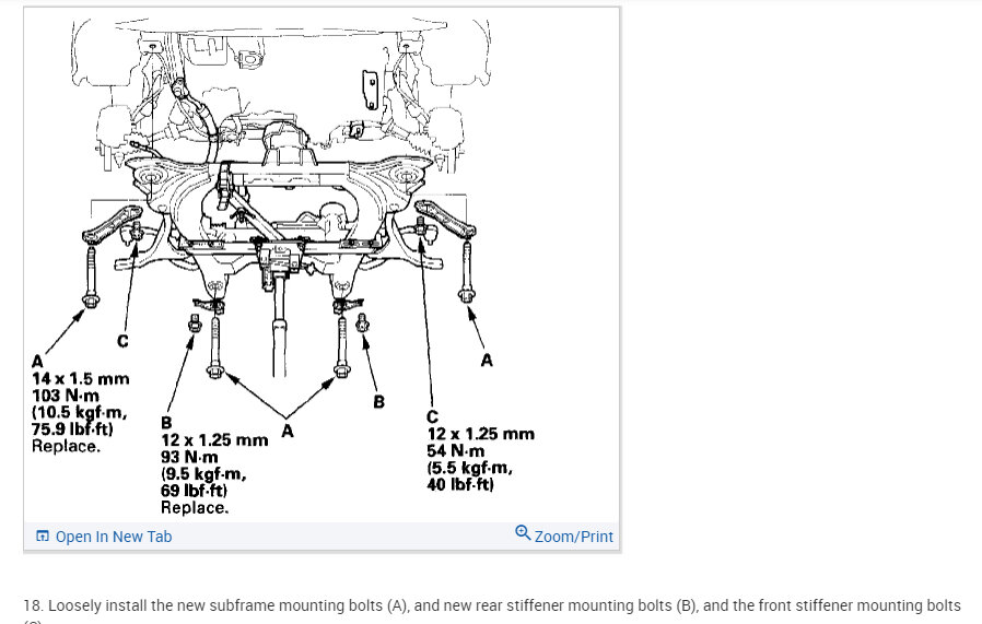

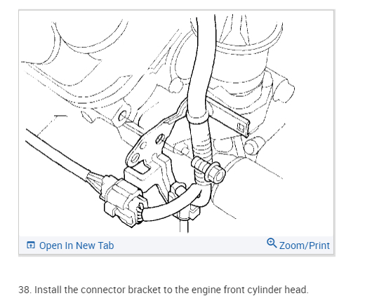

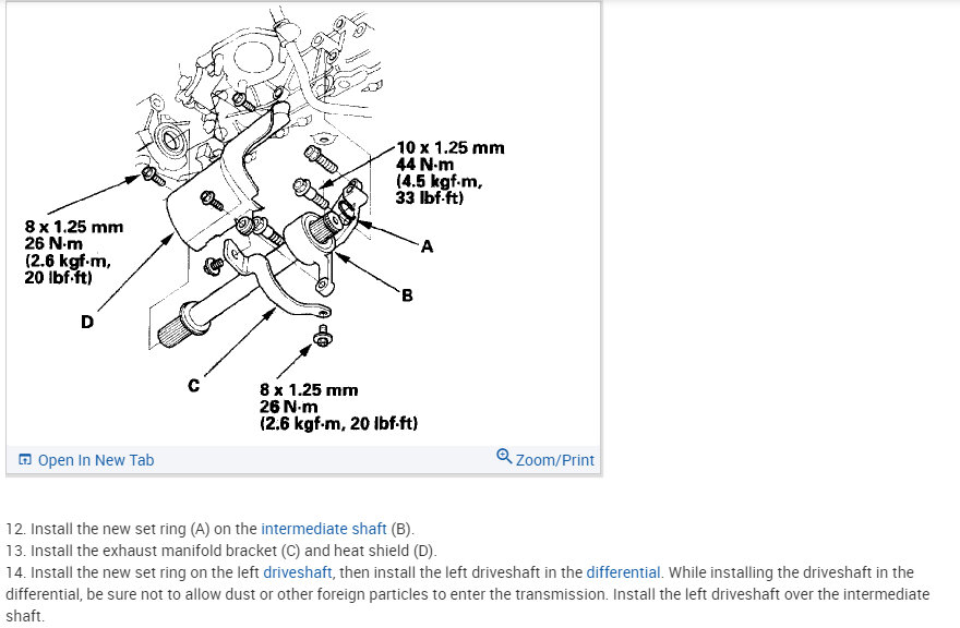

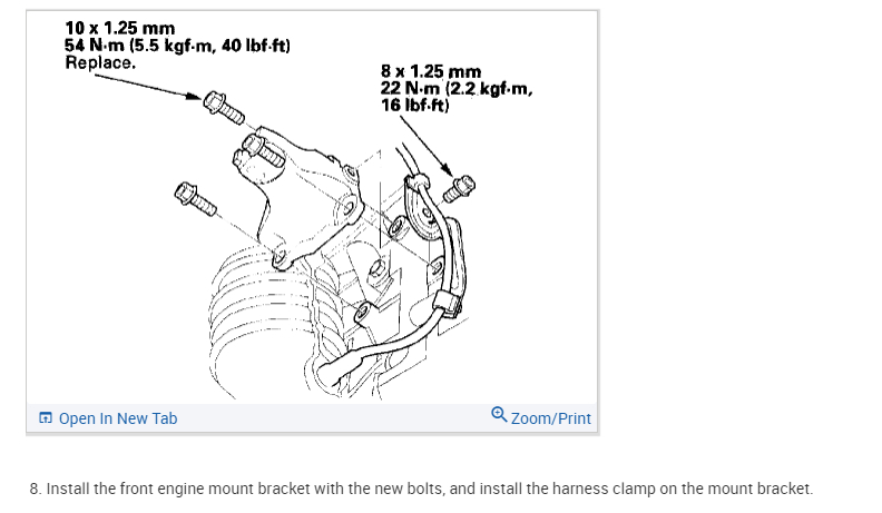

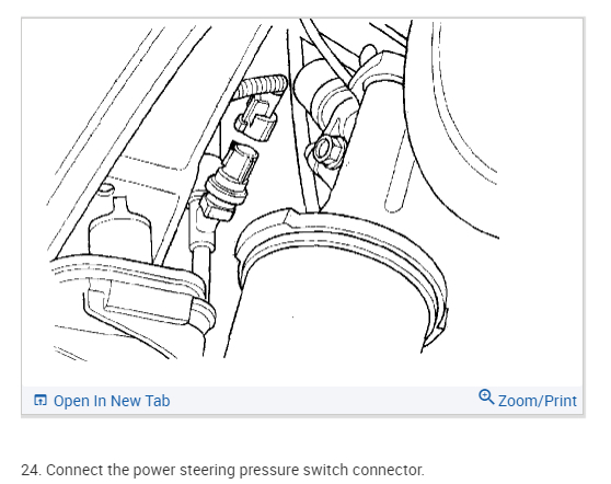

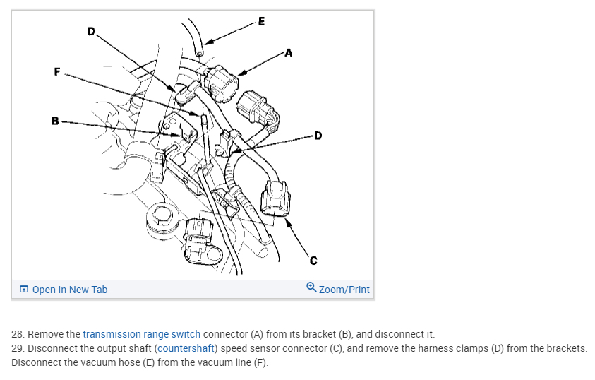

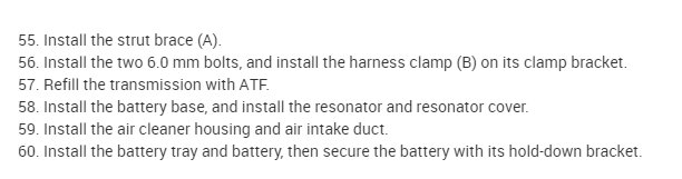

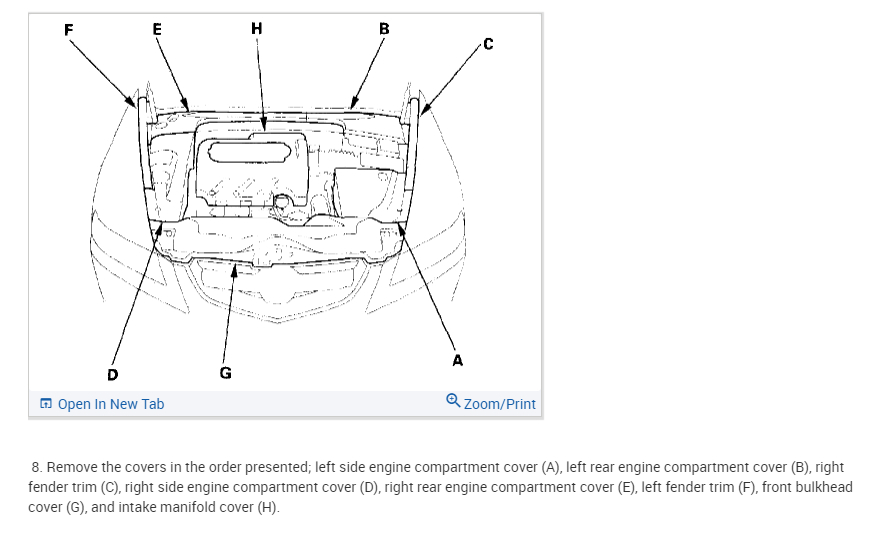

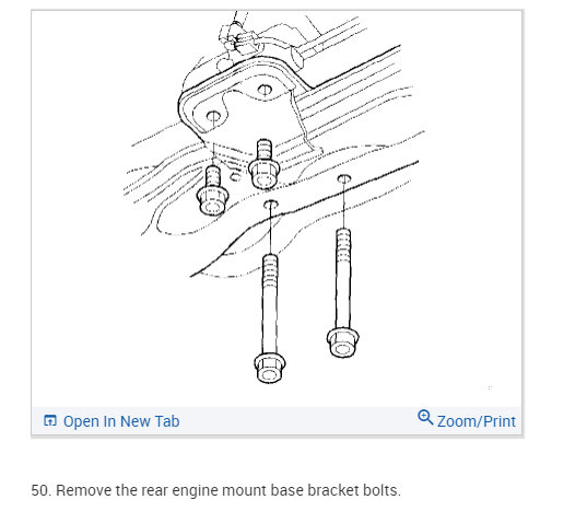

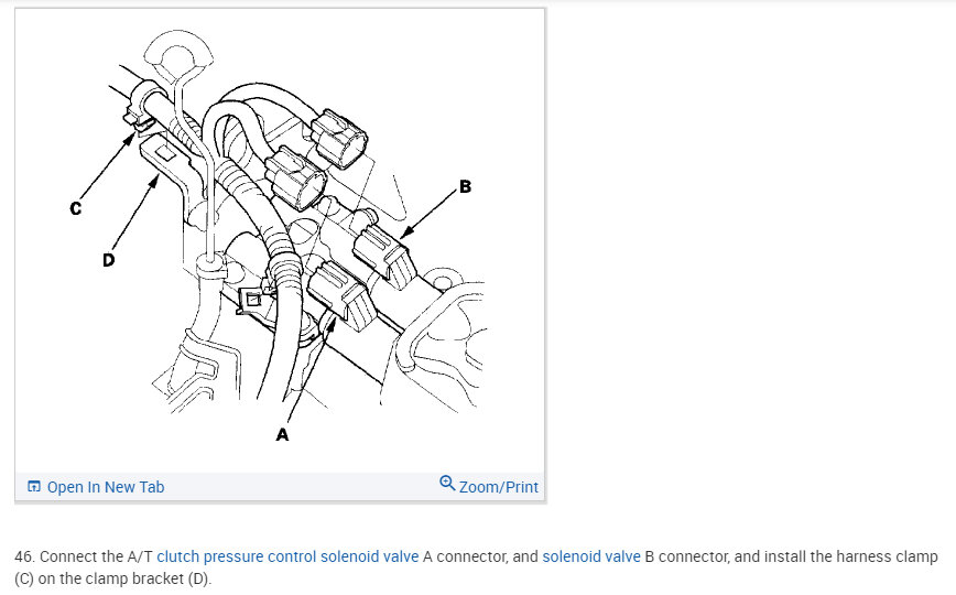

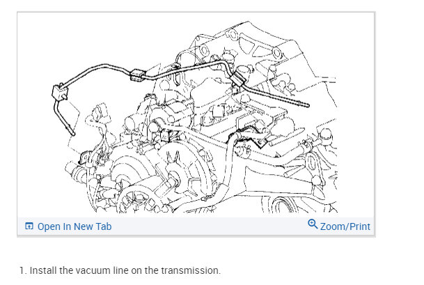

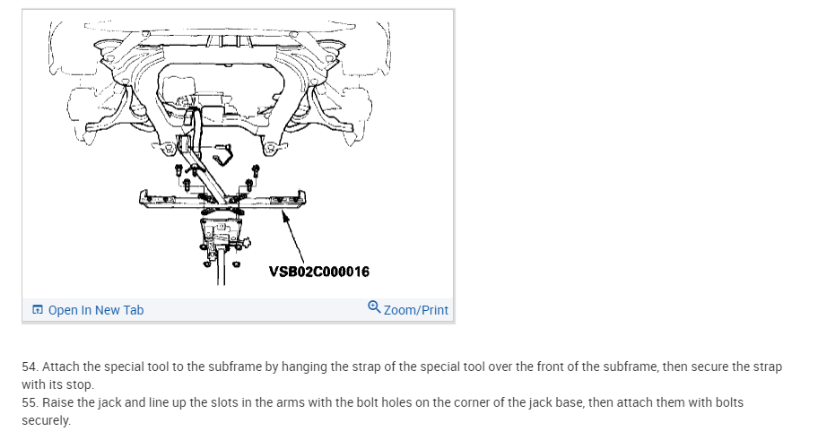

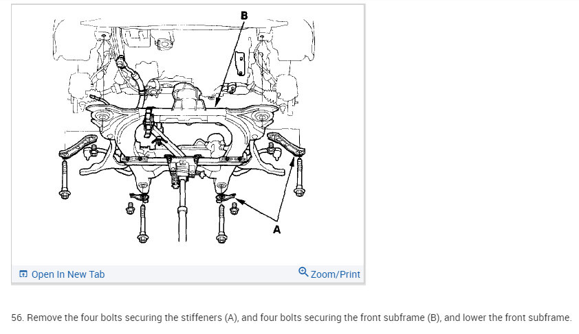

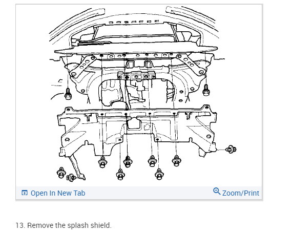

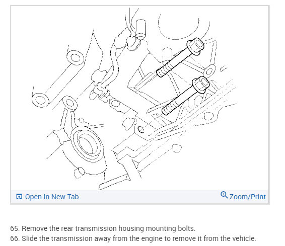

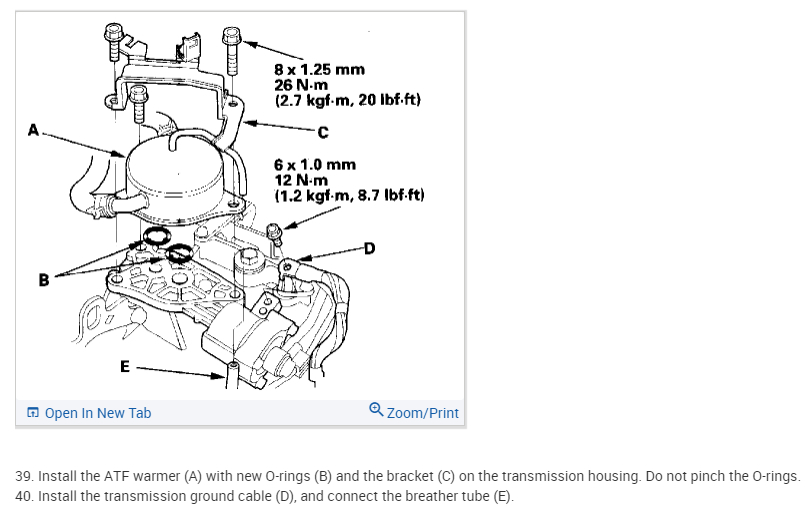

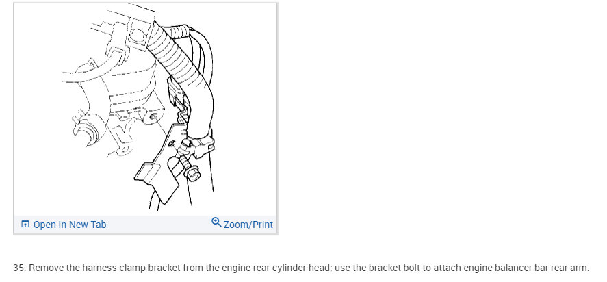

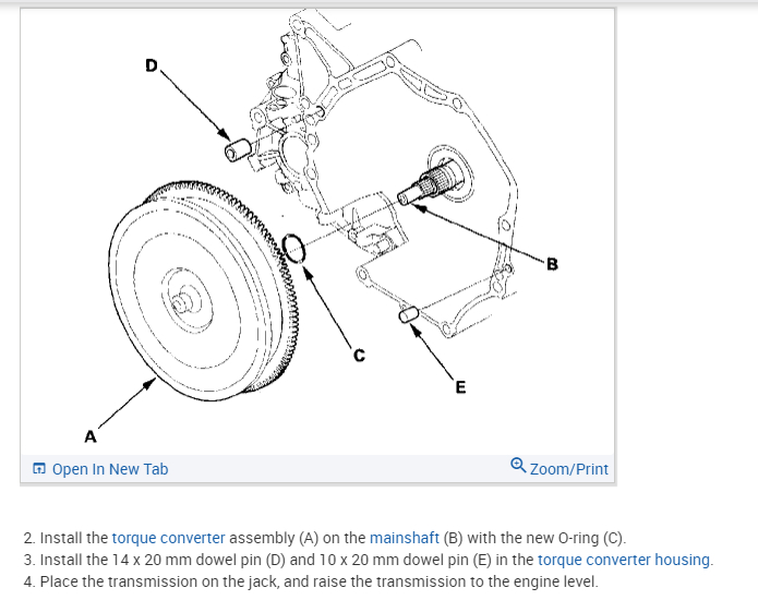

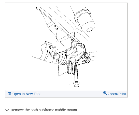

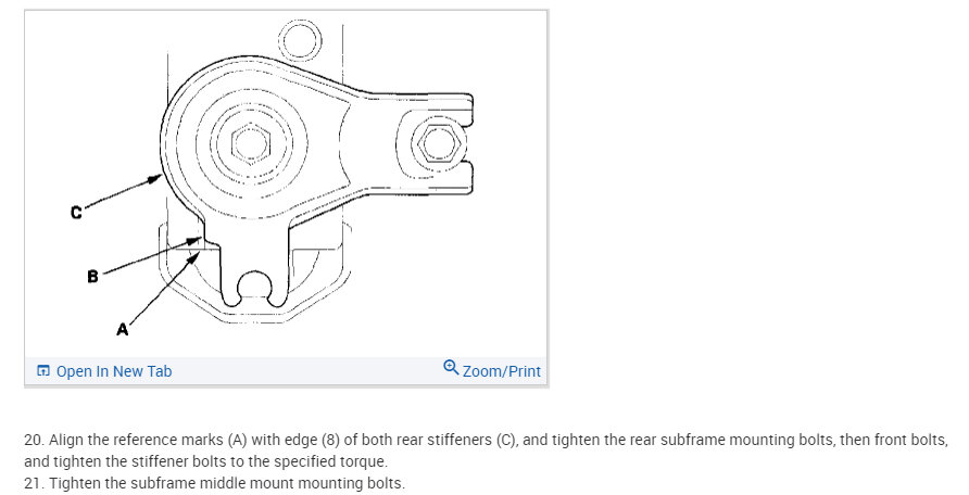

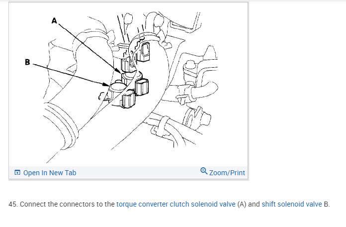

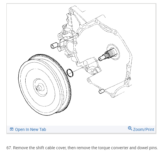

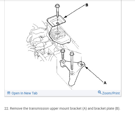

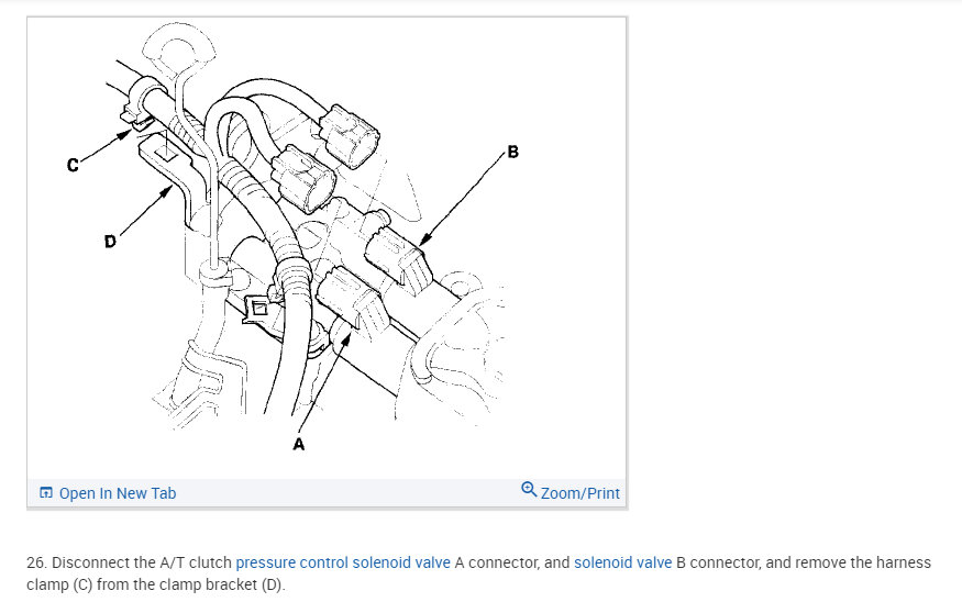

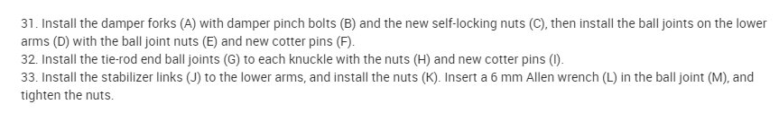

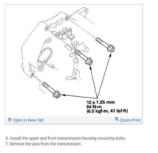

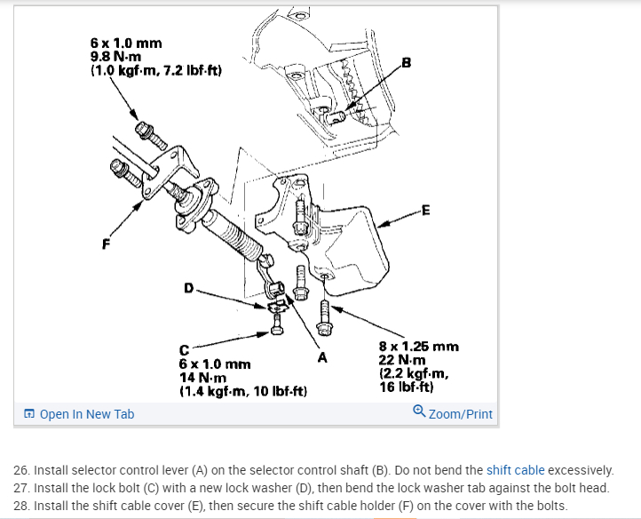

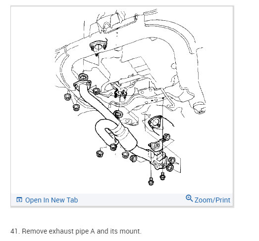

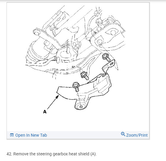

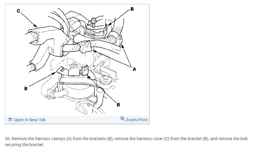

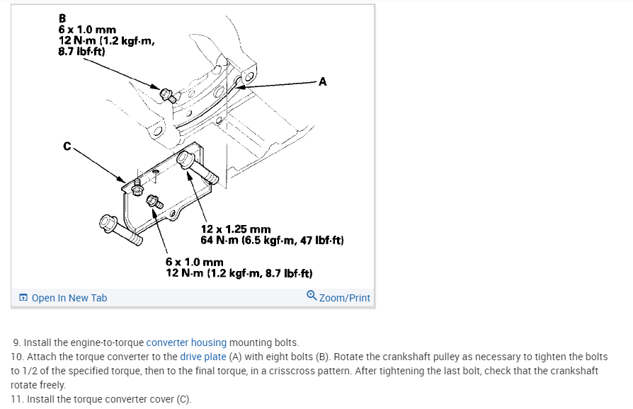

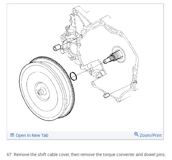

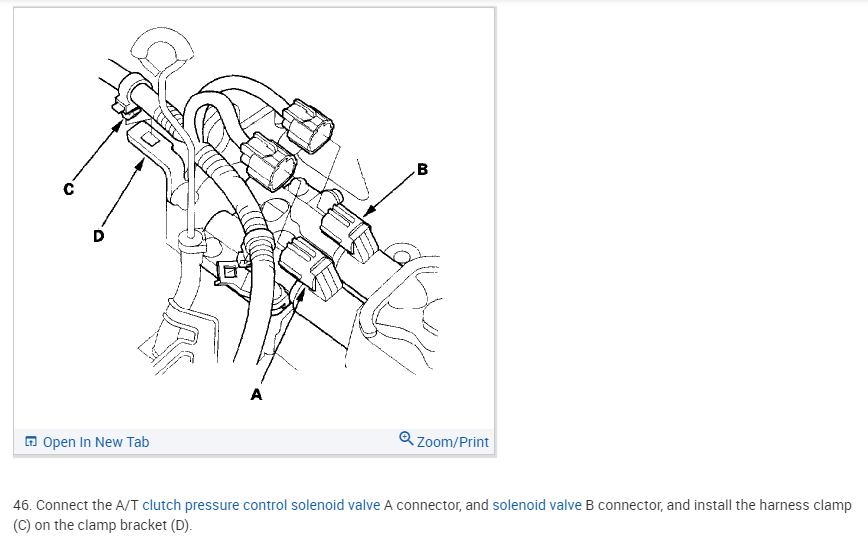

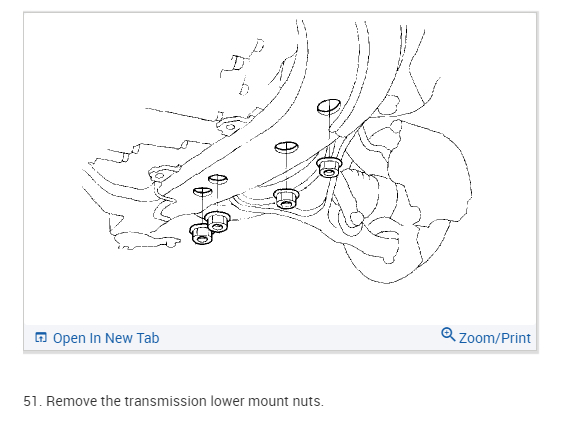

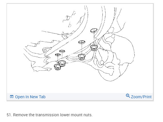

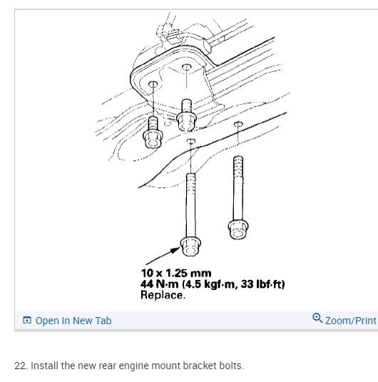

No problem whatsoever. I attached everything below for the removal and installation. Please don't be overwhelmed when looking at the directions. Most of the work is removing things so that the transmission can be removed.

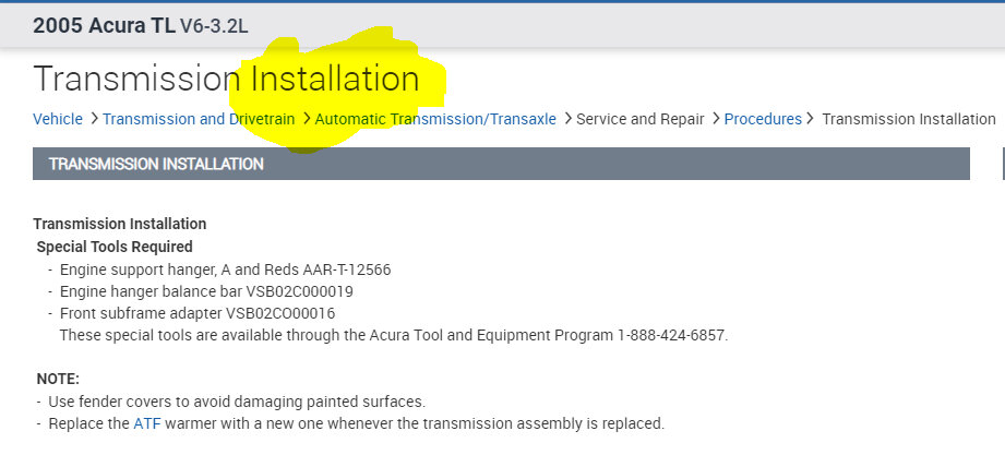

I would like to make a suggestion. You must have an engine support to do this job. Don't try doing it without. Also, there are so many bolts that you will be removing, it is easy to lose or mix them up. When I deal with this issue, I always get a box of ziplock bags and a marker. I place the bolts into individual bags and mark where they came from. It really makes it easier when you are ready to put things together.
I hope this helps.
Take care and Happy Easter. Let me know if you run into trouble. I'll try my best to help from here.
See pics below.
