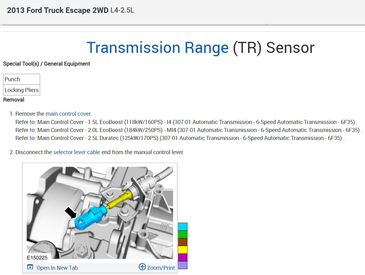

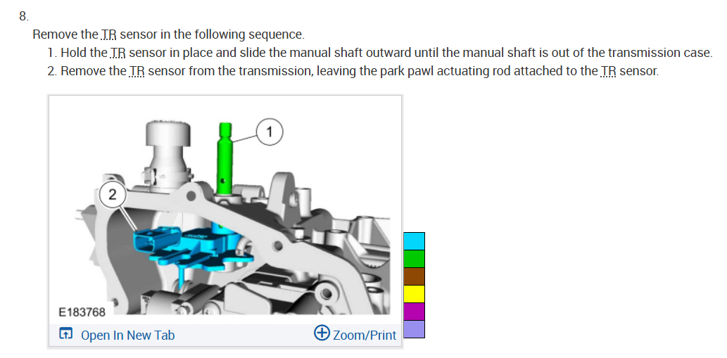

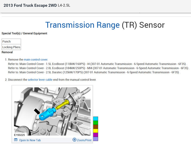

Yes, can I ask if the other gears show up in on the dash when selected? If not, I have seen the gear range sensor go out and cause this issue, here are the locations so and can swap it out. Also, we should run the codes to see if any are stored.
If you can please upload a short video of the problem so I can see which can help as well. Check out the images (below). Please let us know what happens.
