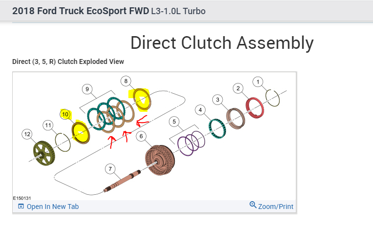

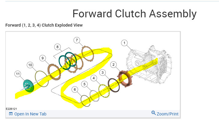

For some reason, the Ecosport doesn't show up in my manuals until 2018, but I will try my best to help.
The first question that came to mind was this. What clutch are they talking about? On an automatic transmission, there are no exposed clutches. They are internal and can't rust.
I attached a couple of pics below. In pic 1, I highlighted and have red arrows pointing to the clutches of the direct clutch assembly. In pic 2, which is the forward clutch assembly, you can see it is internal.
I have never heard of an automatic transmission having external clutches. Are the people that spoke with trustworthy?
