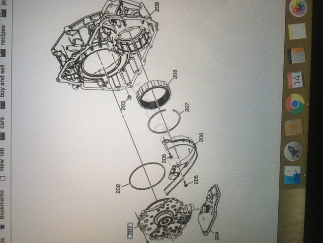

I found a tranny breakdown diagram 0n 7zap.com and found a part in the tranny that could be the culprit. Number 206 in the diagram. It’s called a baffle, part number 24246165.
Number 204 is the tranny filter. No access to it.
Anyhow, I will jack up both wheel and put it in drive this evening and get some audio with a stethoscope on the tranny.

Okay. If it is FWD then yes. Something most likely inside the differential is what I would suspect. Thanks
