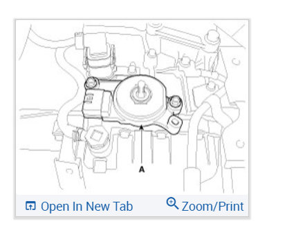

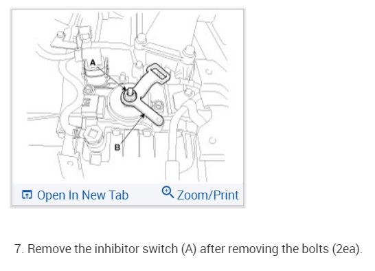

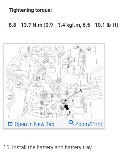

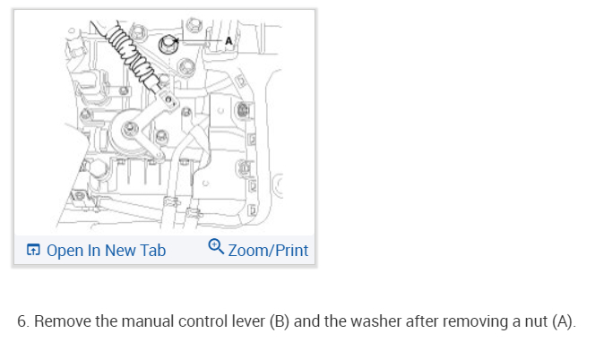

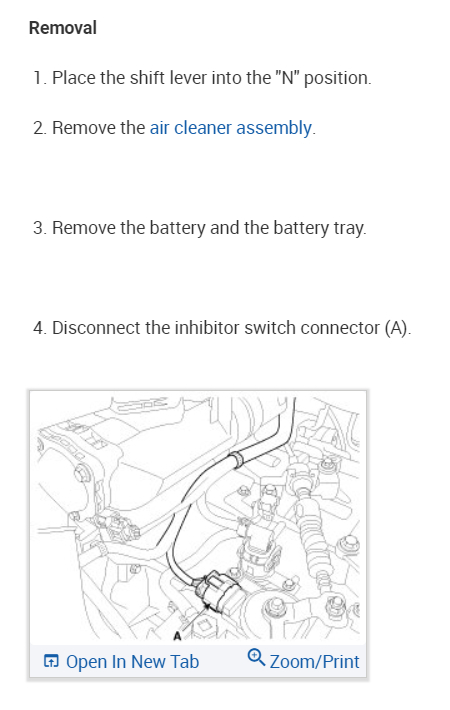

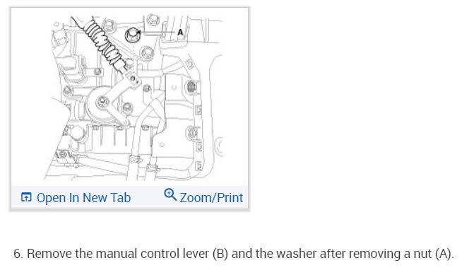

Yes, the sensor can cause the transmission to malfunction. You must start be removing the battery and tray. Here and diagrams and instructions on how to change the gear range sensor out for a new one. This guide will walk you through the replacement as well:
