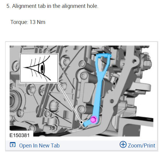

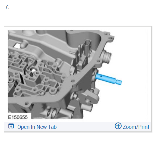

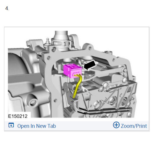

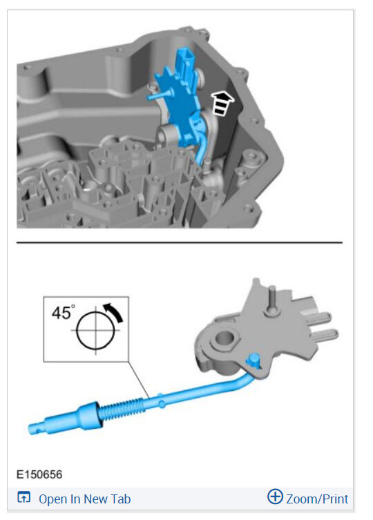

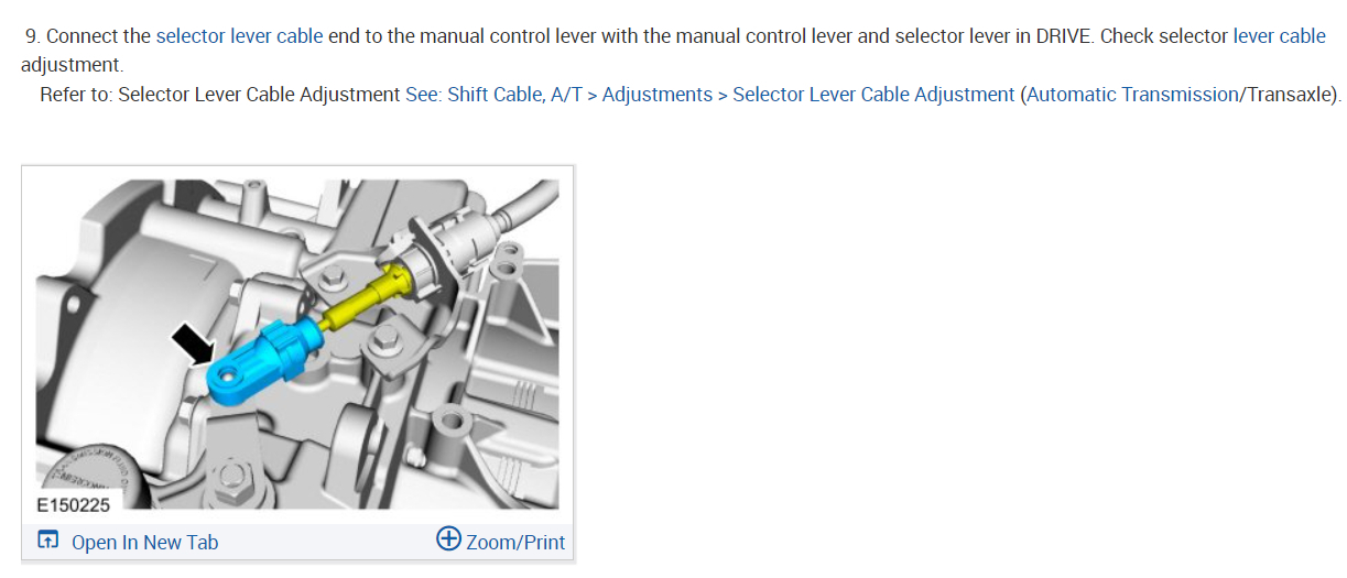

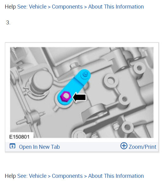

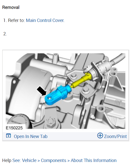

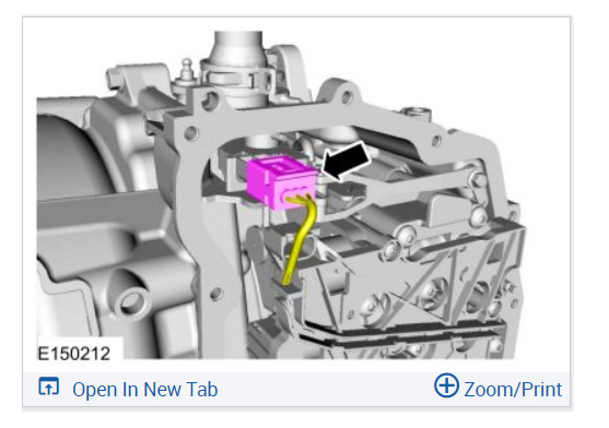

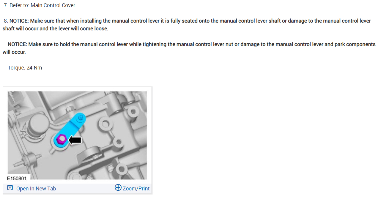

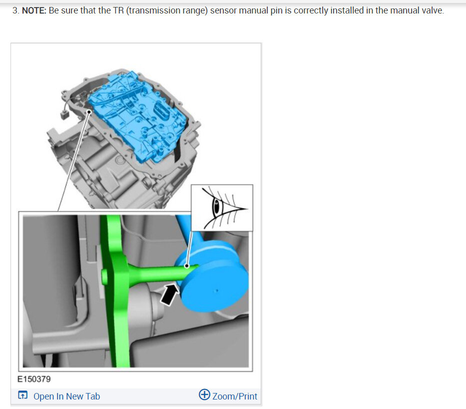

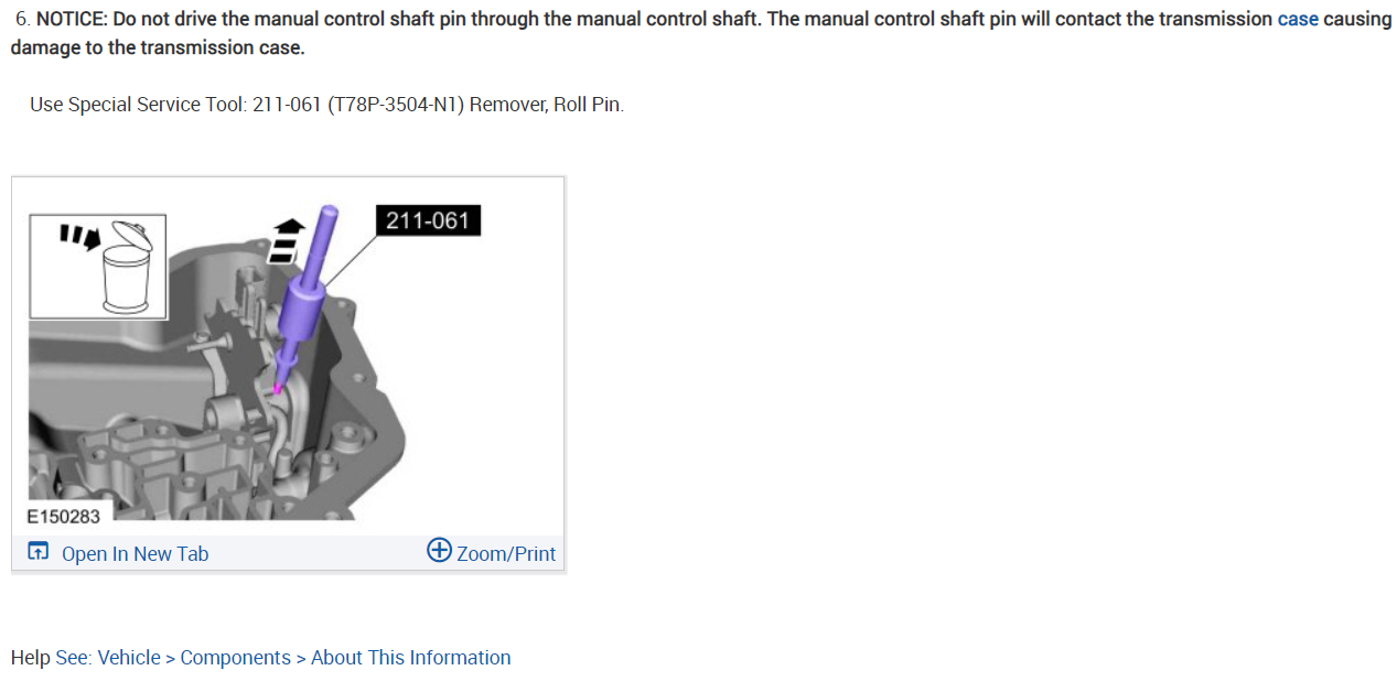

Yep, it sounds like the transmission range sensor is bad or not installed correctly.
P0707 - Transmission Range Sensor "A" Circuit Low
P0706 - Transmission Range Sensor "A" Circuit Range/Performance

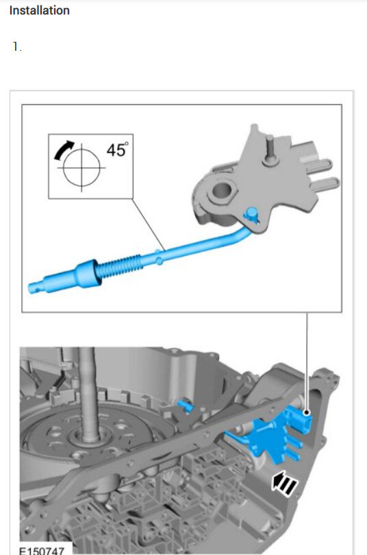

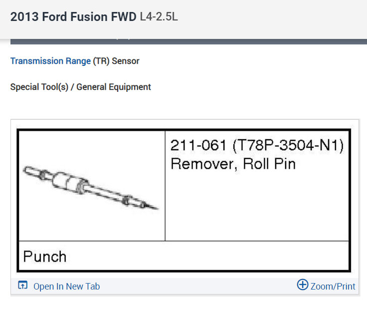

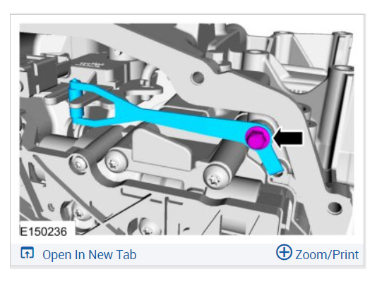

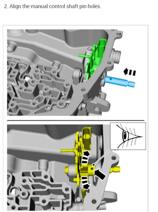

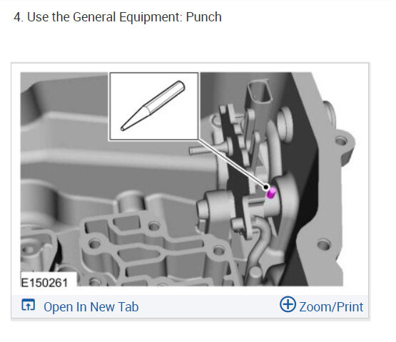

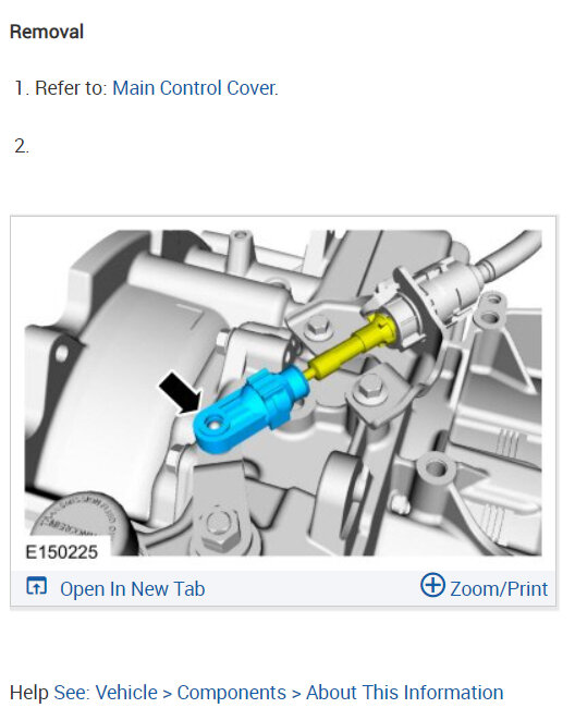

Here is how to replace the sensor correctly. Check out the images (below). Please upload pictures or videos in your response to the problem so we can see what's going on.
