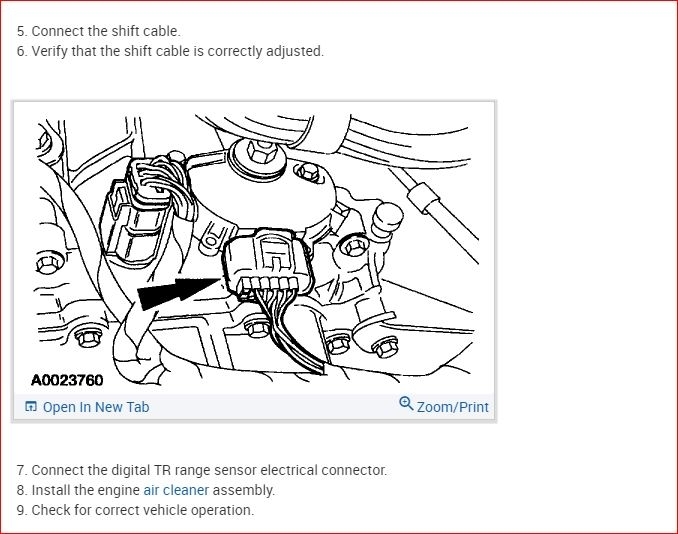

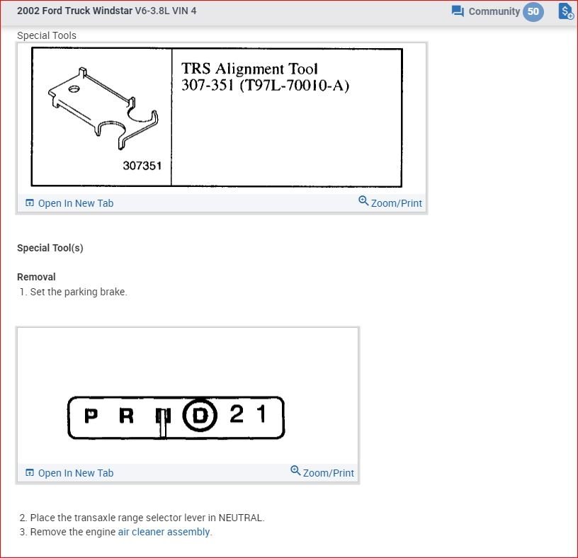

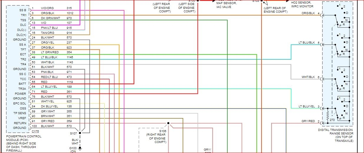

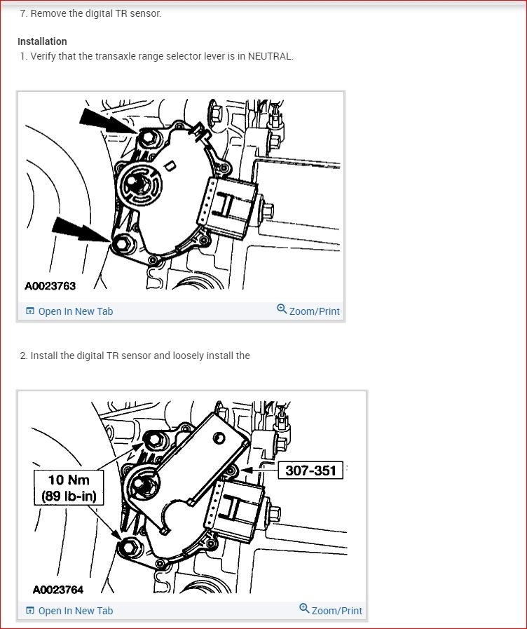

What is it? tried looking it up at parts store it comes up speed sensor. is that the same thing? and where is it located?
Jun 14, 2019 at 10:36 AM
Hi Jacsbratt,

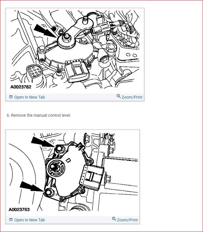

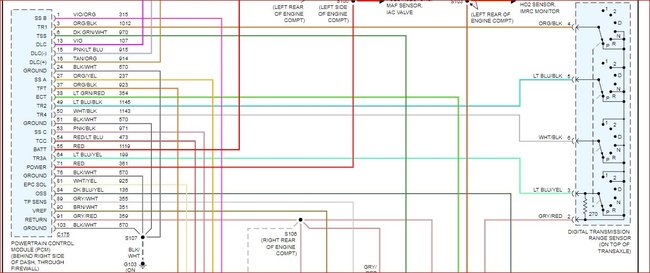

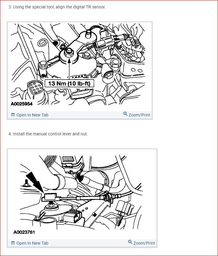

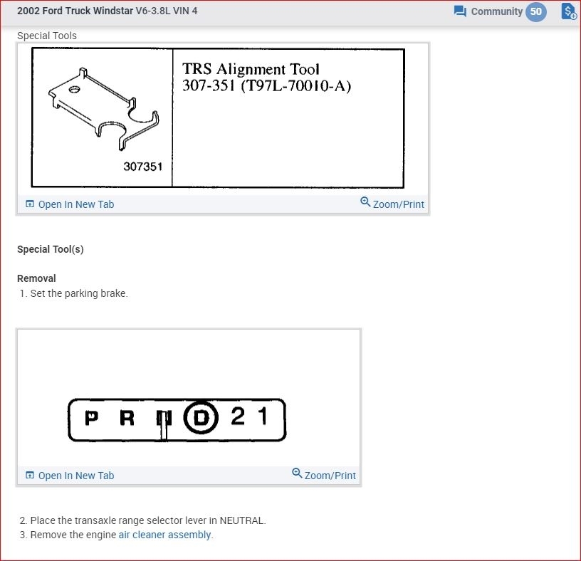

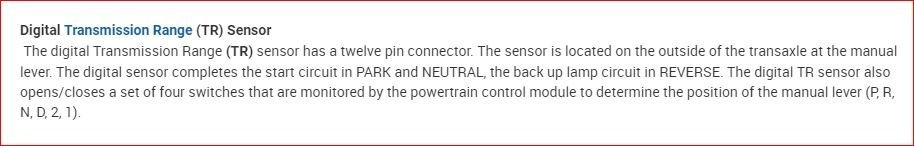

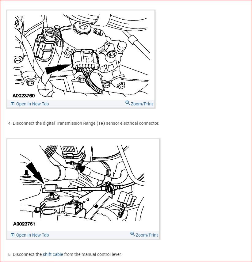

The range sensor is not the same as the speed sensor. The TRS is a switch that tells the PCM which gear the transmission is in (P,R,N,D).
It is located on top of the transmission where the gear selector connects to the transmission.
I included all the needed documents. Let me know if you need anything else. Thanks.
