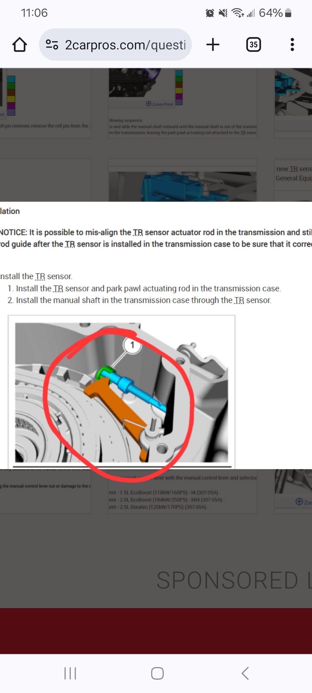

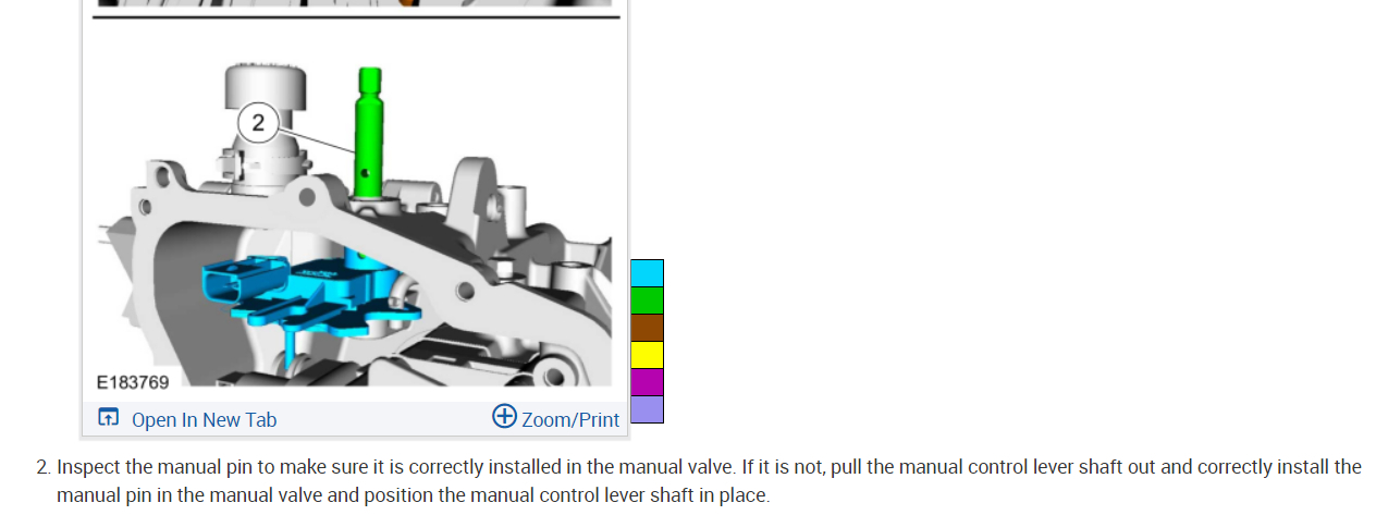

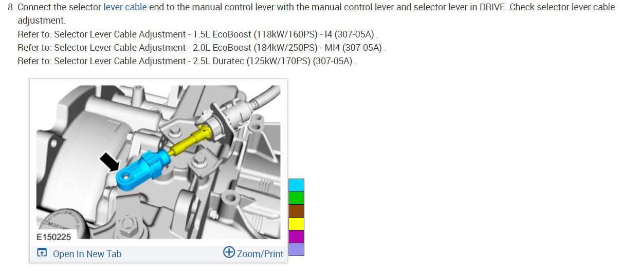

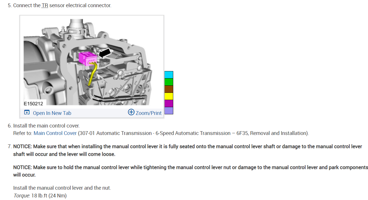

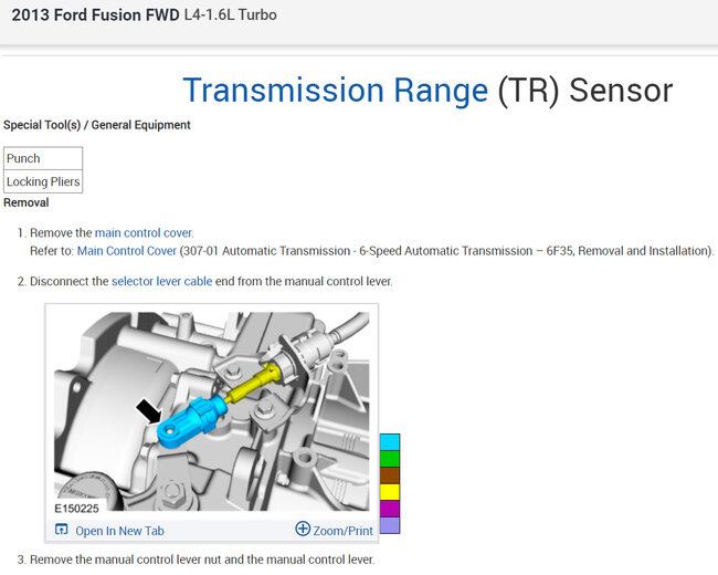

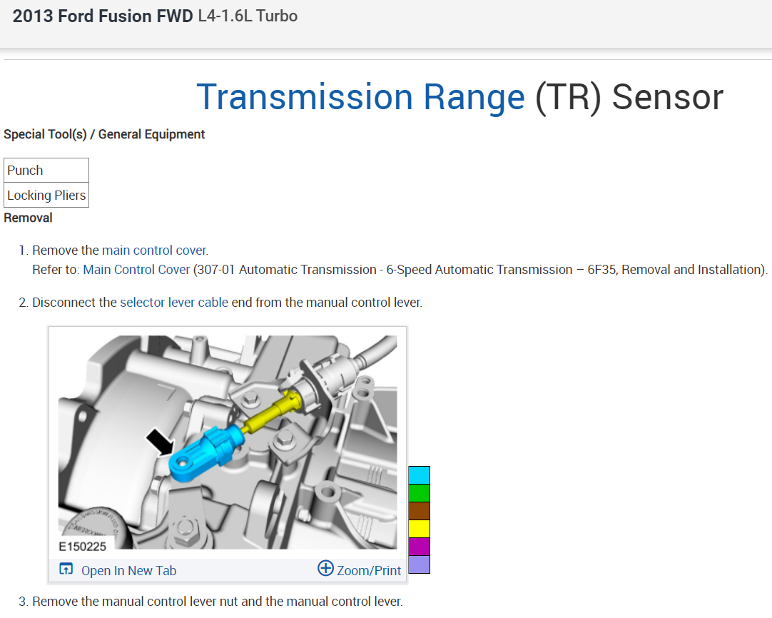

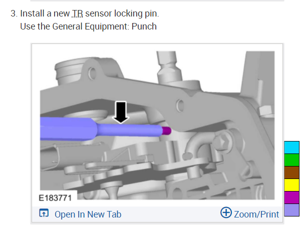

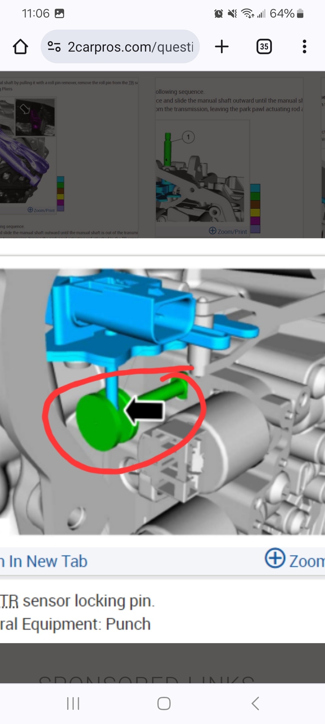

I was able to take it out, but putting it back in is an issue, the rod with the spring is not letting me get it all the way to the back and I can't reach to do some leverage, is there a picture or video to get how exactly it should look? I might be having something where is not supposed to be.
