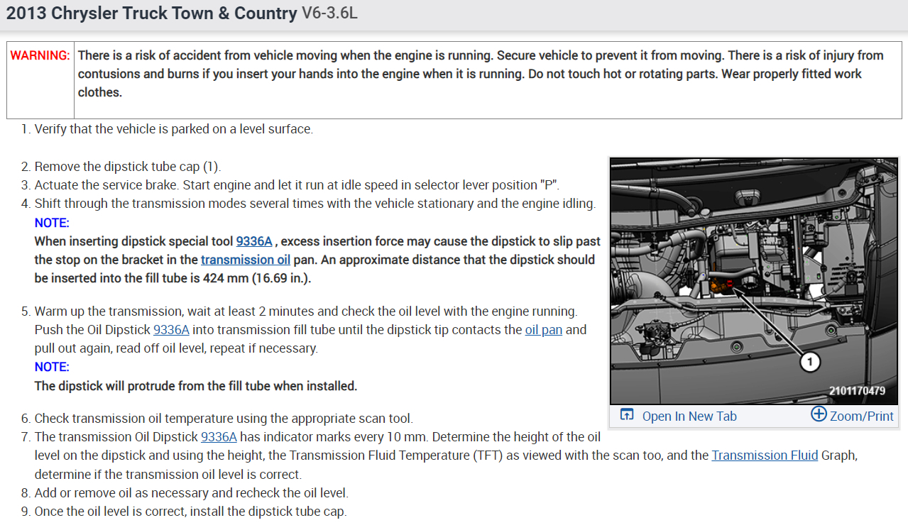

The first thing I would do is check the transmission fluid level.
Here is a guide to help with instructions for you can in the images below:
https://www.2carpros.com/articles/how-to-check-and-add-transmission-fluid

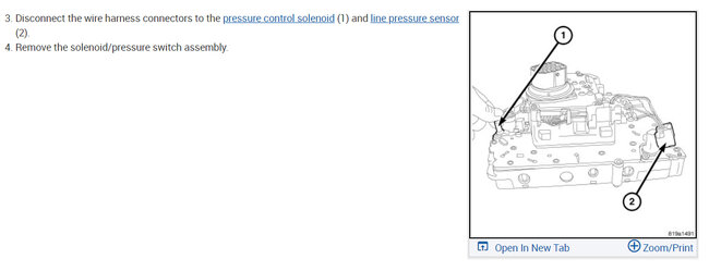

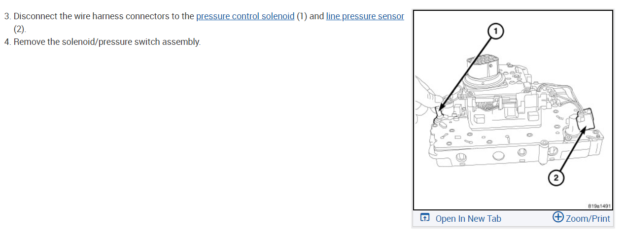

P0846: This code indicates a problem with the transmission fluid pressure sensor/switch 'B' circuit.
P0868: This code signifies low transmission fluid pressure.
P0733: This code is related to the 3rd gear ratio.
P083B: This code is associated with the transmission fluid pressure sensor/switch 'G' circuit.
P0842: This code indicates a problem with the transmission fluid pressure sensor/switch 'A' circuit low.
You may have an internal transmission problem, which is what the noise is trying to tell us. Check out the images (below). Please let us know what happens.

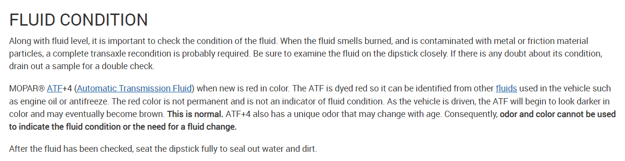

Sorry it was not code p0842 it was code p0882. i don't have the dip stick, i used a video of using oil dipstick and marking the 16.7in where it bottoms out and than measure how many mm it is from bottom of oil dipstick, my only problem is my scan tool does freeze frame DTC and ABS but no transmission temperature just intake manifold temperature, engine and coolant pretty much. When i check this method cold not started over night i get 95mm on dipstick, when started and shifted through all gears up and down 3 or 4 times 10 seconds per gear, idling for 2-5 minutes i get a reading of about 45mm , fluid on dipstick smells sweet/normal a little darkish, no flakes that i can see when smeared between fingers, i see no leaks under van either. May try to drop pan and do filter change, if fluid looks good no metal or anything, should i reuse the fluid and just replace filter or replace fluid as well? I know a lot of people recommend not replacing fluid if it's never been changed, i bought the van at 100k-110k miles through dealership last owner was a realtor, don't know if they ever flushed the transmission and changed filter before or not. When i get a chance i'll send a video of whirring noise that sounds like a humm-whirr-blender noise.
Jan 3, 2024 at 11:57 AM
Yep, please do, if the transmission is making noise, you have nothing to lose by changing the fluid and filter.

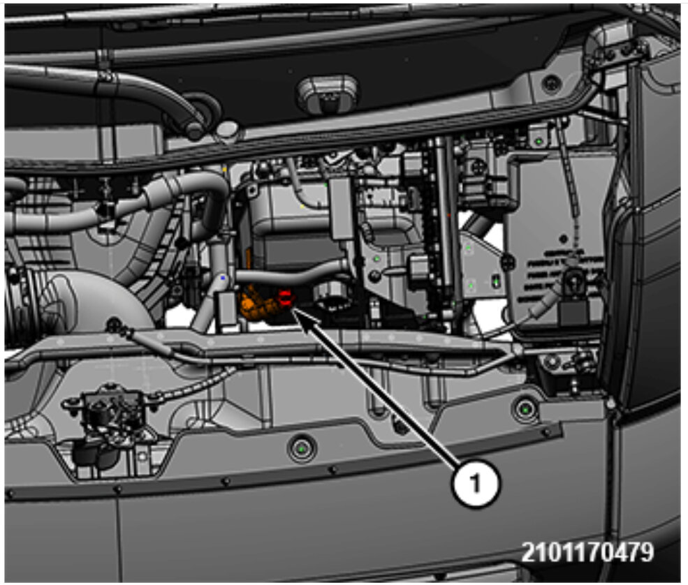

The P0882 error code in a 2013 Chrysler Town and Country typically indicates a problem with the Transmission Control Module (TCM) power input signal.
So, there could be a problem with the TCM which is common, I would remove the electrical connector and check for corrosion which can happen because of the TCM placement in the vehicle. Here is the location so you can check it out. Check out the images (below). Let us know how it goes.
