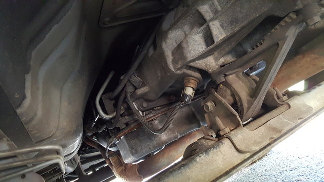

What is the sensor on the drives side just behind the transmission pan at the sticker for the transmission? Is it just a regular speed sensor or the output speed sensor? Going to try to add a picture below.
Apr 4, 2017 at 9:52 AM
MICHELE KENNEDY
  • 7 POSTS
This one
Apr 4, 2017 at 9:54 AM
DOCFIXIT
  • 18,828 POSTS
That would be the output speed sensor.
Apr 4, 2017 at 10:58 AM
MICHELE KENNEDY
  • 7 POSTS
Okay thanks. The wires were bare and touching. But the end that goes into the sensor looks burnt so I am thinking I should replace the sensor too.
Apr 4, 2017 at 11:38 AM
Yes you should.
Please let us know what you find so it will help others.
