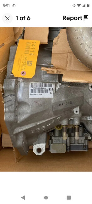

Now, I could use some info access so I can make this decision about a rebuilt (remanufactured) transmission. To make it short a guy offered to buy both transmissions once I get the current one out and replaced. He rebuilds transmissions. What I need to know is this Mopar Remanufactured Transmission w/ Torque Converter ( 65102918AB ) compatible to the car. Not one so called Mopar Parts site online can or won't tell me if it is. I attached photos of the door tag and VIN of this car. From the photos of the transmission I can see it looks a lot like these 2 but missing the firewall side of the transmission where I couldn't see the TRS/NSS to see the pins. If you can tell me if it's what's needed, then I'll have an easier time deciding on getting it and selling the 2 transmissions.Thanks

I know this is a 41TE and the same as my old Grand Caravan. The about that Transmission Package 65102918AB I'm looking at is nowhere does it list the transmission (41TE) nor the part number of the included torque converter. I could see from the package photos that it has the same setup as these transmissions including the shift solenoid pack installed, the speed sensors, and the same location of the NSS/TRS connector. It looks like a 41TE but I need it confirmed. That number 65102918AB isn't the transaxle number but the entire package of transaxle and torque converter, a certified Mopar remanufactured unit. I'll call the dealership Monday and find out as I've had to do so many times for obsolete parts just for the numbers. I attached a photo of that package I'm looking at. Pretty certain it's a liquidation. And that part number on the bell housing (white label) doesn't show up on any transaxle oem list or remanufacture list Mopar put out that I downloaded. Have no idea what that part number is for.....

Part numbers can be confusing. Often you're better off just going by the application, not the numbers.
With the car radios I work on, a P4704383AD, for example, has had three minor revisions since the original P4704383AA came out. The last two letters mean there has been some revision, but it's too insignificant to warrant a different part number.
When there's a bigger change, it gets a new part number, but it might interchange perfectly with multiple other numbers. In one case, when an emissions problem is corrected by "reflashing" the Engine Computer with updated software, if it involved a recall, we have to place a new part number sticker over the old one. Instead, if the computer had a problem before the recall went into effect, and it went back to a repair center, it gets repaired first, then any updates are performed, then the latest software gets installed. That module will get a still different part number so the rebuilders know the module's history if they get it back again. There can be a dozen different part numbers, all for identical computers that will all work in that same application.
Your rebuilt transmission is going to have a different part number too. By '98, most of the mechanical updates were incorporated already, but for older models, those that go back to Chrysler to be rebuilt will get updated clutch drums with relocated sealing rings, and the clutch packs will be stuffed with as many clutch plates as they can fit in there to give it the higher rating to a "42TE", for example. The cost of those additional clutch plates is almost nothing, but now that transmission can be used in more applications.
I've also been told a rebuilt assembly can get different part numbers to denote which supplier or rebuilder did the job, but I don't know that for a fact.
You can even find the part number on the transmission is different from the number on the container it was shipped in, or the number on the invoice. Three transmissions with the same number could come as different packages, with different numbers on the boxes. One might come with an updated rubber mount. One might come with a set of special bolts. Yet another one might have been shipped without the solenoid pack, but they all work in the same applications.

Thought I'd let you know that transmission package came back as an AWD so I can't use it. The "PO" in front of the number was confusing things so I ran it the tag again without the "PO" and it came back for a 2002 3.8L Caravan AWD. Sadly, it won't work but I wish it had it was only $600 + freight.
