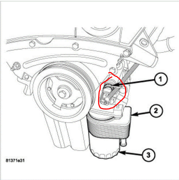

When you say the oil light is on, are you referring to the engine oil light? If so, check to make sure by accident you didn't disconnect the oil pressure switch when you were working.
See pic 1 for oil pressure switch location.
As far as the transmission leak, it could be coming from one of the cooling lines and you see it leaking on or near a control arm. However, I don't see how that could cause the traction control or ESP to fail. Chances are that issue is related to a bad wheel sensor.
