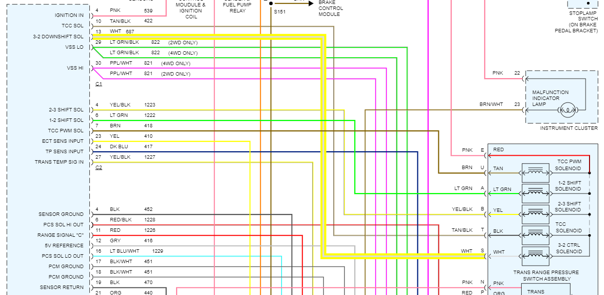

If there is a code for shift solenoid B (which is the 2-3) shift solenoid, it shouldn't be causing issues with downshifting. If you have the code that was found, let me know what it is so I can research it for you.
There is a 3-2 downshift solenoid in the transmission as well. That would make more sense to me. See pic below
See pic below.

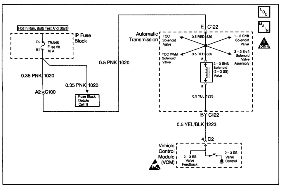

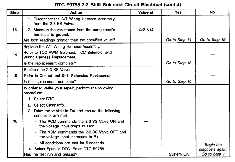

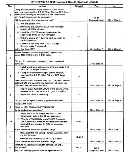

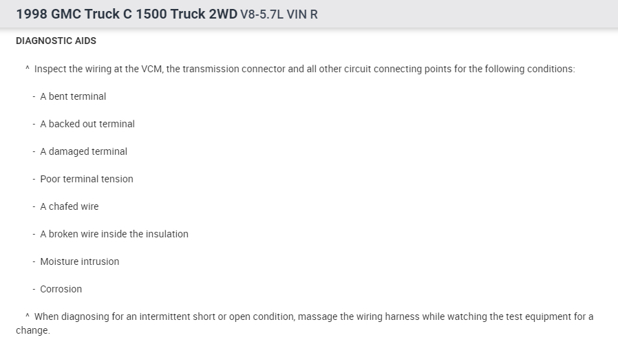

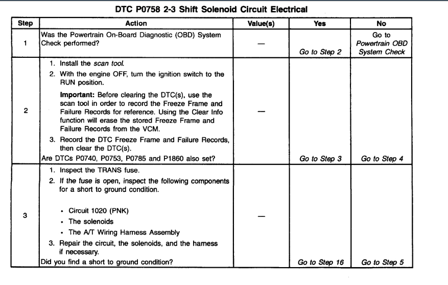

The solenoid could have been the issue, but the code is specific to a power issue. When the PCM detects a continuous open or short to ground in the 2-3 SS Valve circuit or the 2-3 SS Valve, then DTC P0758 sets.
I attached the diagnostics below. Since you already replaced the solenoid B, it is likely a wiring issue.
Here is my concern. The diagnostics require a scan tool that can communicate with the different modules. I don't know if you have one or have access to one.
Take care and hang in there. I wish I had an easier solution.

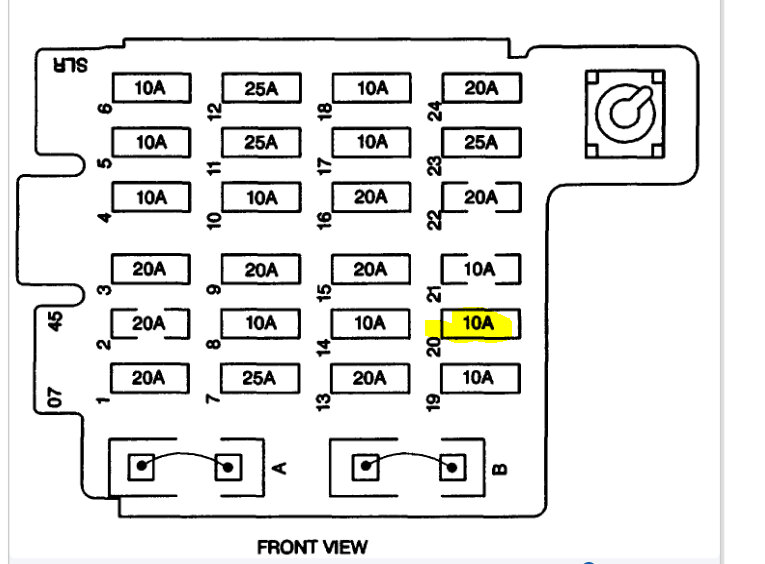

See pics below. Also, I read through the diagnostics and the first thing it suggests is to check the transmission fuse in the interior fuse box. I don't think that is an issue otherwise other things wouldn't be working such as the speedometer. However, I attached it to help you locate the fuse to check.
