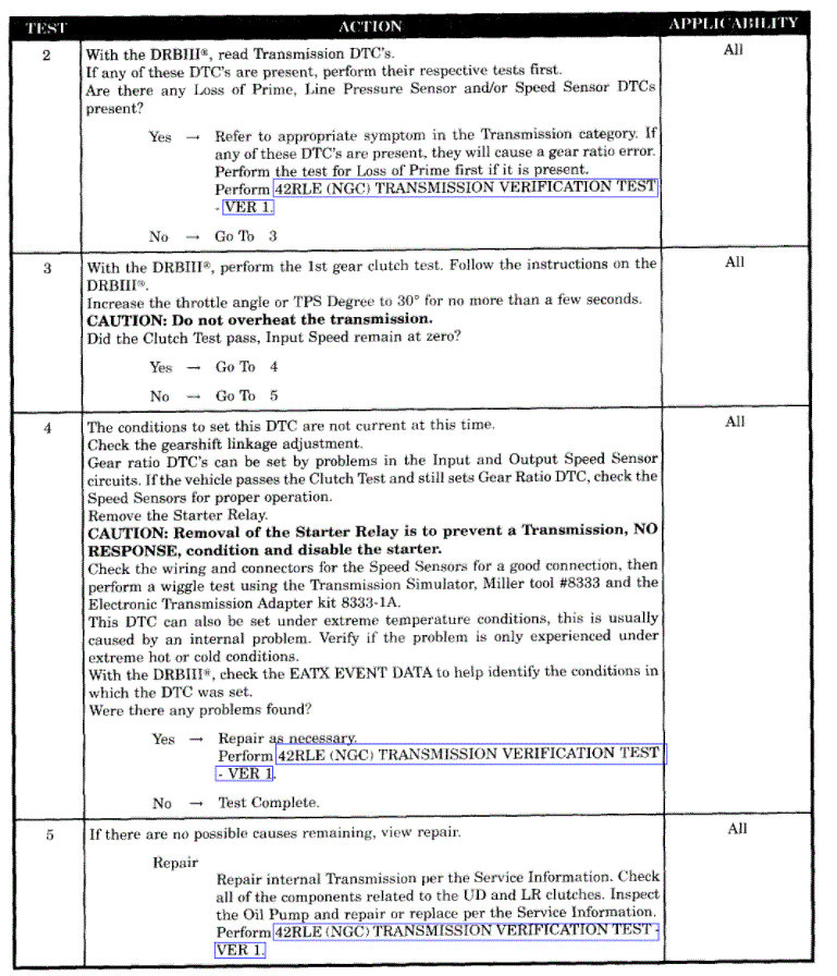

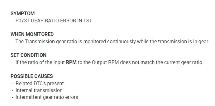

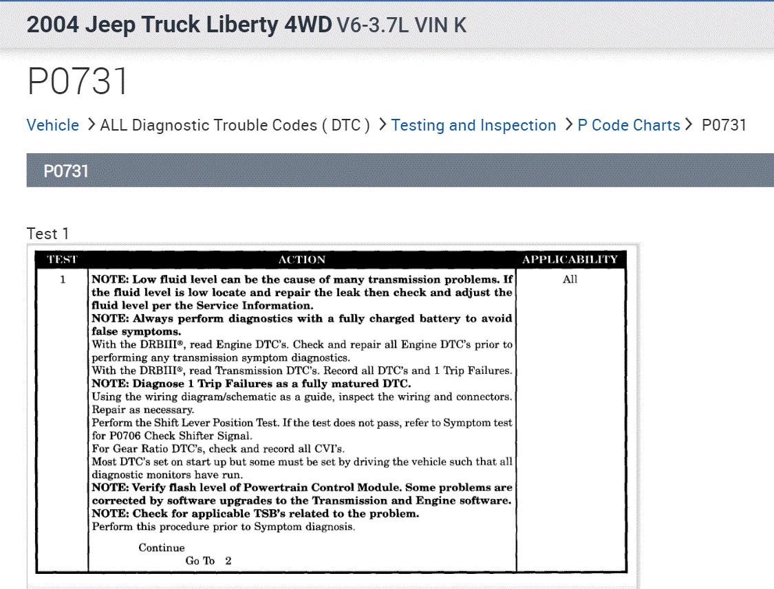

i just replaced transmission and installed a used one with 39,000 miles. the car shifts twice only and revs go up to 3,000-3,500RPMs without another shift. i wonder if this is a TCM problem or a speed sensor problem. (Code is generic PO 700 and po 731). previous transmission had a PO 740 code- Torque converter shift solenoid and lasted about 8 months. i did not attempt to replace solenoid because its inside the transmission. When the transmission fluid was getting really hot in the summer the car was shifting 1 to 2 and to 3d with a bang. every time that happened i was restarting and immediately the problem went away. Please advise. Thank you
