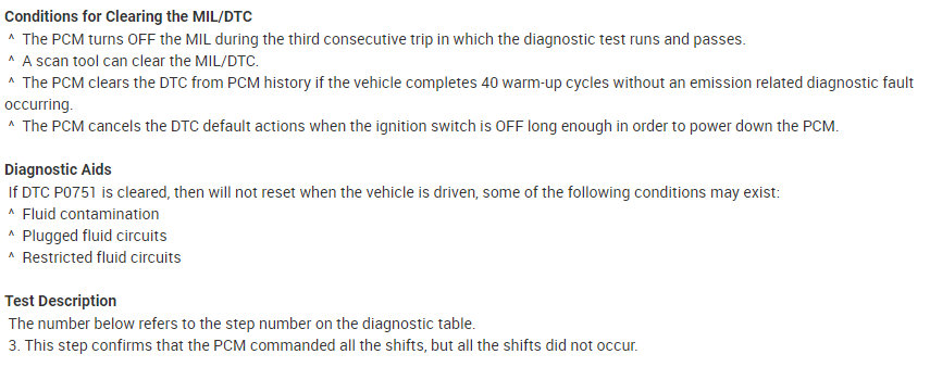

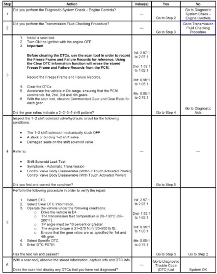

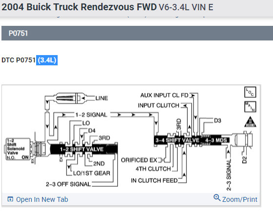

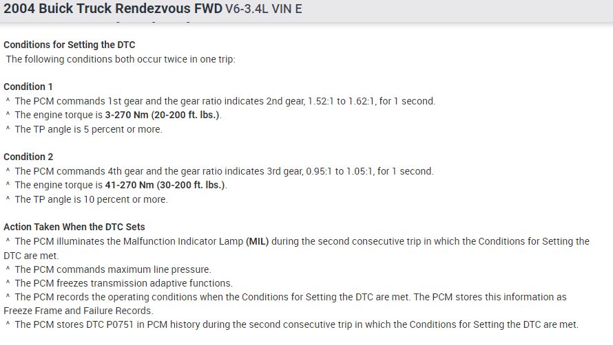

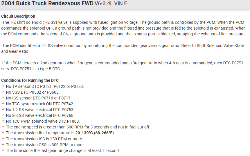

Transmission code po751. anything shy of replacement to fix this is intermittent? How do I test this? Thank you

I have attached the complete diagnostics for that transmission code P0751.
