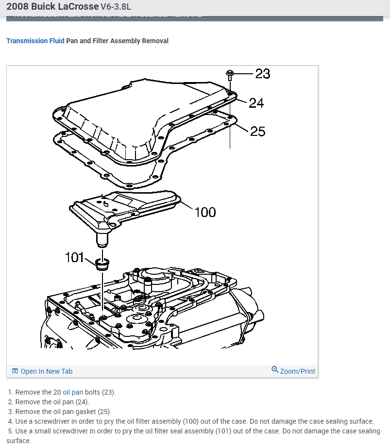

The pan gasket is a reusable one. I will replace it anyway with a new reusable gasket. When replacing the gasket do I need to use any gasket sealer on it before installing it? Thank you. Bryan Stryck.
