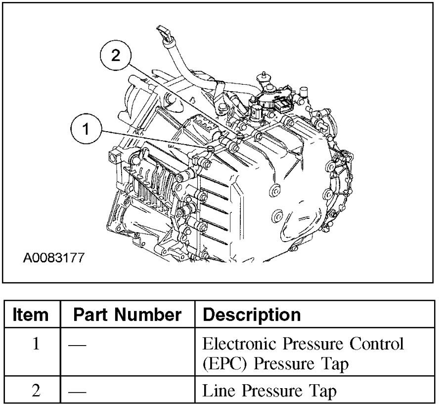

Pic 1
CAUTION: Carry out the Line Pressure Test prior to carrying out the Stall Speed Test. If the line pressure is low at stall, do not carry out the Stall Speed Test or further transaxle damage will occur. Do not maintain wide open throttle in any transaxle range for more than 5 seconds.
This test verifies that the line pressure is within specification.
1. Connect a pressure gauge to the line pressure tap.
2. Start the engine and check the line pressures. Refer to the line pressure chart to determine if the line pressure is within specification.

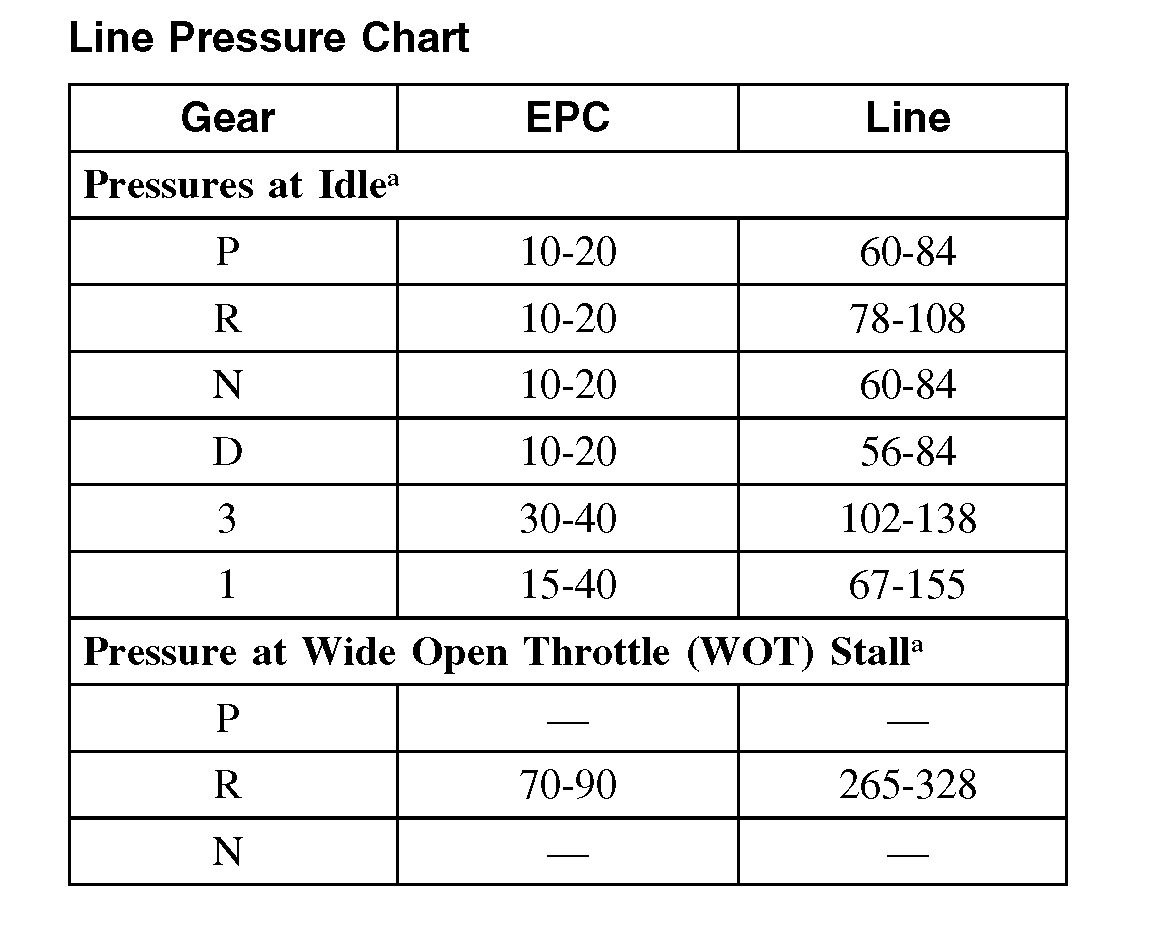

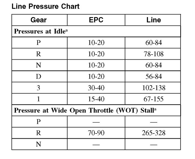

Line Pressure Chart (Part 1)
pic 2

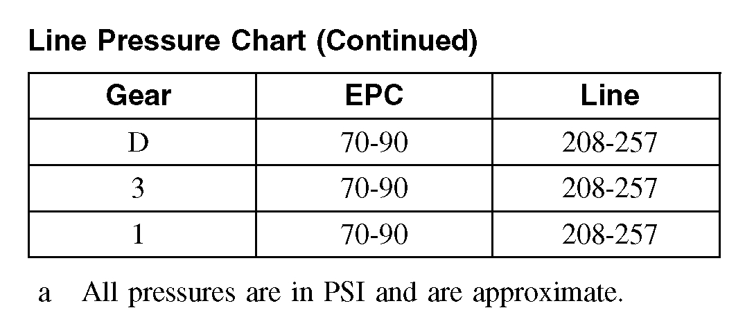

Line Pressure Chart (Part 2)
pic 3

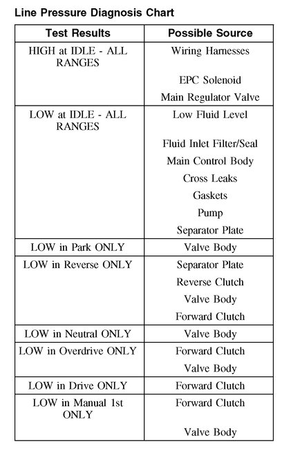

6. If the EPC pressure is not within specification, GO to Pinpoint Test E to diagnose the EPC operation. If EPC operation is OK, refer to the line pressure diagnosis chart for line pressure concern causes. See: Automatic Transmission/Transaxle > Pinpoint Tests > Test E: Electronic Pressure Control (EPC) Solenoid

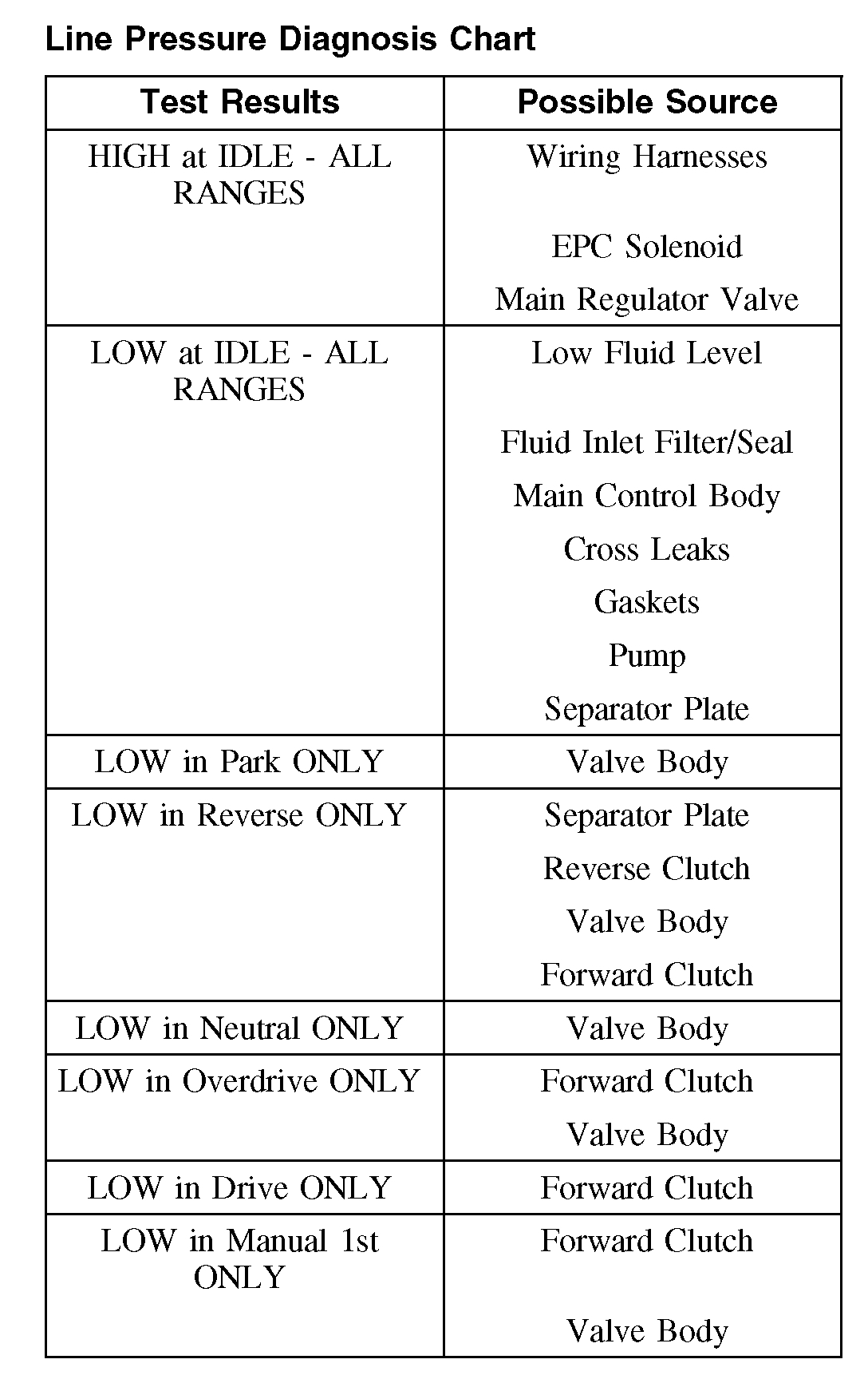

Line Pressure Diagnosis Chart
