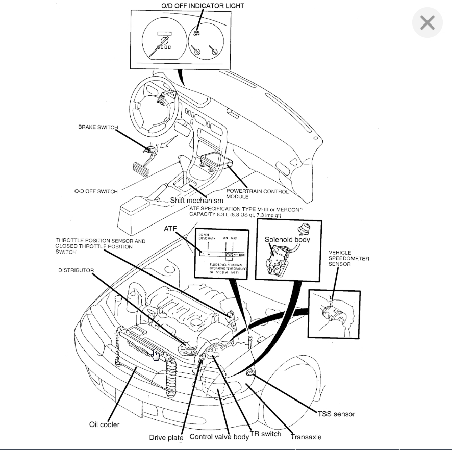

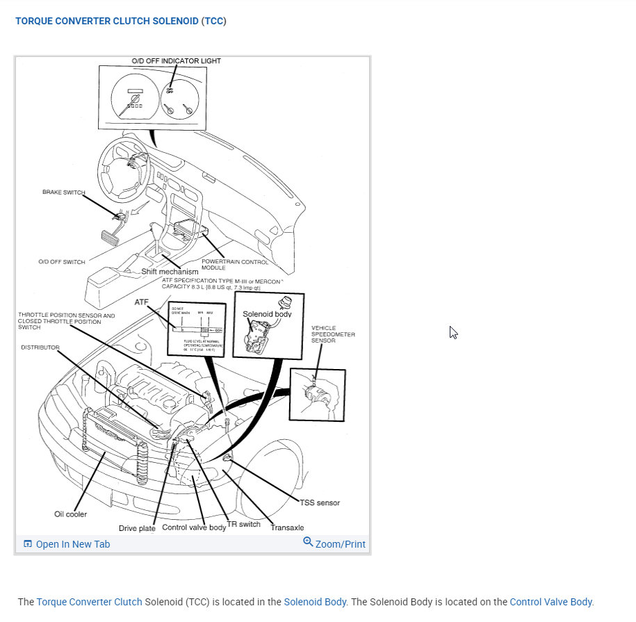

I would do just what you are suggesting. Check the fluid and make sure it is in good condition. If it is then you don't need to change it, just make sure it is full.
Then I would scan for any codes. I suspect you have a solenoid issue if all other gears are okay. However, we would need a little more proof of that before making a repair.

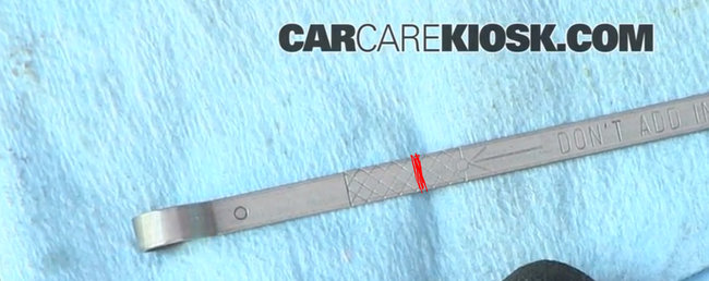

Currently with the car at operating temperature, on level surface, in park, checking the trans dipstick shows that the level is in between the hash mark, not too low, not 100% full though. The fluid is still lightly pinkish brown, no dark colors. No check engine light, would I code still be able to be present without a check engine light? Attached photo is from car care kiosk just to show you the level at which my 626 is at. Should it be topped off? Should I use something like Lucas oil trans fix to top it off?

I would not add any additives and the fluid level is fine but condition may be an issue. It should not be brownish. It should be brights pink. More than likely you have a solenoid issue and could have a code with no check engine light. So I would have it checked. However, if there are none there then we will need to get into some pretty heavy diagnosis. Let me know if you are going to perform this and i will send you how to test them. If not, I would just call around and take it to someone who works on Mazda's. They are pretty easy but the last thing you want is for someone to guess at this.

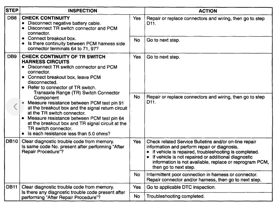

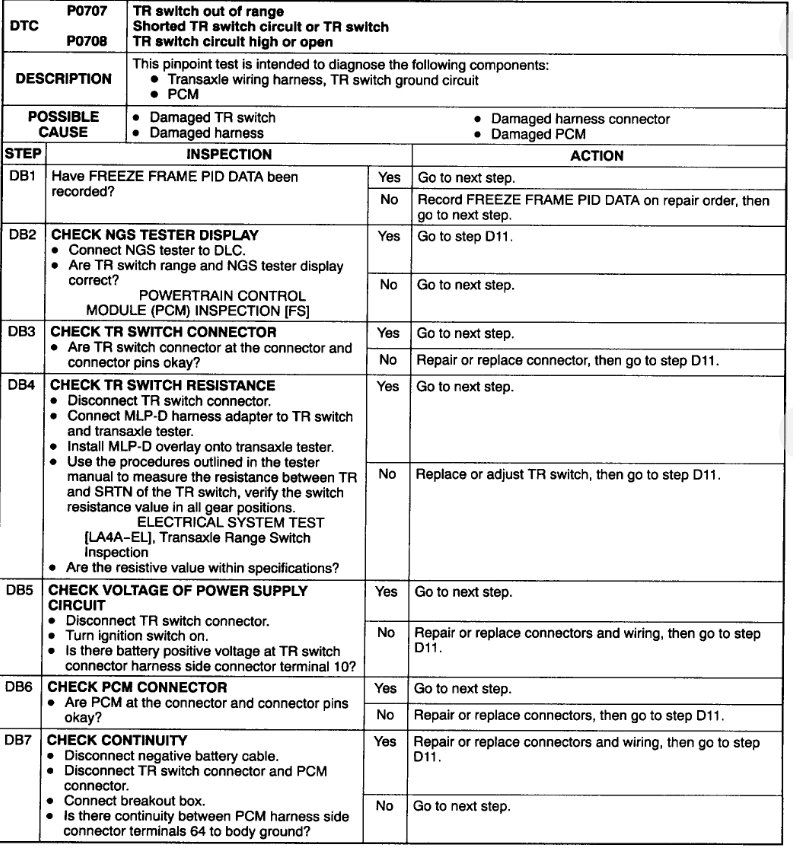

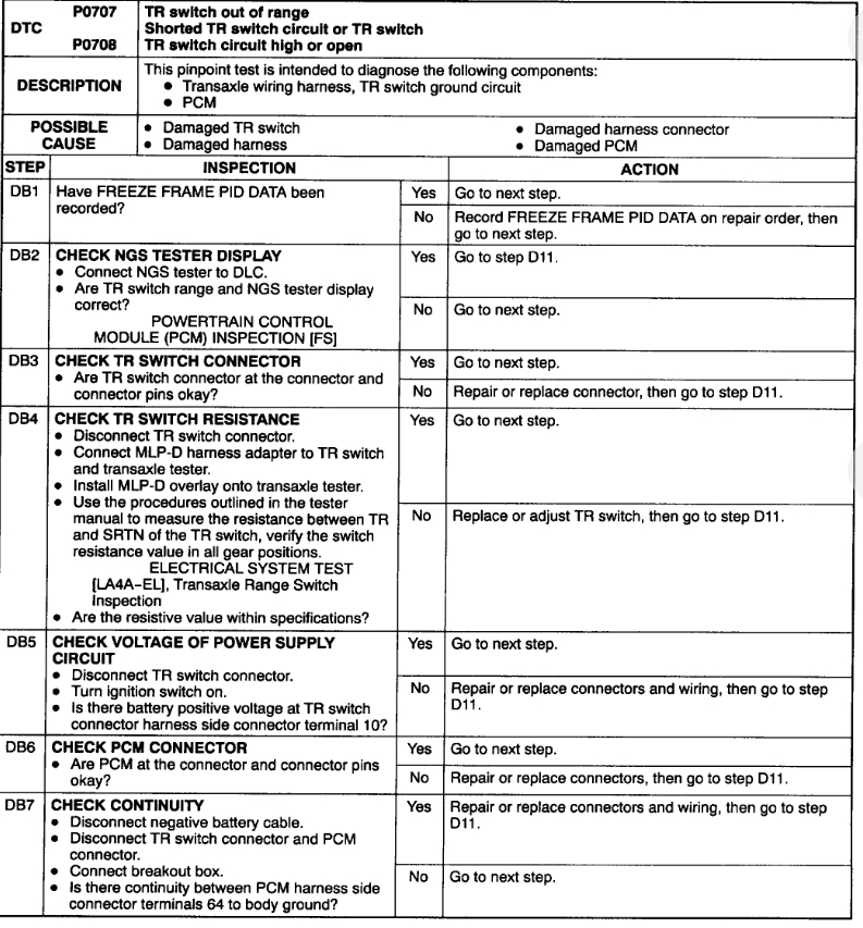

Send me the diag procedure and I'll see if I can do it. I'm worried with the shitty rep this transmission model has that it may just be slowly dying as it's worn out at 110,000.
Oct 31, 2019 at 5:19 AM
Here is the procedure for this code. Let me know what you find. Thanks
Oct 31, 2019 at 5:27 PM

Just wanted to give an update on this. sorry it's so late, got a lot going on but good news is it's fixed. p0708 led me to search up very detailed about the 626. It was a faulty neutral safety switch sending wrong info to the TCM when hot. the sensors degrade over the years and then when they get hot it will cause the issue with a bad sensor. I replaced the sensor for about $22.00 and haven't had an issue.
