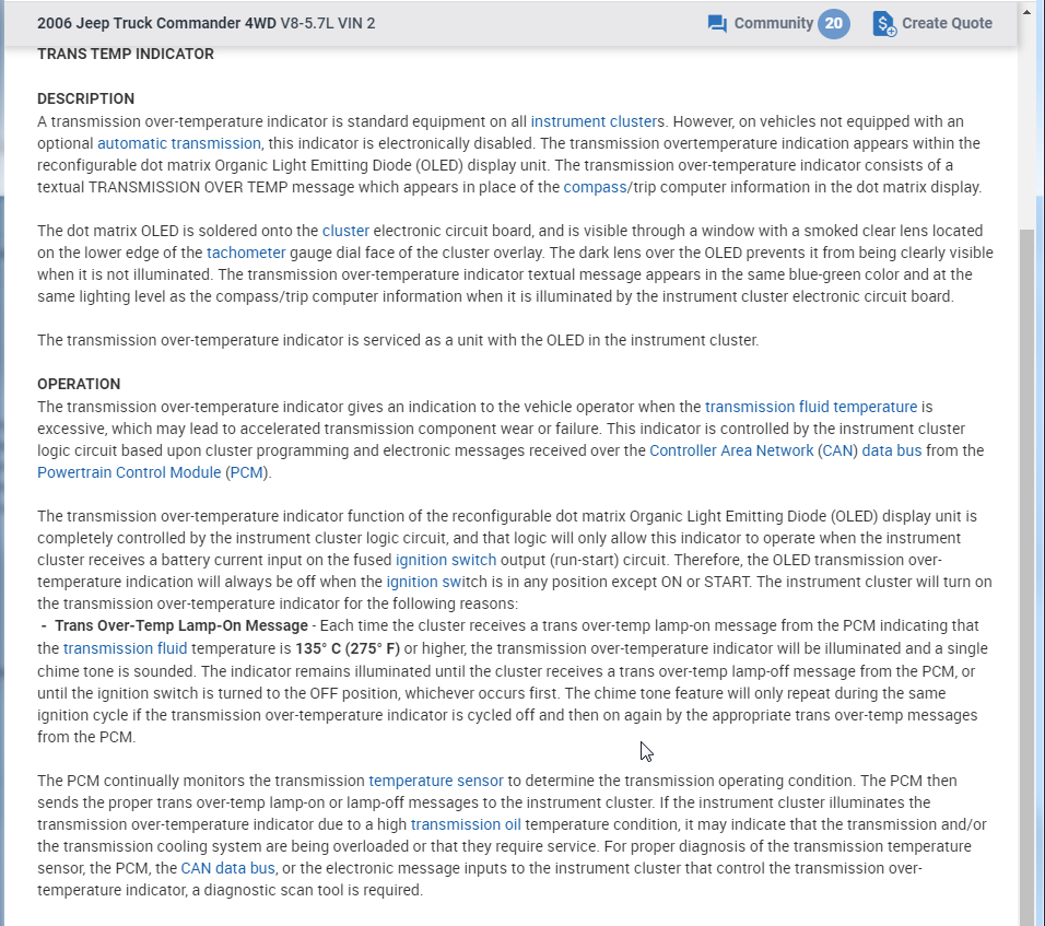

More then likely you have some codes to go along with this. Let's check for codes and go from there.
I attached the info about when and why this light comes on. If there are no codes then most likely the transmission is getting too hot.
Let's start with codes and go from there. Thanks
