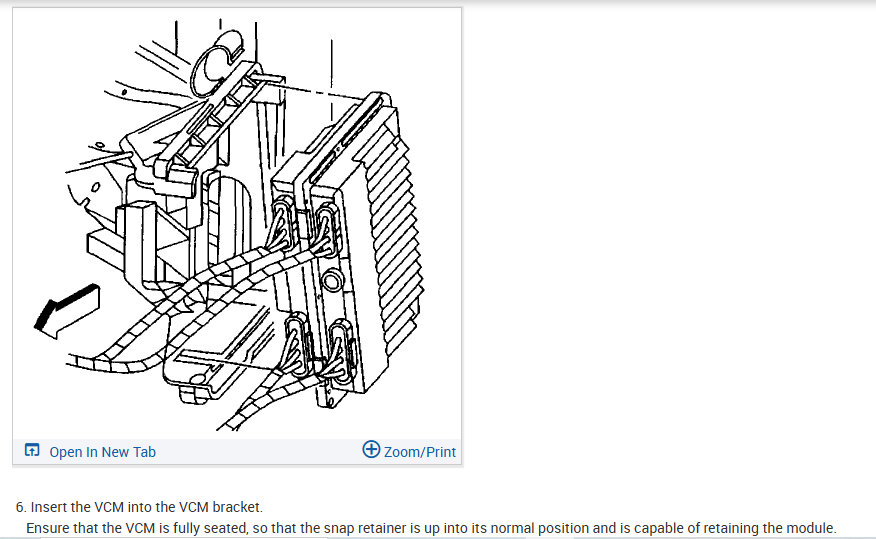

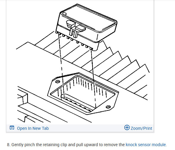

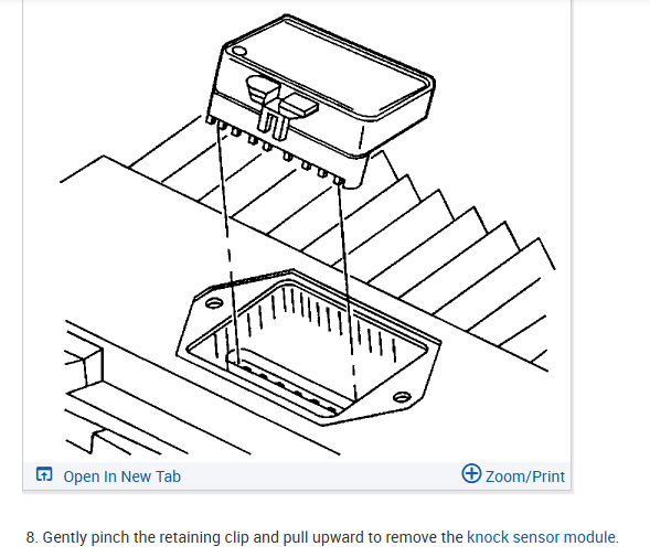

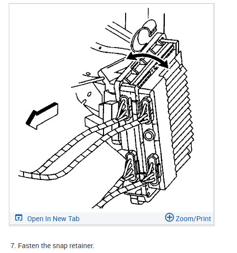

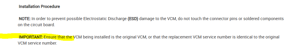

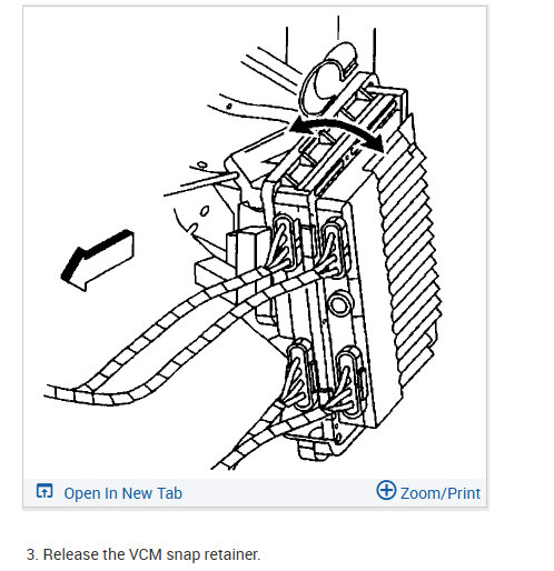

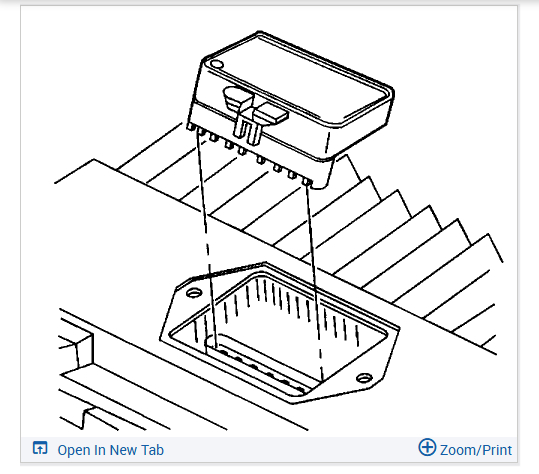

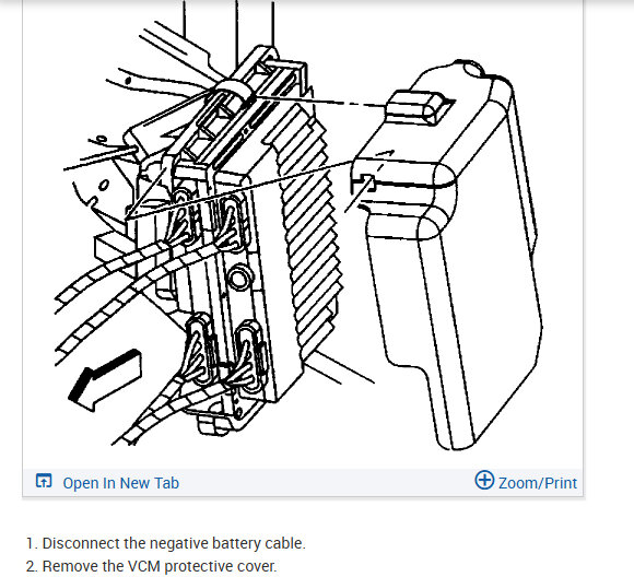

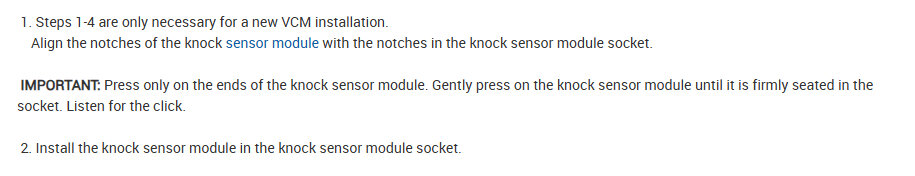

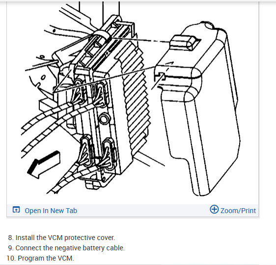

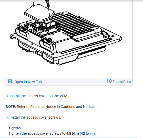

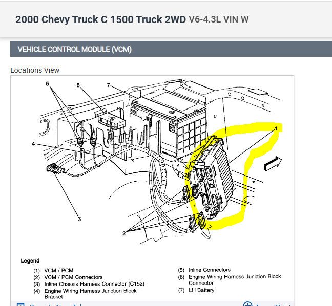

The transmission in this model year is controlled by the VCM/PCM (vehicle control module / powertrain control module. There isn't a separate module for the transmission,

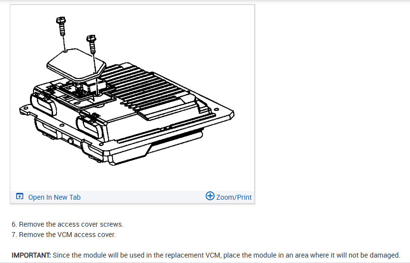

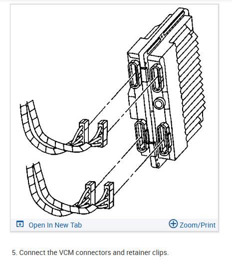

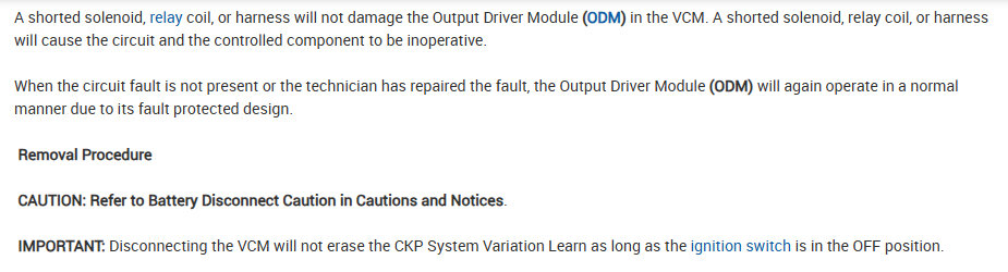

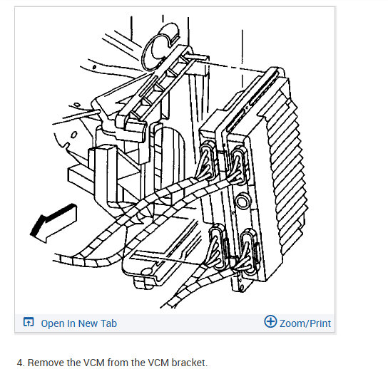

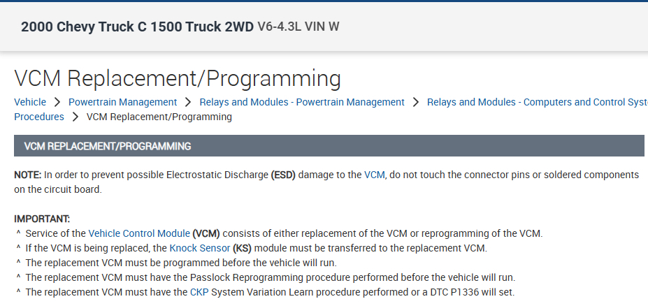

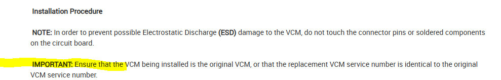

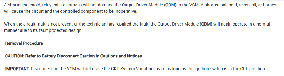

If you look below, I included the directions for replacing the module. Let me know if this helps.
Also, since the PCM is in control, a basic scan tool should provide relevant diagnostic trouble codes. Most parts stores will do that free of charge for you.

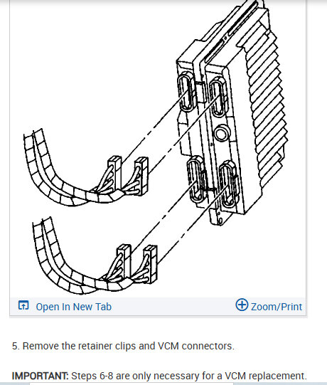

See pics below. Pic 1 is to provide a location only. The module is under the hood close to the battery (driver's side). The remaining pictures are the directions. Also, note that a new one will require programming. Often, you can get a plug-and-play one remanufactured online for a lot less money and preprogrammed to your vehicle.

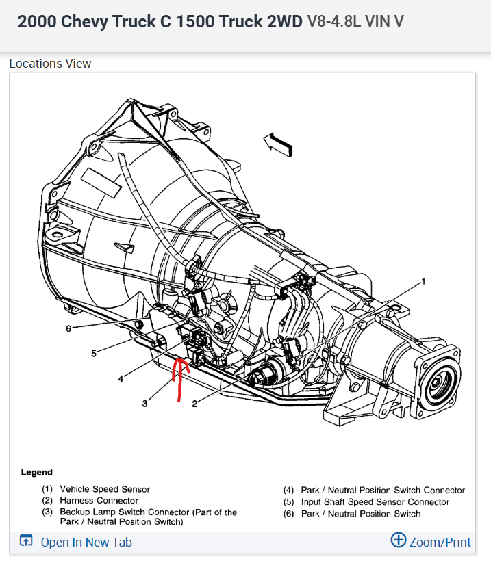

when you changed the transmissions did you change the gear range sensor as well? This is what tells the PCM what gear you have selected and if it is not working you will have this problem, Also, you don't need a high-end scanner to run the codes, which I would do as well. please go over this guide:
Here is the location of the gear range sensor so you can see what I am talking about. Check out the images (below). Please let us know what happens.
