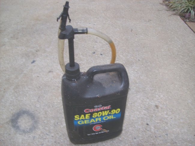

Your transfer case and differentials do not have dipsticks, you must remove a fill plug (if fluid runs out, it;s full!) if none runs out, you must top it off.
Your owners manual/ repair manual will tell you what type fluid goes in it.

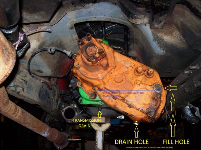

I'm gonna show you my JEEP CJ-5 Manual tranny and transfer case, your transfer case is similar BUT on the back of your automatic transmission

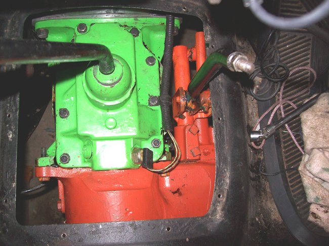

1) Manual Tranny Green / Transfer Case Orange INSTALLED IN MY JEEP ('hump' cover is removed)

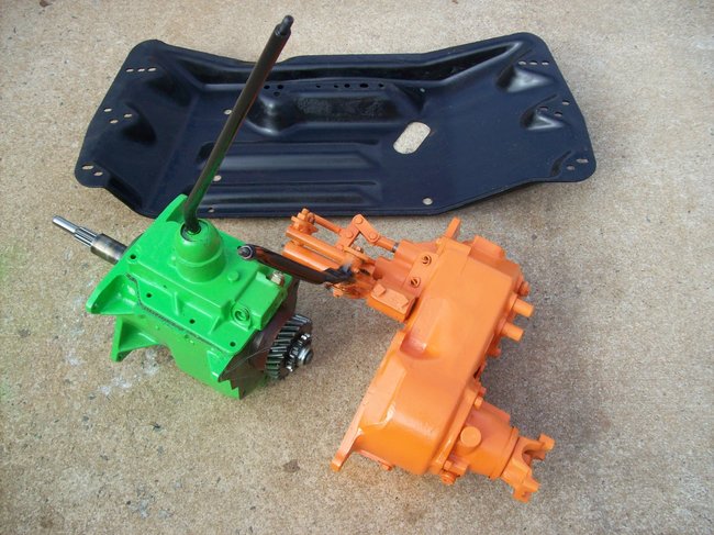

2) My tranny/ transfer case/ skid plate freshly rebuilt ready to install
3) Pic of rear of my transfer case (JEEP) See MY fill hole? (Hope you can see my writing)

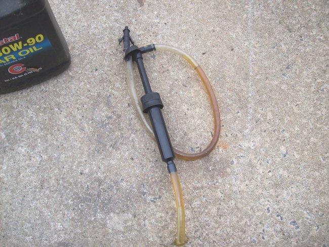

4) $5 pump from auto store to install "MY" kinda fluid from under Jeep
5) Pump mounted on my kinda gear oil jug

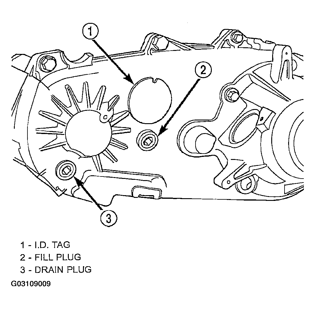

6) THIS IS A DIAGRAM I GOT FROM "PRODEMAND" OF YOUR TRANSFER CASE!

7) Some of my Jeep Manuals
If you do find your fluid is low/ gone, look for where it may have leaked out. Repair!
If indeed this was a low fluid issue, you may have already caused damage. Then again, maybe you caught it in time! Replenish the fluid and see what happens.
