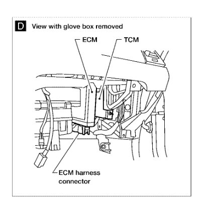

It sounds like the transmission control module might be out, but we should run the codes first. Also, recheck the ground wires. Here is a guide to you get the codes please get back to me after you run them. I have the transmission control module location in the images below just in case.
