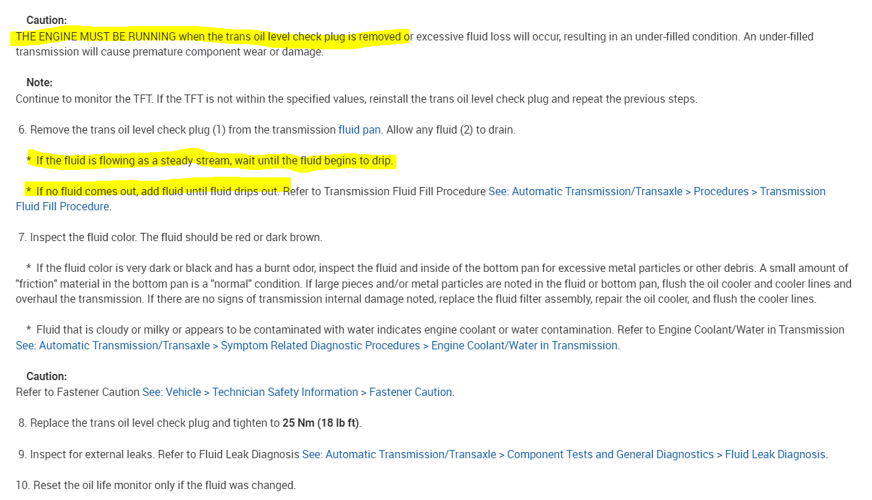

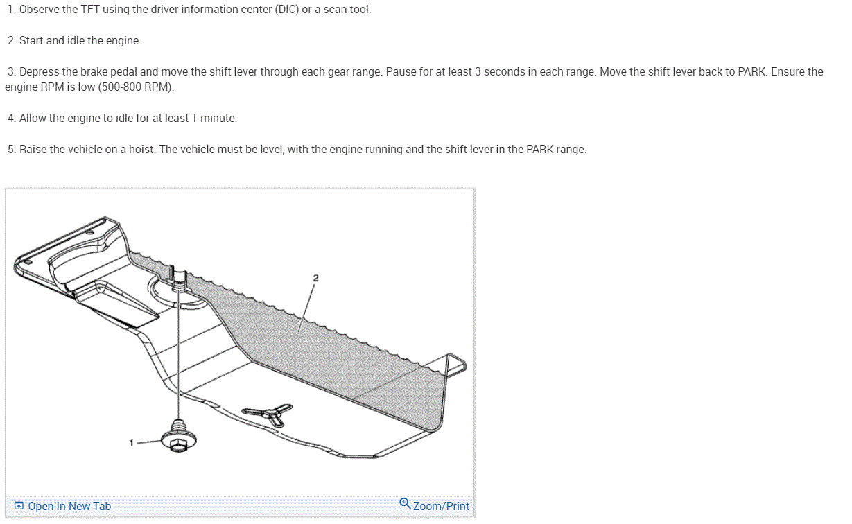

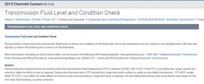

As far as checking the fluid, the only hard part would be accessing the check plug on the transmission oil pan. If you are able to reach it, I attached the directions below for checking the level. The directions indicate a specific temp to check it. Allow it to warm up to operating temp and that should be fine.
Take a look through the directions and let me know if you have questions.
See pics below.
Note: The engine needs to be running and the transmission in Park. If the engine is off, you will lose most of the oil in the transmission when checking.
