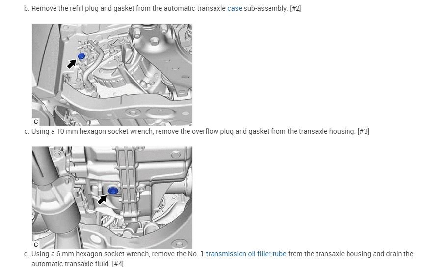

I want to know is there a transmission oil filter that I can change it in the car listed above with 8 speeds transmission?

Good evening,
The filter is internal in the transmission and is not accessible to replace without removing the transmission and splitting it in half.
You can only change the oil.
