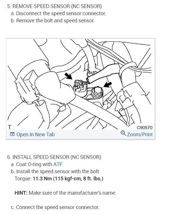

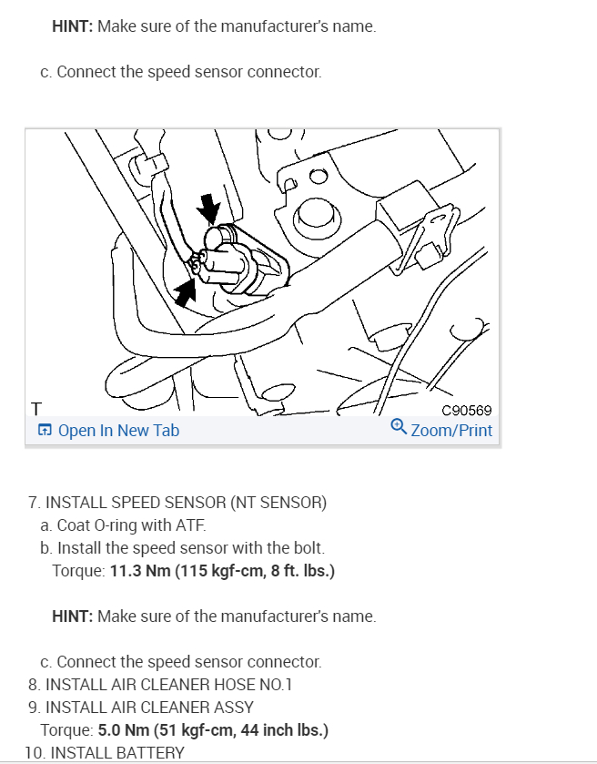

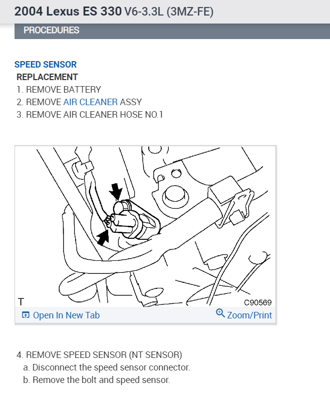

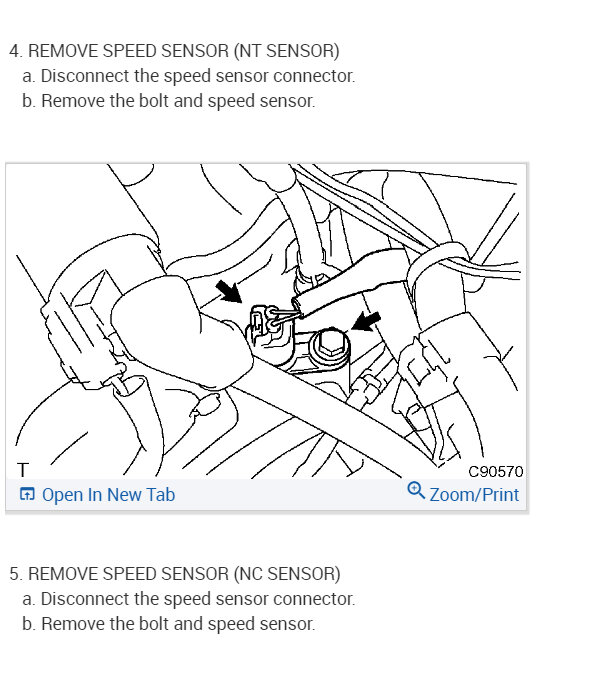

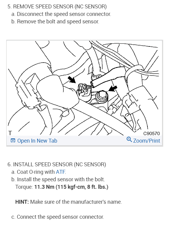

Is the speedometer working? if not I think you bumped the VSS sensor wiring, here is the location so you can check. Check out the images (below). Please let us know what happens
