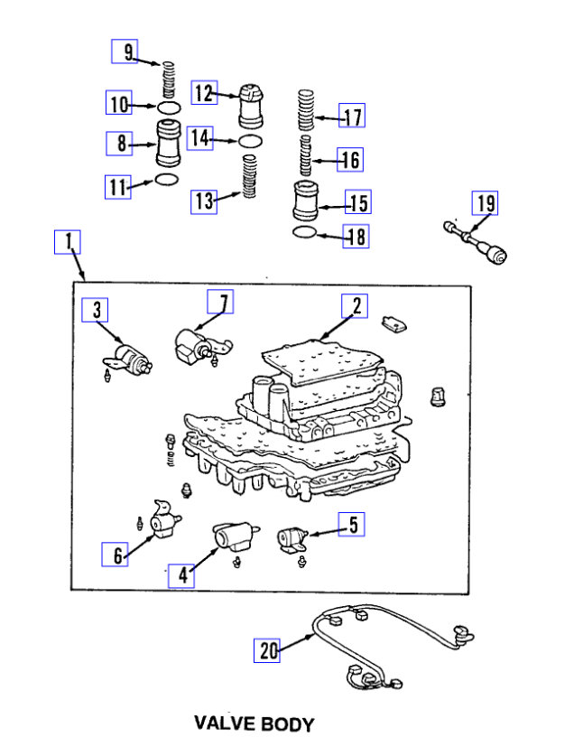

If no codes still it sounds like the pressure regulating solenoid is out which is in the valve body so if you get a rebuilt unit it should fix the problem. Check out the diagrams (below). Please let us know what happens.

Am yet to open it up to check the pressure regulating solenoid.

I suspect it is related to the pressure regulating solenoid as well. If you can, let me know what you find. I would be really interested in knowing.
