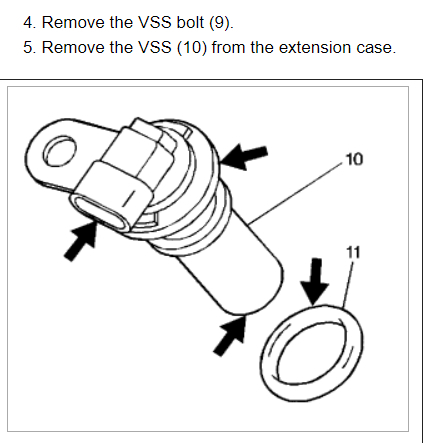

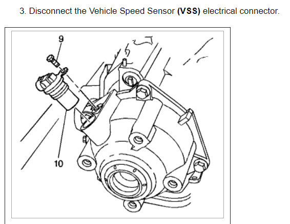

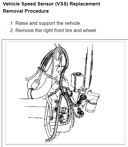

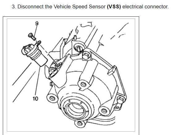

Transmission acts like it does not know which gear to stay in, shifting erratically and the speedometer fluctuates or shuts off altogether. I have replaced the speed sensor twice, car will run okay for ten to twenty miles then start the same problems. Are there any other sensors on the transmission that would cause this if faulty? Thanks
