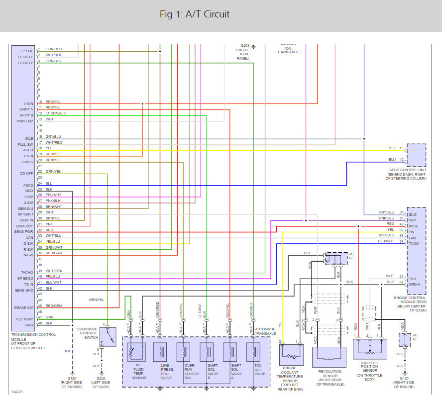

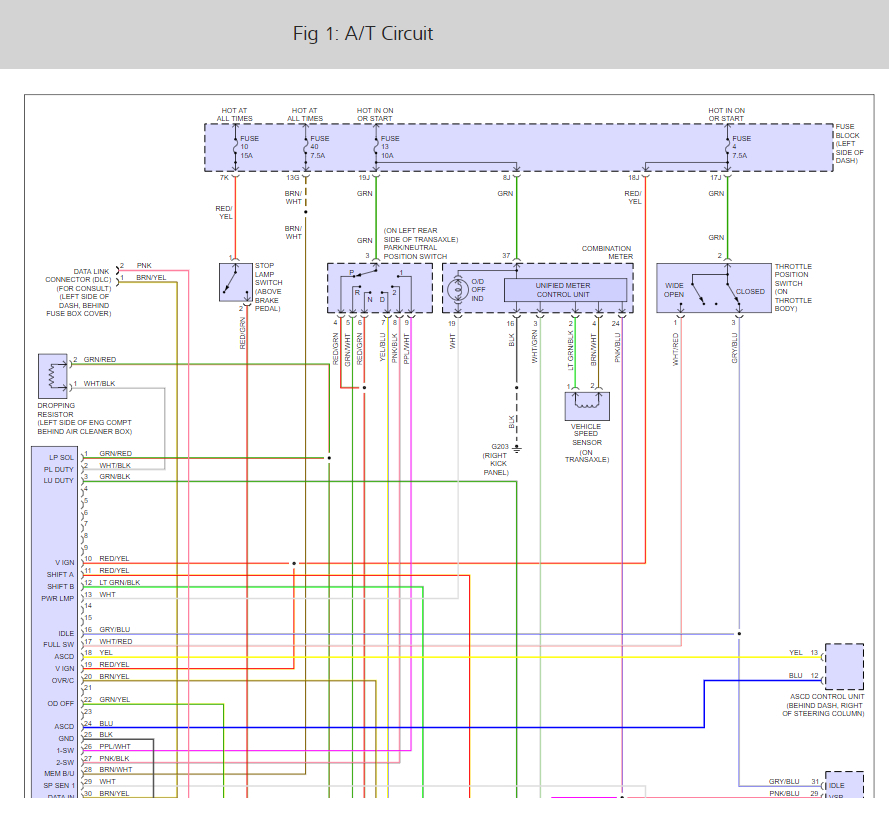

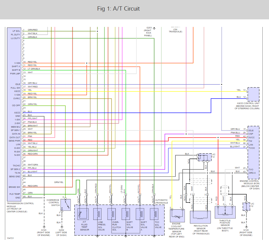

This is a circuit code it sounds like one of the wires is broken or not making a good connection. Here is a guide and the engine wiring diagram below to help us get started:

It appears that the wiring diagram is for a Honda. Does that matter?
Sep 21, 2018 at 12:19 PM
I updated the images sorry, not sure what happened.
