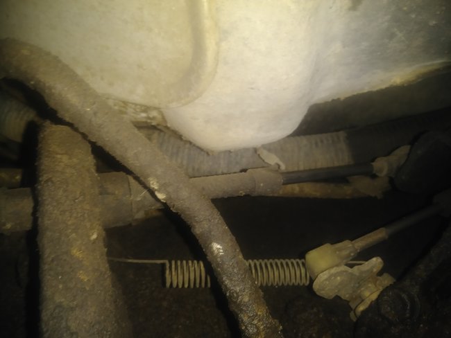

Hey Roy it is David i was speaking with you yesterday. i am at junkyard noticed shift cable on all these do not look like mine. on the other side of the metal bracket by the transmission there bushing or clip with a spring Inside. on mine the spring has popped out. this is a picture of one at junkyard the part right above the long spring. The picture is truck at junkyard. what they all look like mine as the spring popped out. i did not think it looked right.
Feb 1, 2018 at 8:42 AM
it does not look correct at all.

The picture is the one at junkyard on mine the spring has popped out and just hanging there. could this simply be the problem it is a bushing or clip on the transmission side of bracket holding shift cable?
Feb 1, 2018 at 9:04 AM
you can try that. it is a return for throttle cable. try it and see before removing the transmission.
