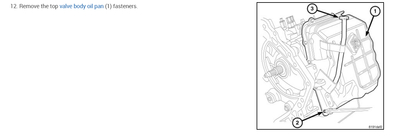

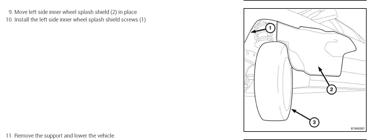

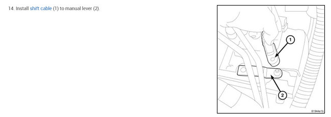

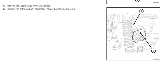

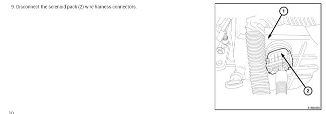

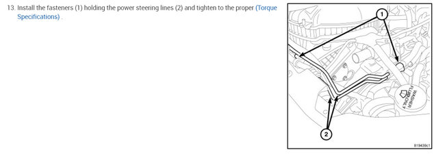

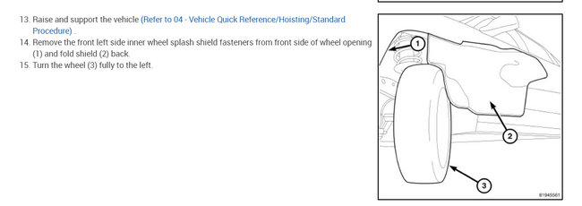

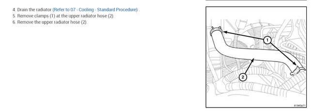

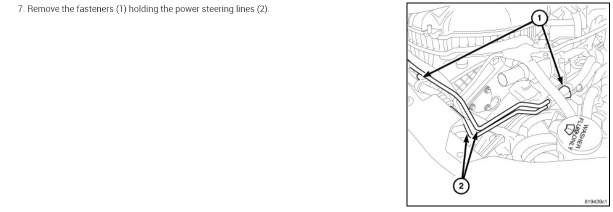

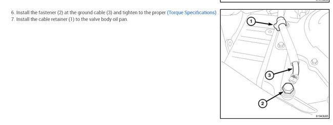

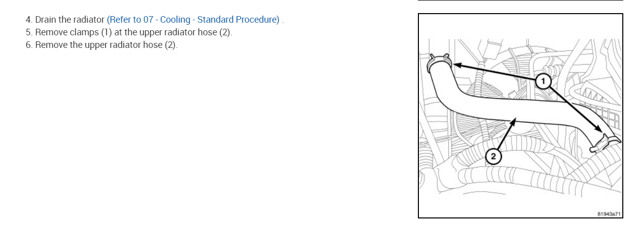

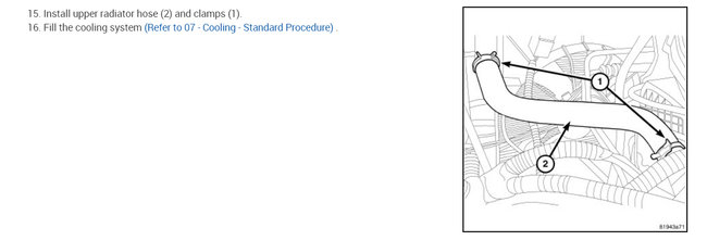

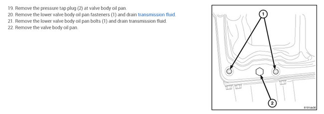

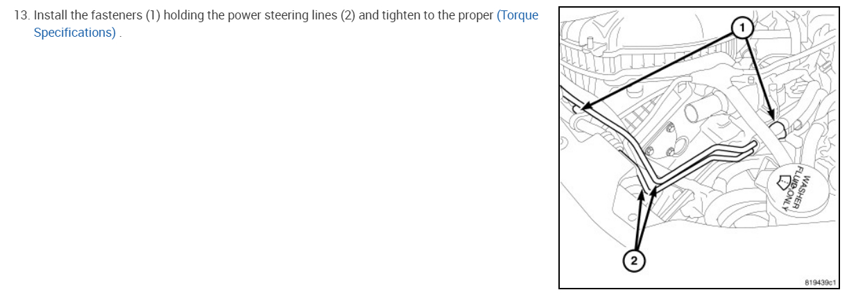

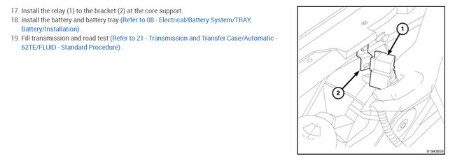

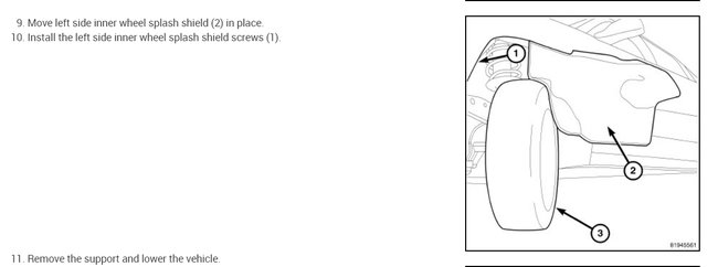

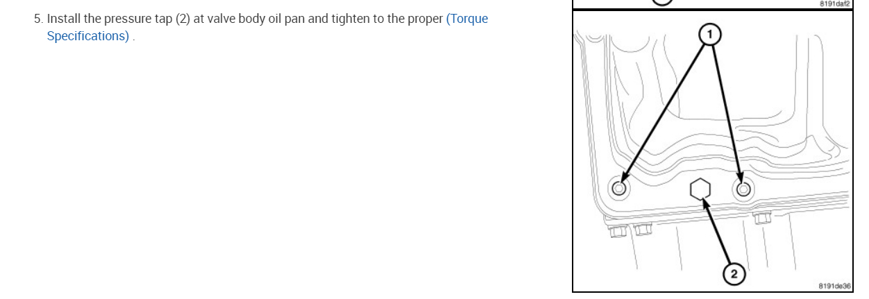

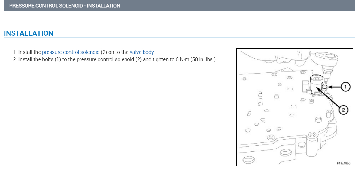

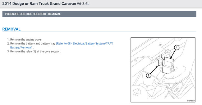

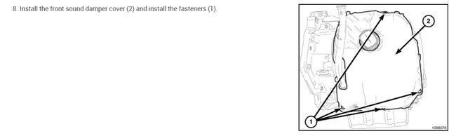

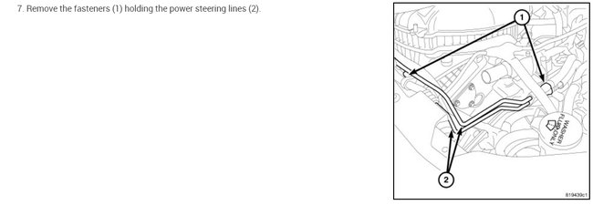

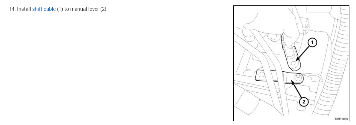

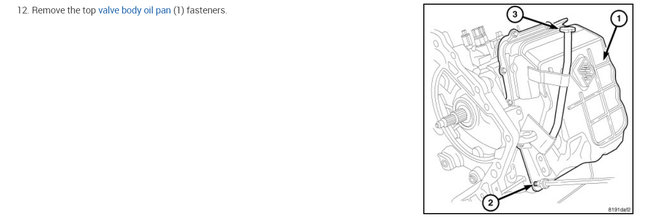

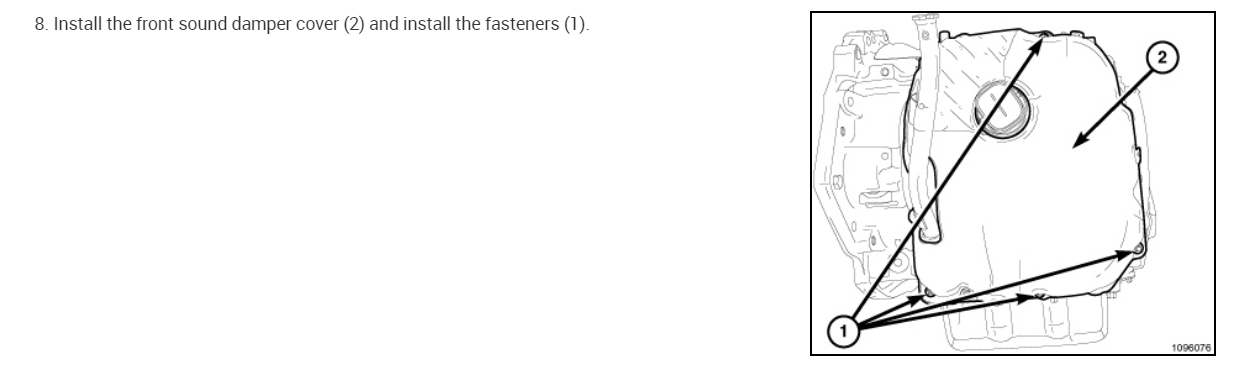

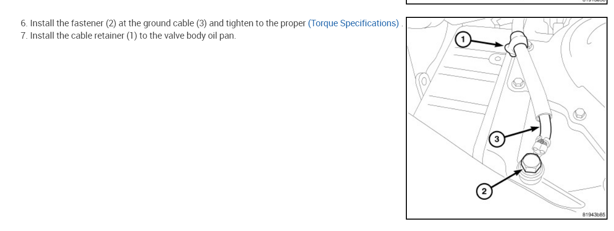

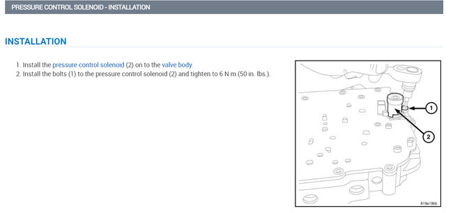

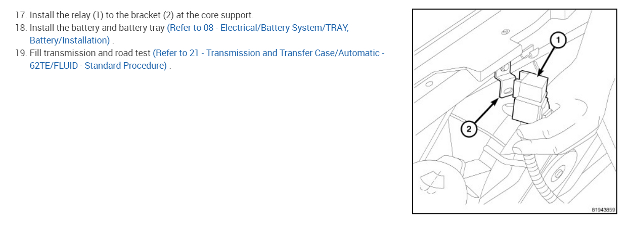

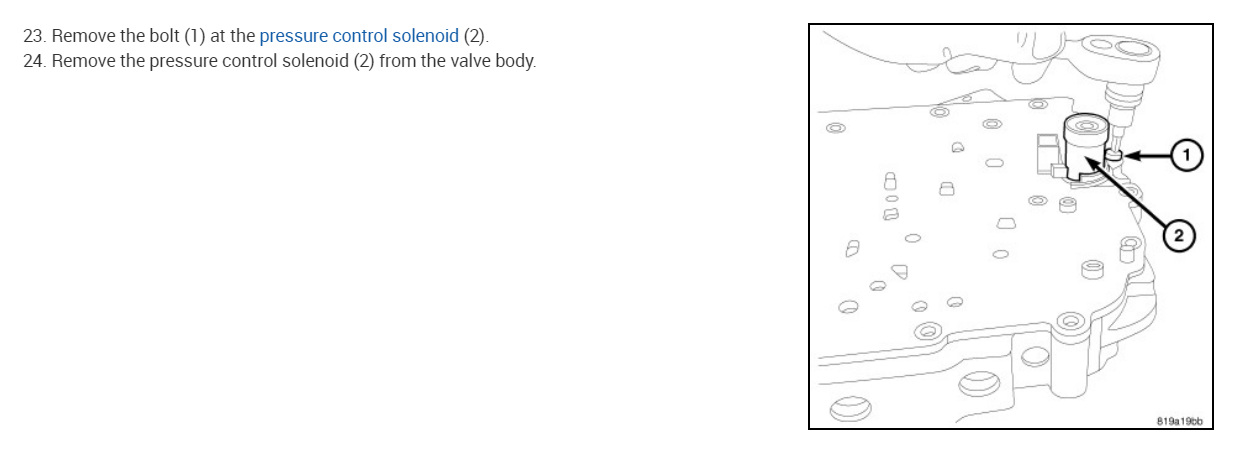

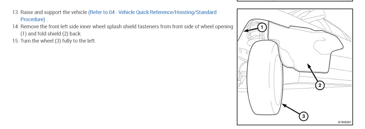

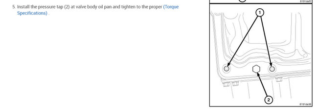

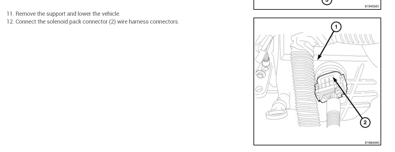

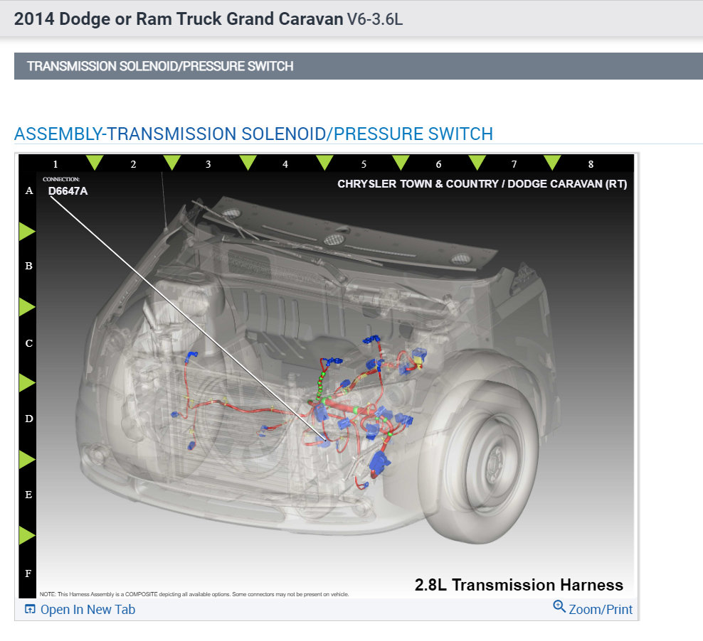

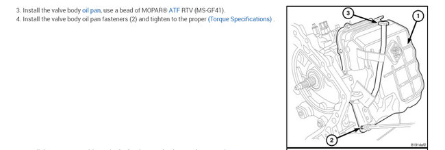

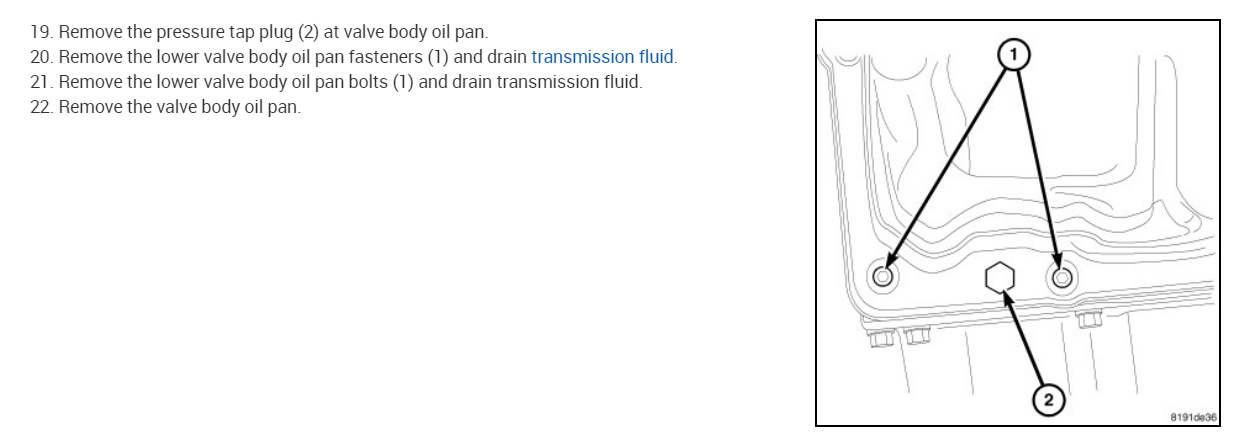

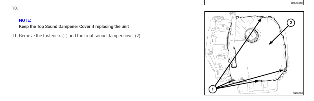

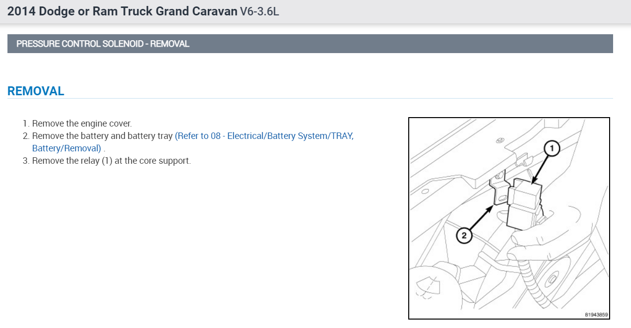

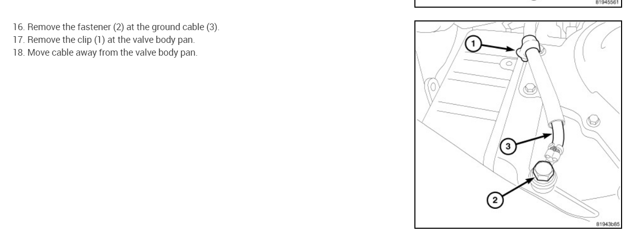

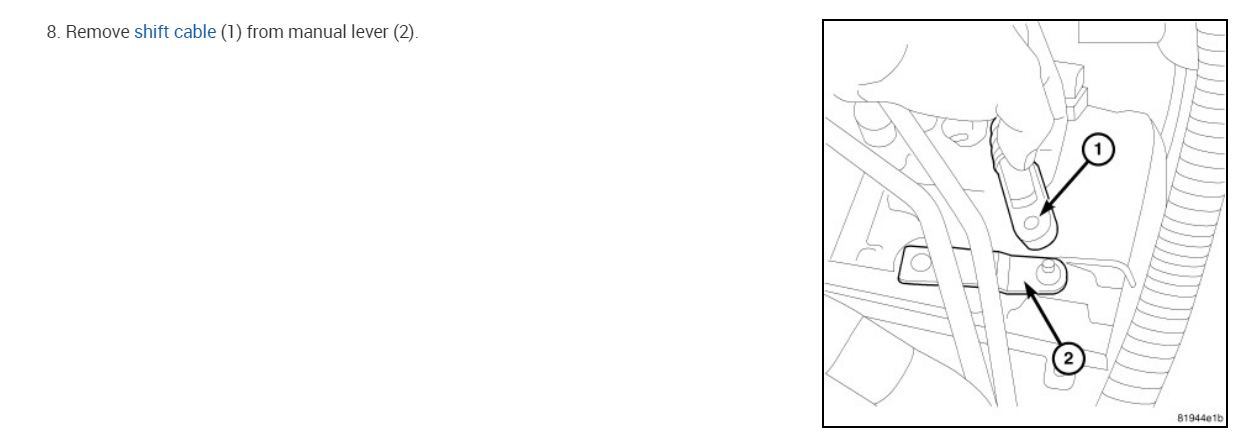

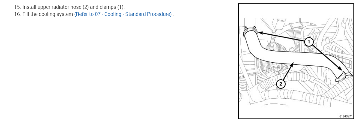

Code P1745 means the line pressure too high for too long. This happens when the pressure control solenoid gets stuck on and needs to be replaced. here is the location if the solenoid so you can change it out and fix the problem. Check out the images (below). Please let us know what happens.
