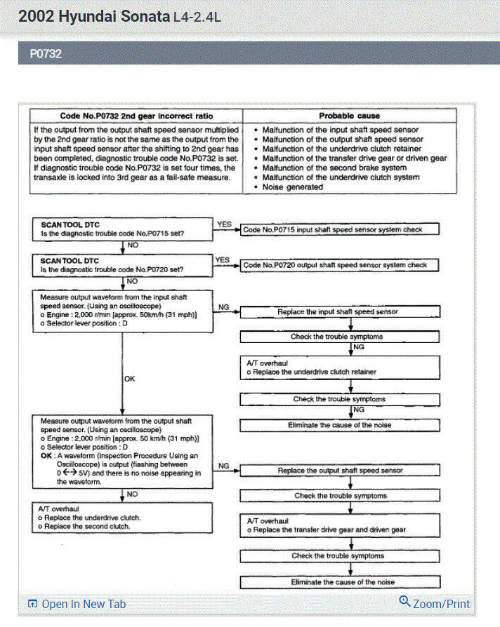

The code could indicate a few different things. For example, it could be a faulty input or output speed sensor or even need to be overhauled.
I attached the diagnostics below. Make sure this is the only code present. If other codes are set, they may need attention prior to focusing on the P0732.
Let me know if this helps.
See pic below.

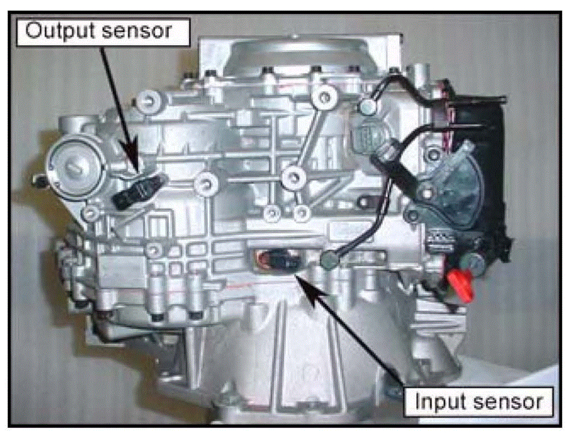

My manual doesn't show the waveform. Do me a favor. Check the connection at both the input and output speed sensor. Using you live data scanner, see if there is a signal from both.
See pic 1 for sensor location.
See pic below.
