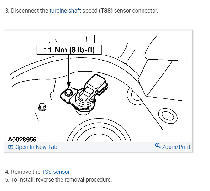

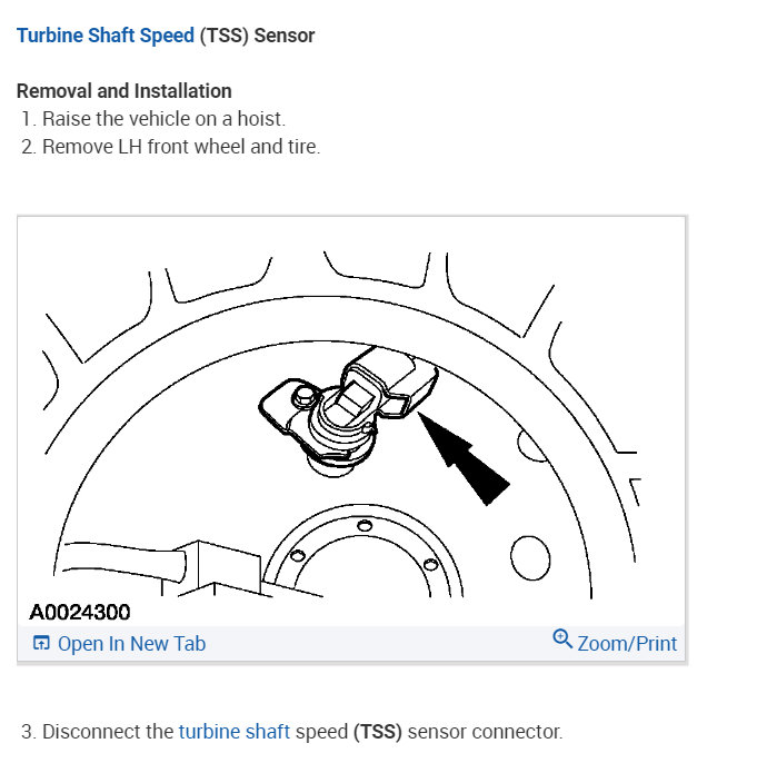

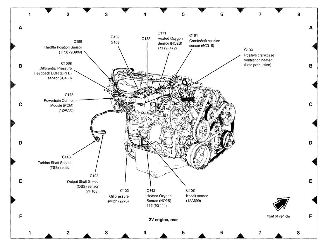

It sounds like you have an input shaft speed sensor that is not working. We should run the codes first though this guide can help, and I have left instructions on how to change out the shift solenoids in the diagrams below.
