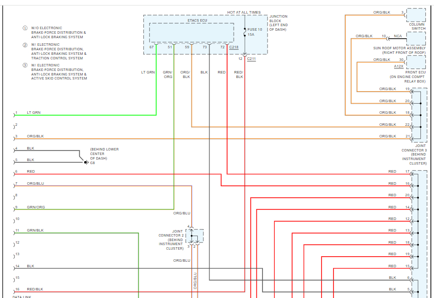

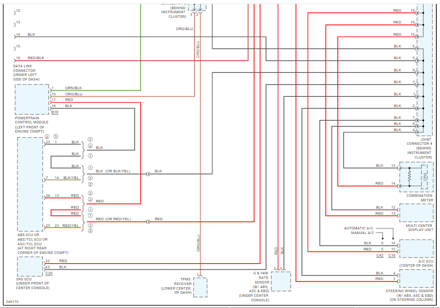

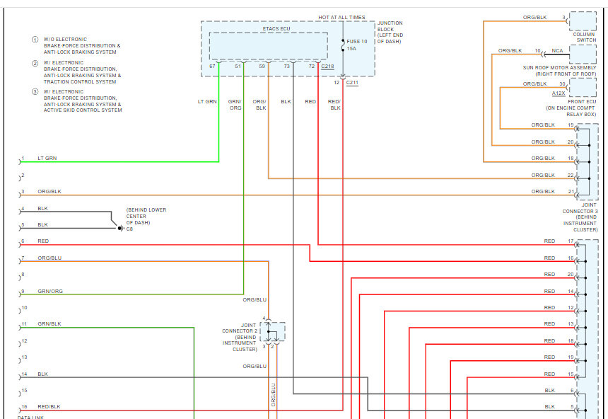

Good morning. Thanks for the timely help. I scanned the bus and the codes you gave go to the address you mentioned, I sent you photos and any suggestion or help is highly appreciated. If you could send me a diagram of the Cam Bus circuit, I would appreciate it. Jose
Apr 22, 2024 at 4:03 AM
If you look below, I attached the can-bus wiring schematic. The schematic was one page in length. However, I had to cut it in half to make it readable for you. I did overlap the two so that you can follow from one to the next.
Take a look at what I attached and let me know if it helps.
See pics below.
