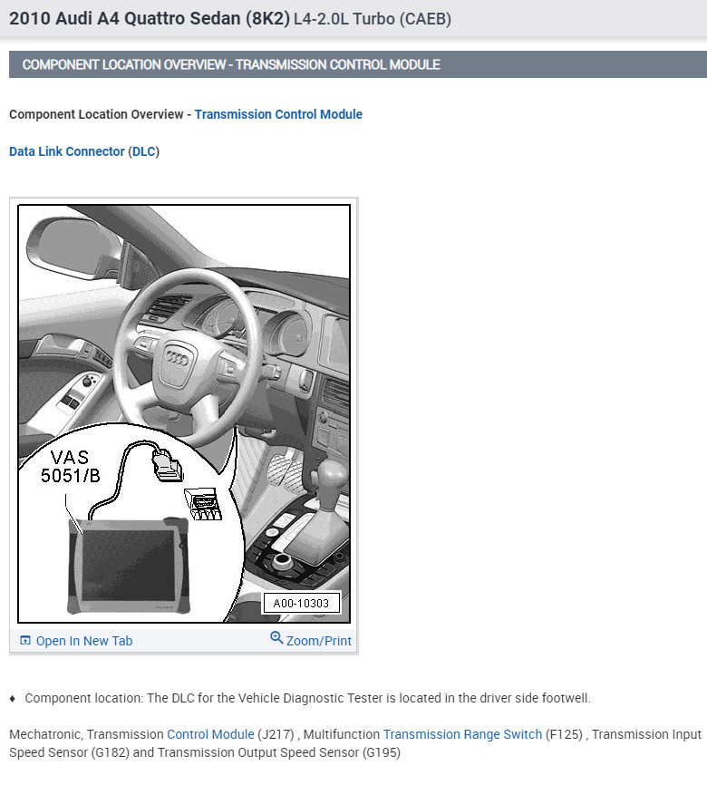

Is it behind the gearbox or on passenger side, trying to find any modules or TCM on this car? Please, and if there are any fuses as well.
May 10, 2022 at 6:48 AM
SQM
CERTIFIED EXPERT
6,383 POSTS

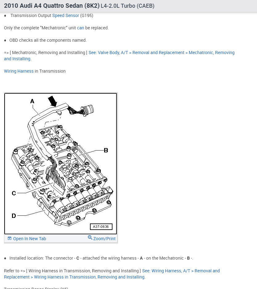

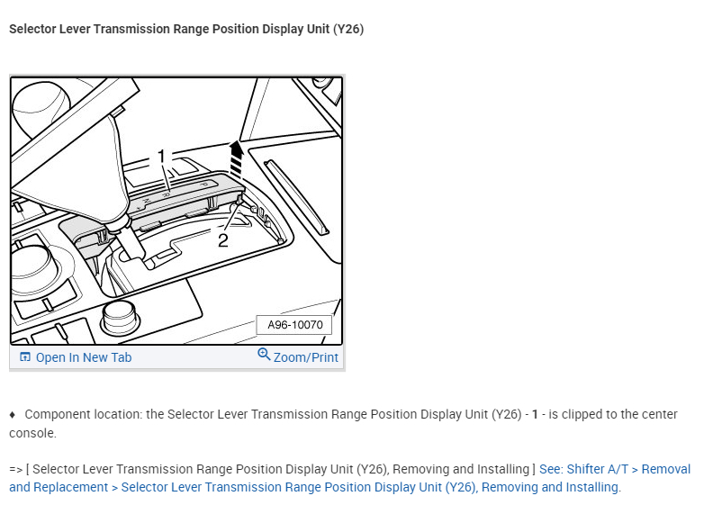

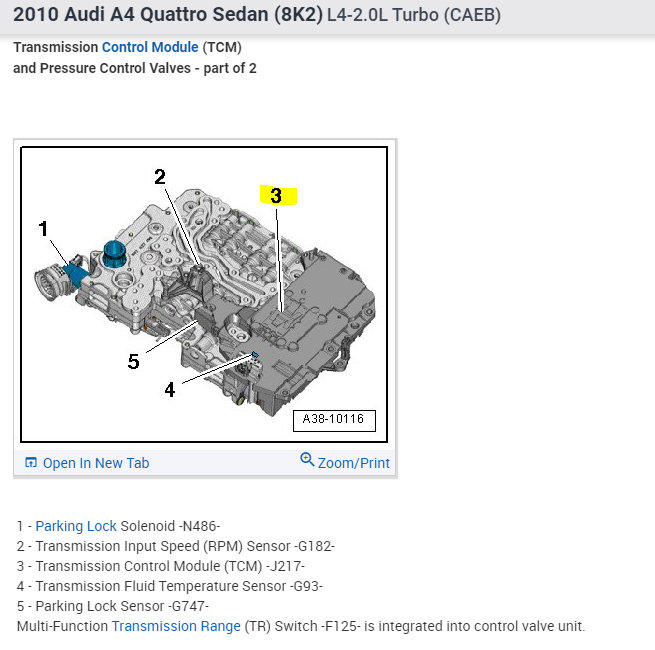

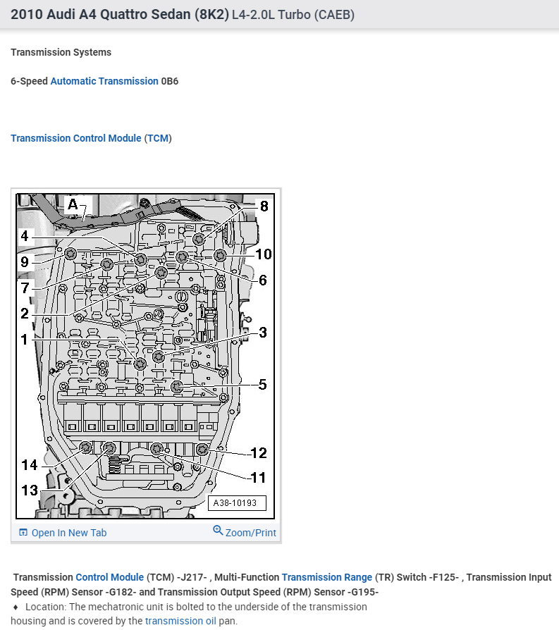

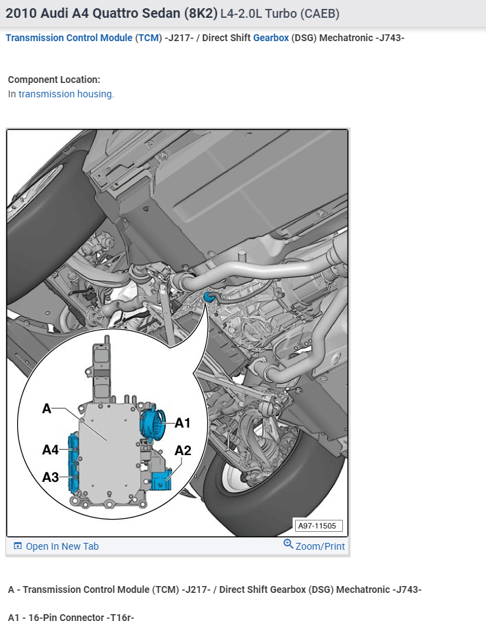

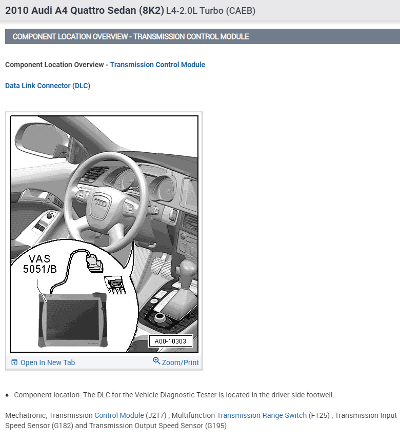

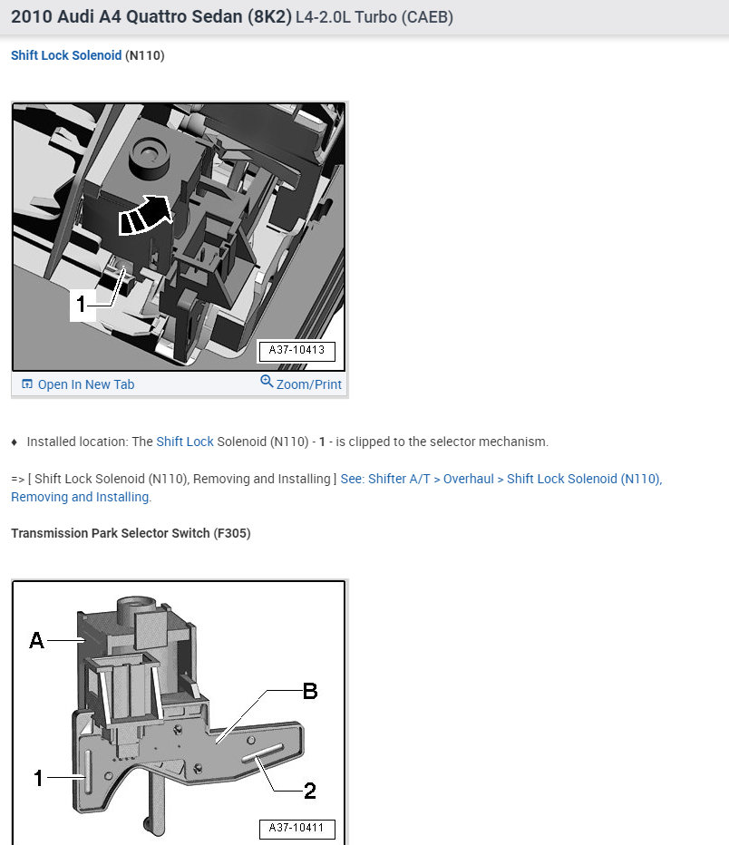

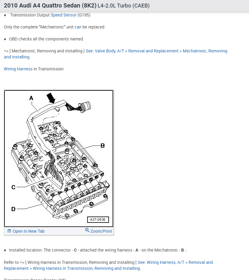

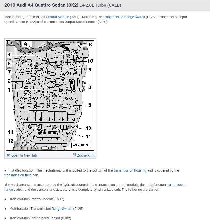

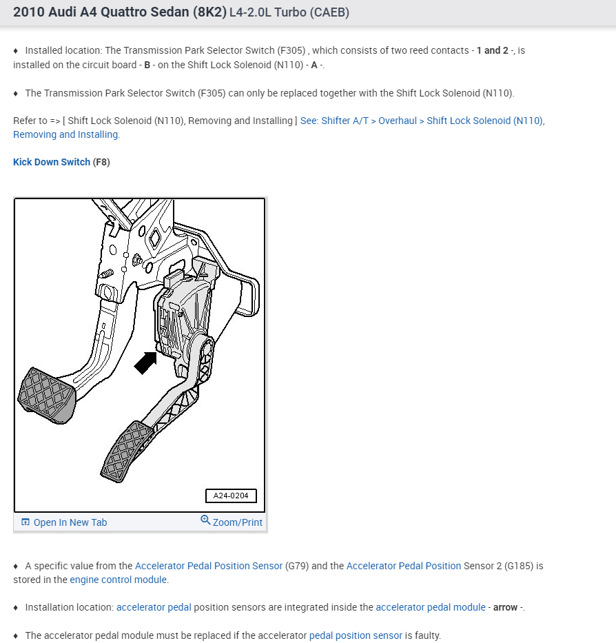

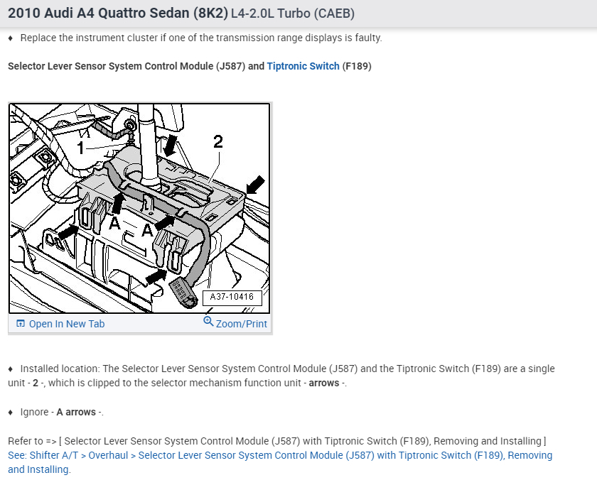

Do you know if this is a 6-speed automatic or DSG?
The TCM for these are located in the transmission housing.
I have attached diagrams below for your reference.
Also attached the general diagnostics information as well.
