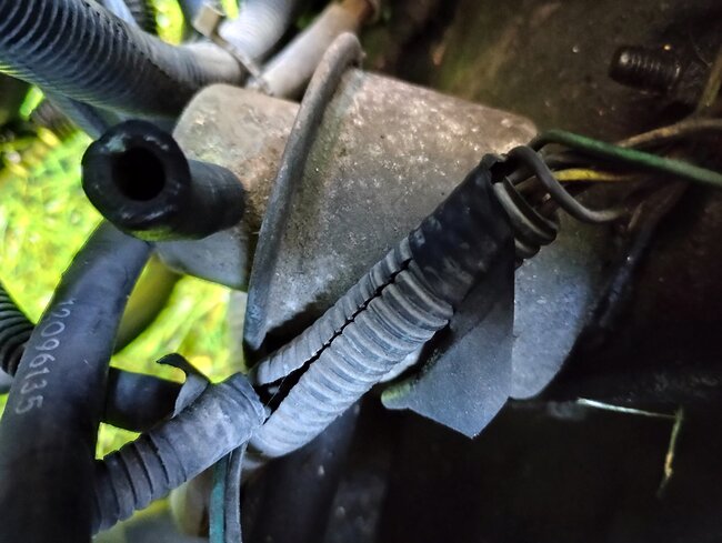

Good day. Had worn out vacuum lines running to the transmission modulator. Sometimes it would shift good and smooth other times kind of rough. Had some motor work done on it then replaced said lines. I noticed somebody has put what appears to be a diverter valve in between the modulator and the vacuum line. Not quite sure if that's supposed to be there or not. I can't find much online about it please advise.

Do you have an image you can upload? This car does not have a "transmission modulator".

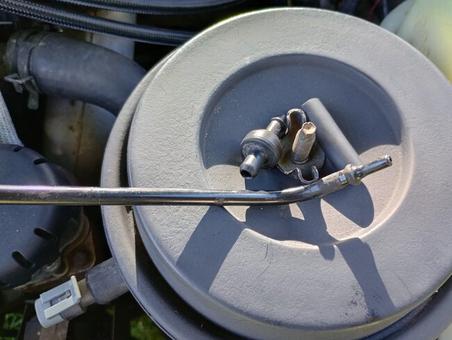

This is the metal vacuum line that connects to the rubber one and it had that diverter valve put in there before connected to the modulator.

My bad, it has been a while since I worked on this kind of car. The inline part you are talking about looks like a buffer, I would try leaving it out and connect the vacuum line directly to see if it makes a difference. Also, I would do a transmission service with a new filter. Here is a guide to help walk you through the steps:
