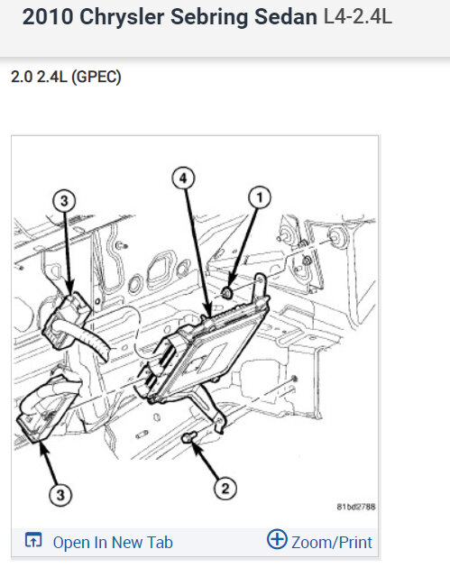

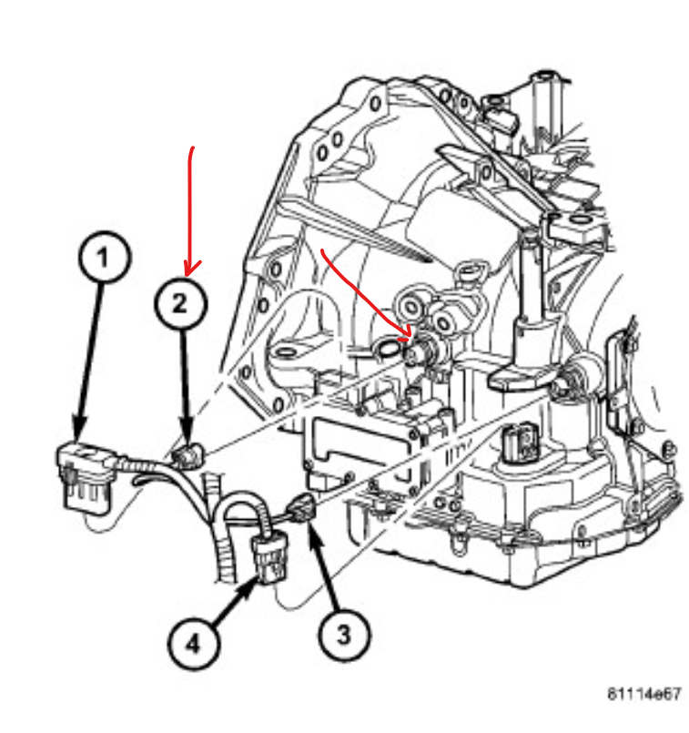

It sounds like the transmission is going out, but can I ask what the codes were? I have seen a weak input shaft sensor cause the transmission not to shift correctly, also check the transmission fluid level and to see if it is burnt (smell it). Here is the location of the sensor if you want to check it out, also, see if the electrical connector has corrosion. We might as well check the connector at the PCM as well.
