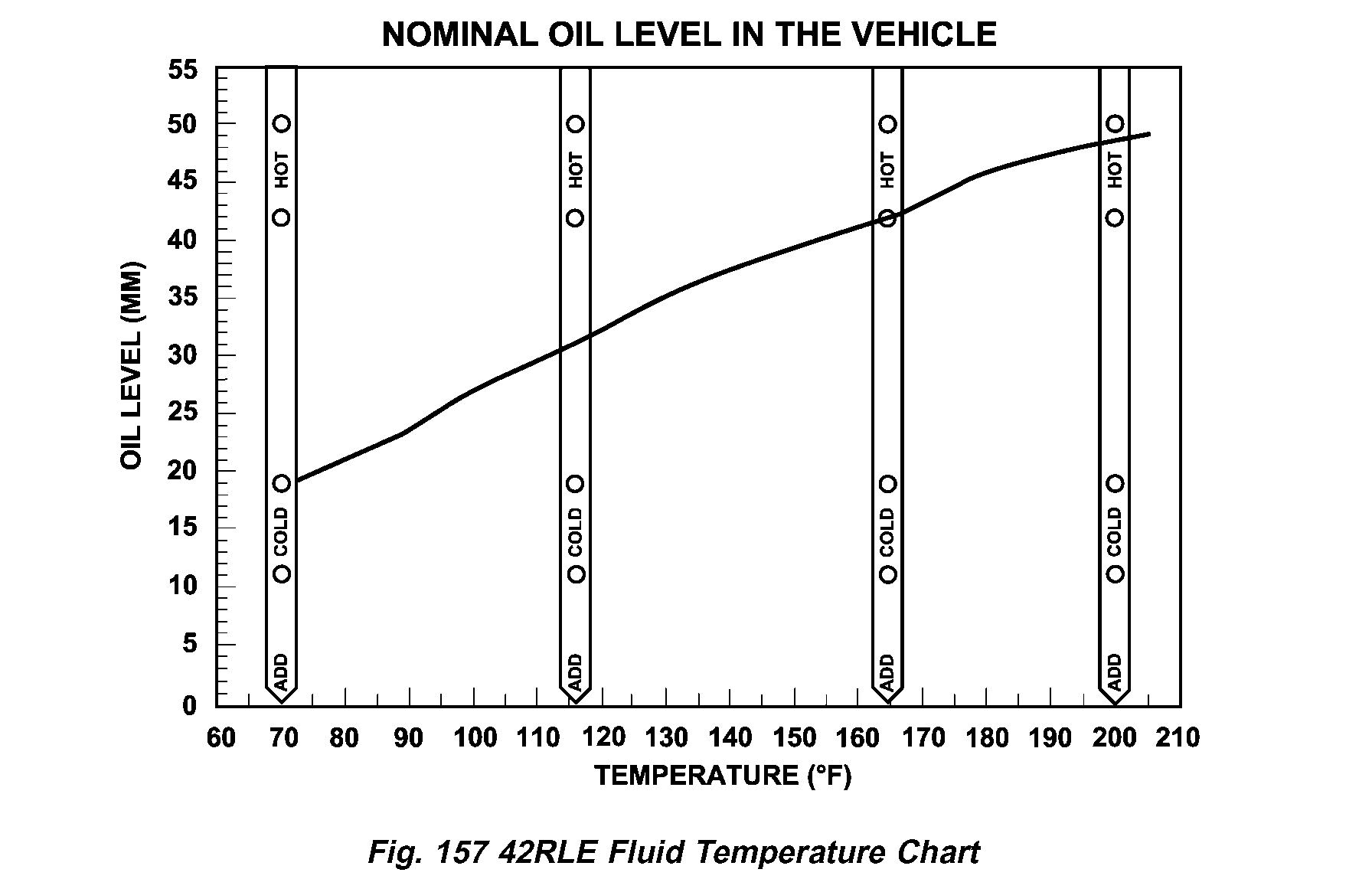

Here are the directions for checking fluid level and condition. Do this and let me know the results. The attached picture correlates with the directions.

FLUID LEVEL CHECK USING SCAN TOOL
NOTE: Engine and Transmission should be at normal operating temperature before performing this procedure.
1. Start engine and apply parking brake.
2. Connect scan tool and select transmission.
3. Select sensors.
4. Read the transmission temperature value.
5. Compare the fluid temperature value with the chart.
See Pic 1
6. Adjust transmission fluid level shown on the dipstick according to the 42RLE Fluid Temperature Chart (Fig. 157). Use only Mopar (R) ATF + 4, Automatic Transmission Fluid.
7. Check transmission for leaks.
Nominal oil level in the vehicle
Let me know the results.
