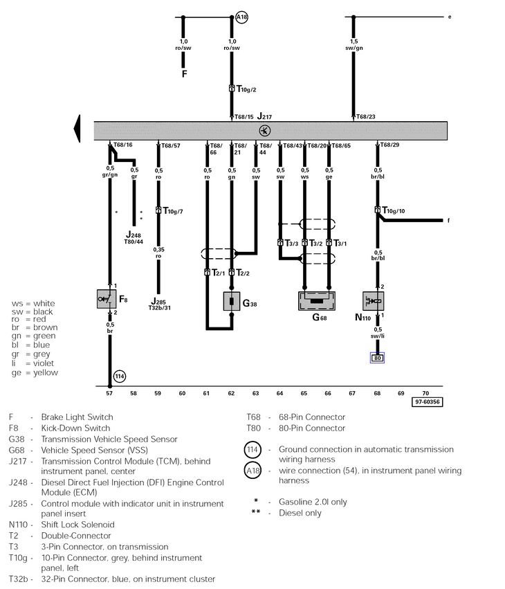

The first thing you should look at since you already changed the sensor is the wiring. Look for faulty wiring that has either chafed, corroded or broken wires or connector. Has there been a leak of the transmission fluid that could have caused damage to the wiring or connector? Check the wiring between T2 and T68 and the connectors themselves.

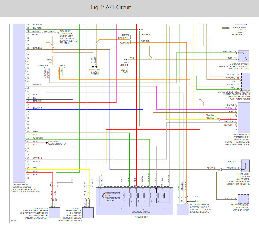

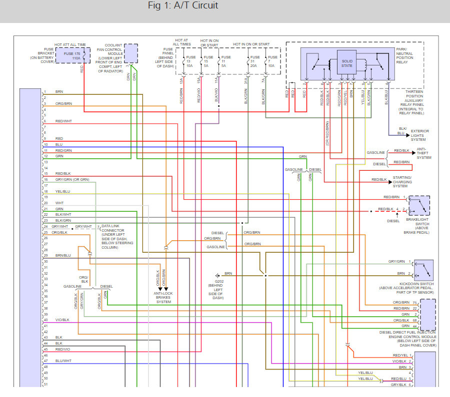

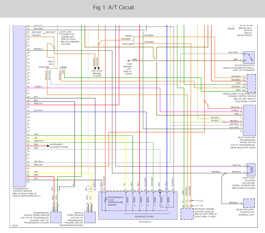

Here is a guide to help you test the wiring and I found these transmission wiring diagrams for you as well:
