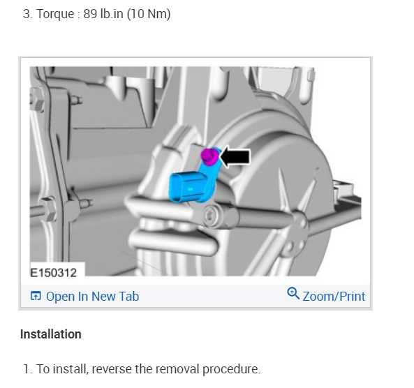

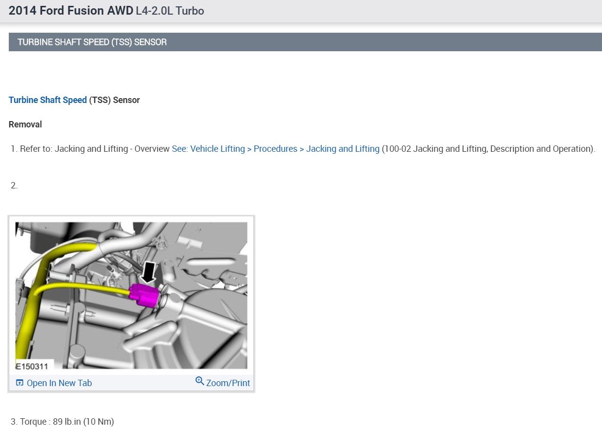

It sounds like you have an input shaft speed sensor that is not working correctly. To be sure we should run the codes to see if anything comes up. here is a guide:
Here is the location of the sensor so you can check it out. Check out the diagrams (below). Please let us know what you find. We are interested to see what it is.
