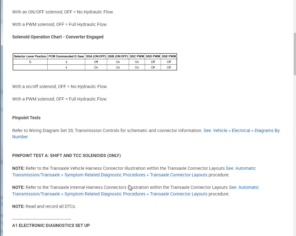

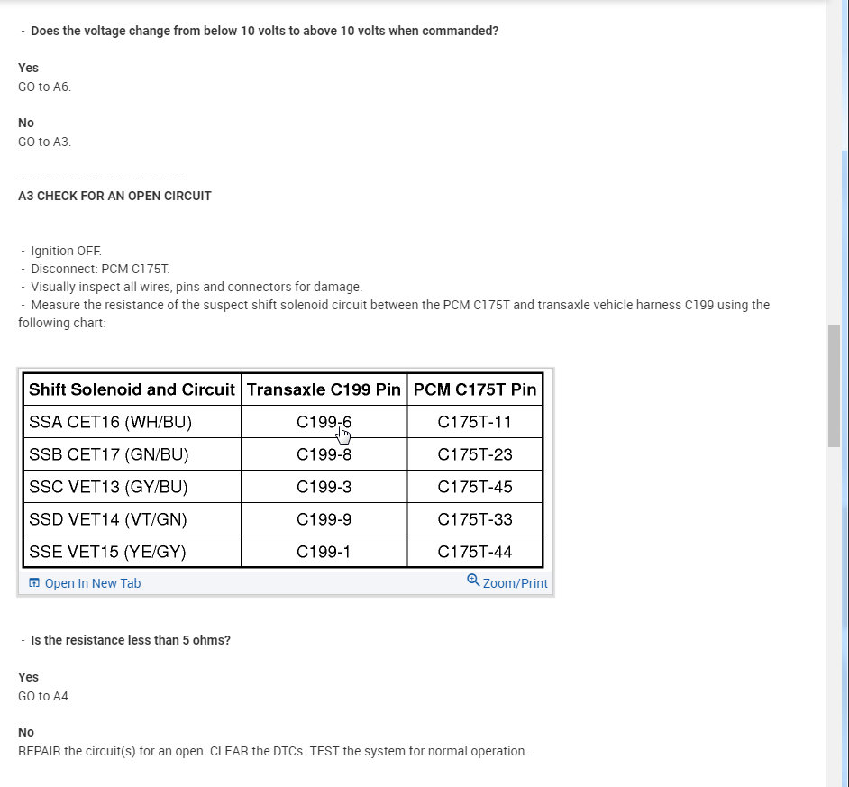

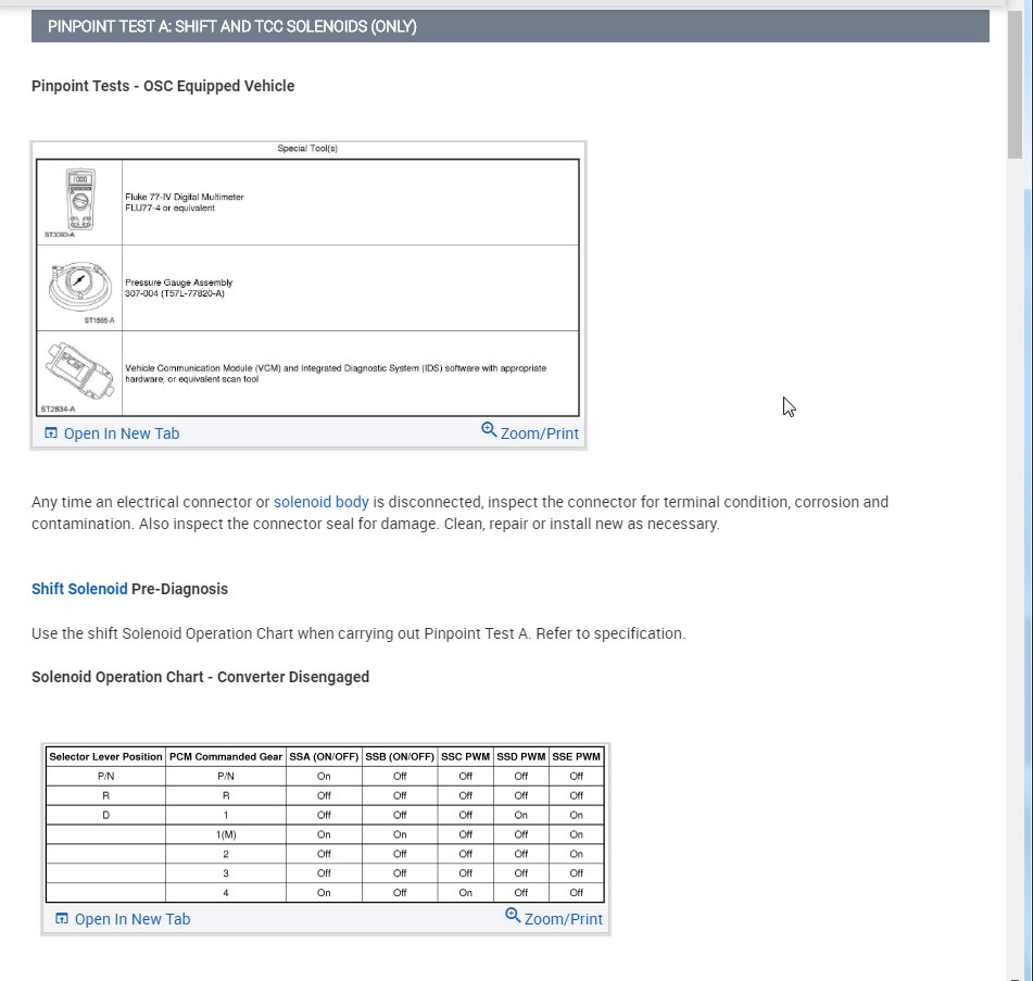

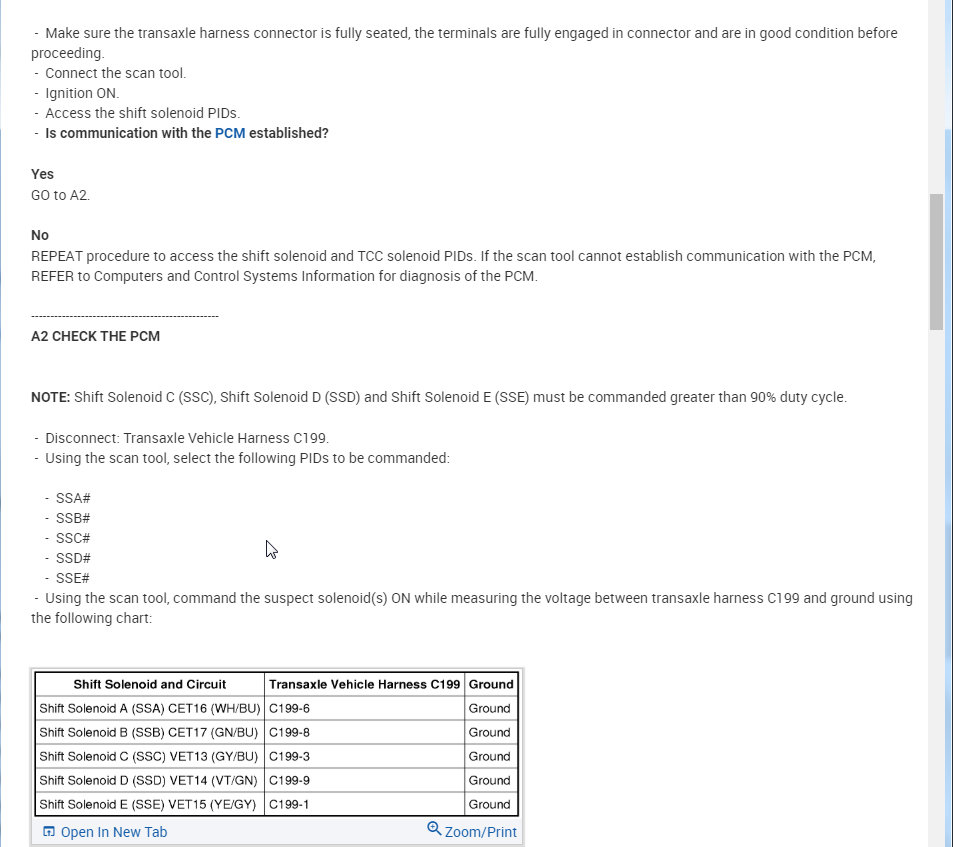

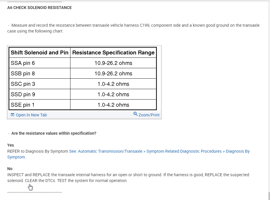

Okay. That is the torque converter solenoid and I attached the testing for it. Basically it could be the solenoid but there is also a possible wiring issue or even the PCM. The only way to know is to perform this testing.
Let me know if you have questions but I would run through this testing or have someone run through it because replacing solenoids only to find out it didn't fix it is not desirable. It is one thing if it is a sensor that is easy to get to but this is not the easiest job to "guess" at.

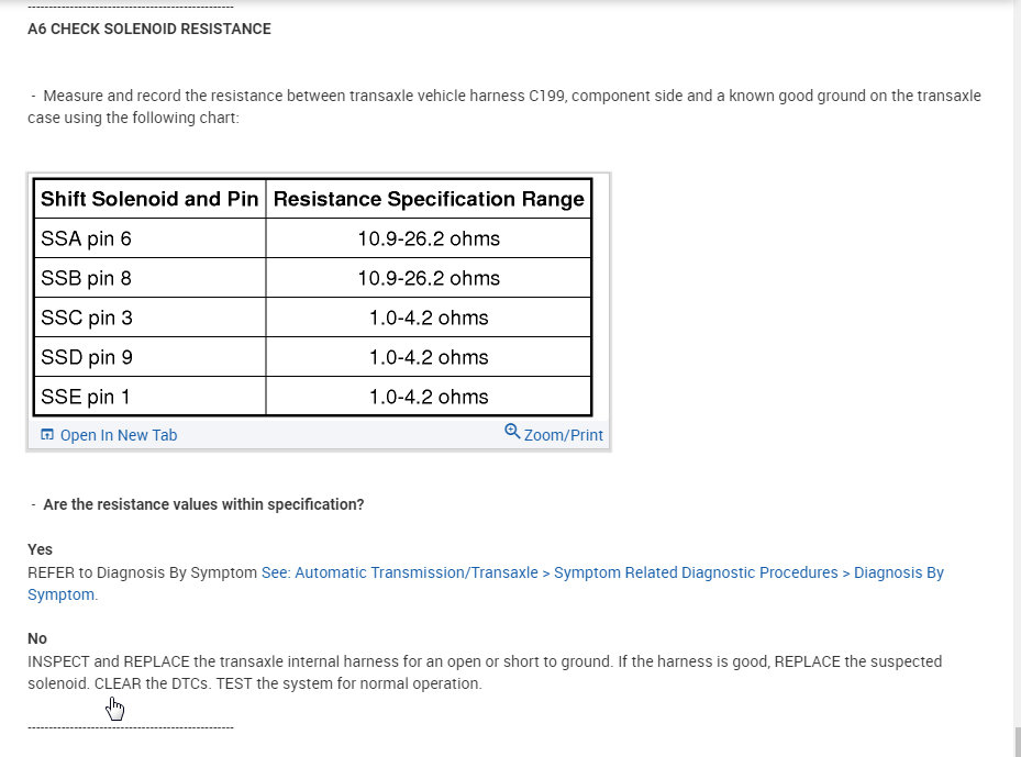

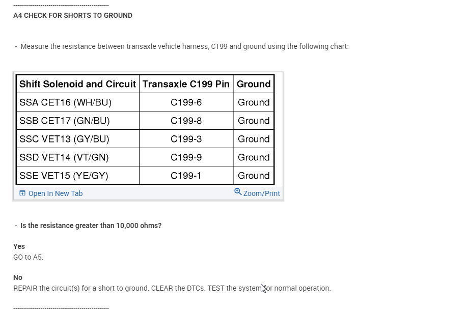

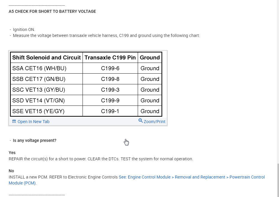

Okay. If they have all been replaced then that pretty much leaves a wiring issue. If you look at the last few pages of the testing that I provided it goes through what tests need to be performed.
Let me know if you have questions but we need to test for an open circuit, short to power or short to ground.

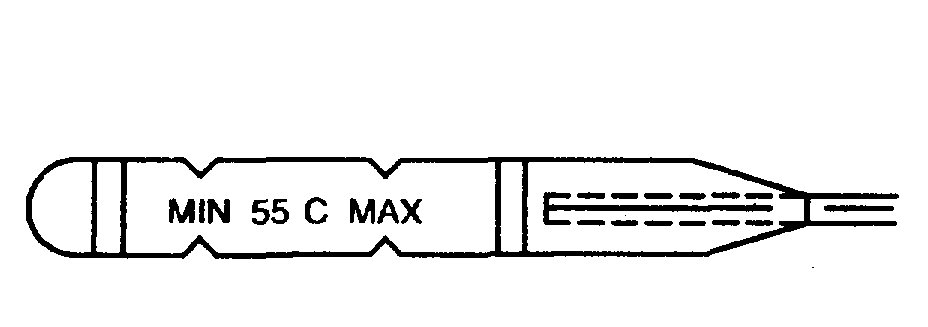

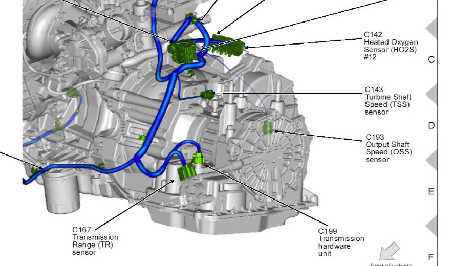

Where is the output speed shaft sensor located?
Sep 19, 2020 at 1:35 PM (Merged)
Good morning.

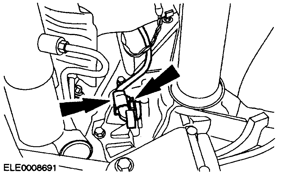

I attached a picture for you to view. Very easy replacement. Check out the diagrams (Below). Please let us know if you need anything else to get the problem fixed.
KAILYKOS
I'm looking for the location on the vehicle listed above SE station wagon zetec automatic transmission output speed sensor.
It is located on the rear of the transmission.
Here are the directions for replacement. The remaining pics correlate with the directions.

pic 1
3. Remove the OSS sensor.
- Disconnect the electrical connector.
- Remove the bolt.
- Inspect the OSS bore.
pic 2

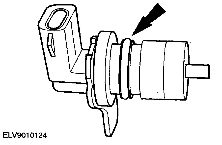

4. Inspect the O-ring seal for nicks or cuts; install a new O-ring if necessary.
Installation

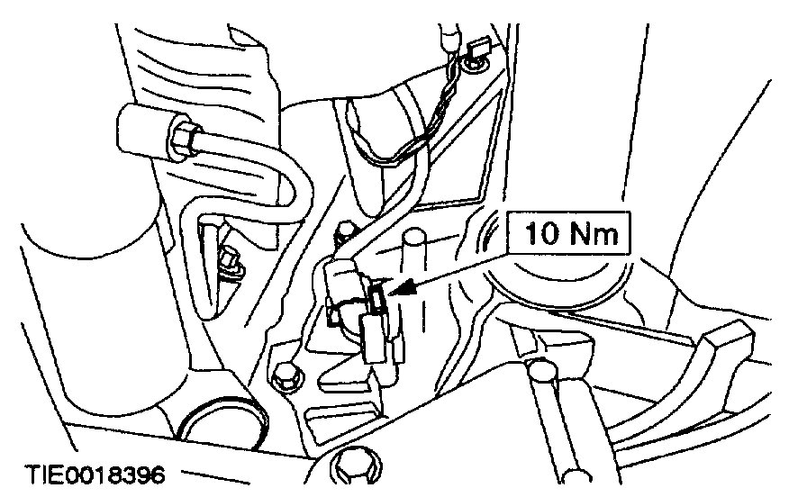

pic 3
1. NOTE: Apply a light coat of petroleum jelly to the O-ring before installation.
Install the OSS sensor.
- Connect the electrical connector.
