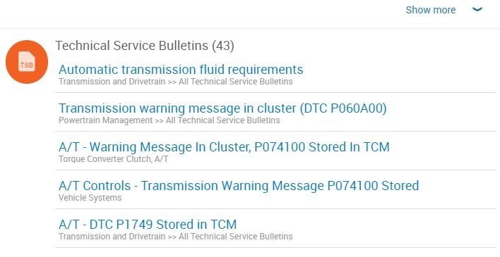

Honestly, yes it could need reprogrammed, but I checked and don't see any technical service bulletins related to shifting. I attached a picture. It shows what transmissions TSB's are active.

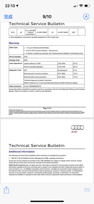

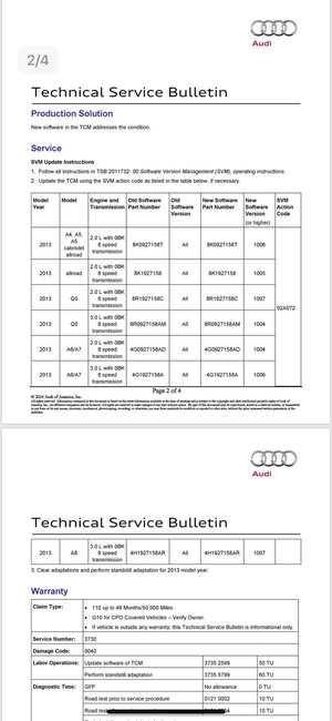

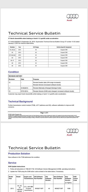

Thanks again for the response. The TSB regarding TCM update is Group 37 #16-69 (see pictures). It was released on September 30, 2016. Yet I didn’t notice such shifting issues back then; it’s only a recent thing. But it seems like the TSB addressed the similar issue I’ve experienced so I’ll give it a try. I’ve scheduled for dealer visit next week so I’ll report back if the TSB helps or not.
Regarding the fluid, the shop did tell me that they checked fluid level as well as temperature but found nothing. I’m not 100% sure if they did it the correct way. But few month back I had a transmission flush done which was supposed to replace all the old fluid with new one (I used ZF Lifeguard 8). So I’m confident it shouldn’t be because of low fluid.
Anyways, thank you again for all the help! I’ll report back if the TSB solves the problem. :)

Sorry forgot to attach the pictures. Here they are.
