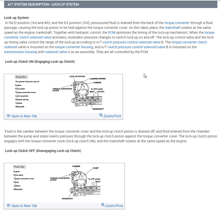

Hi John,
Yes. A torque converter does make sense in this case. It could be due to the fluid but more than likely the converter clutch is slipping or not being able to lock up completely. Basically, if the transmission is throwing a code related to the transmission and you are having transmission issues then let's address that code and go from there.
Let me know what questions you have. Thanks
