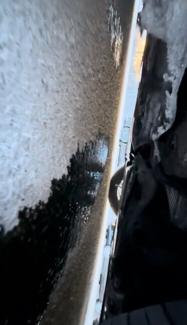

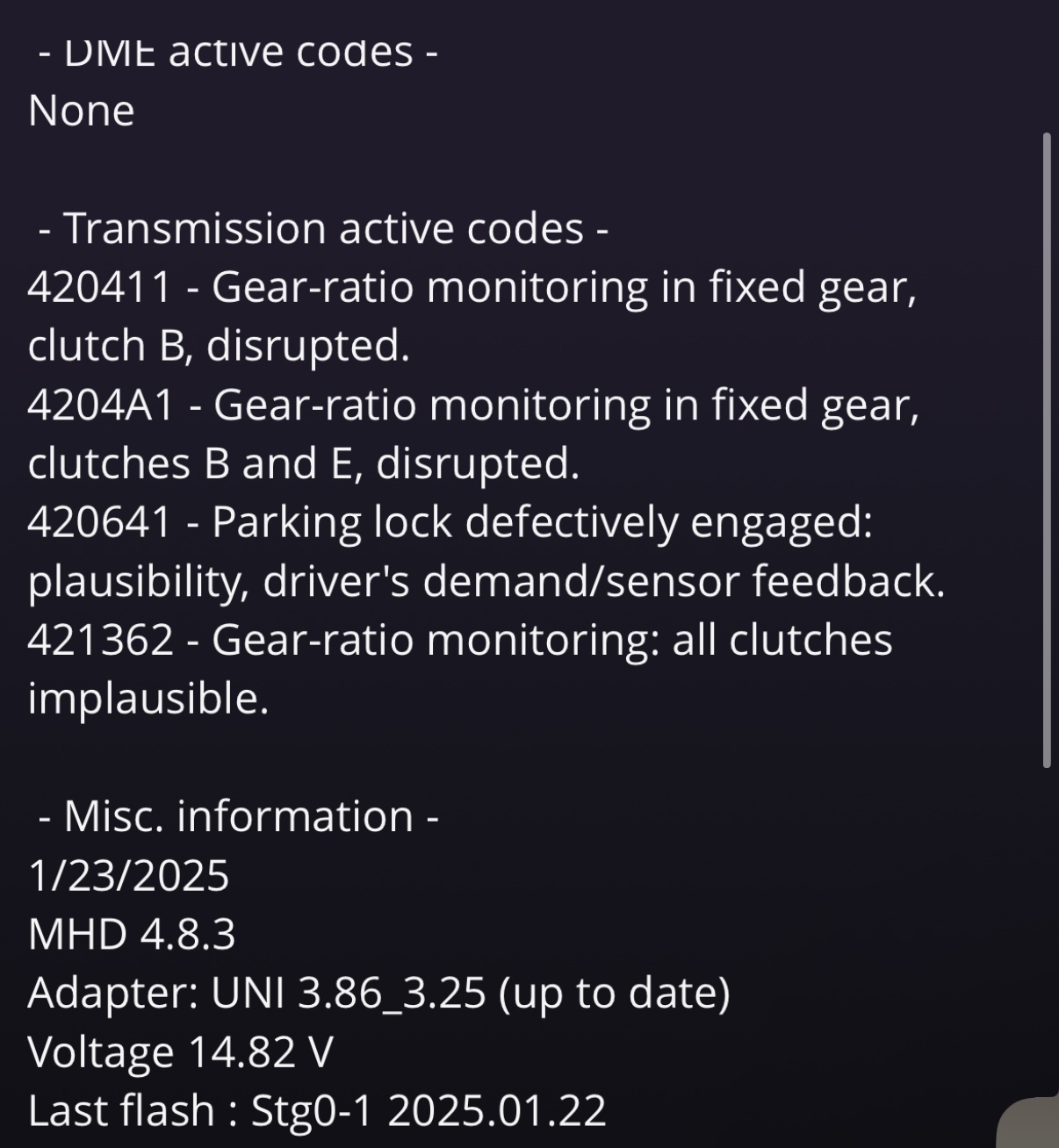

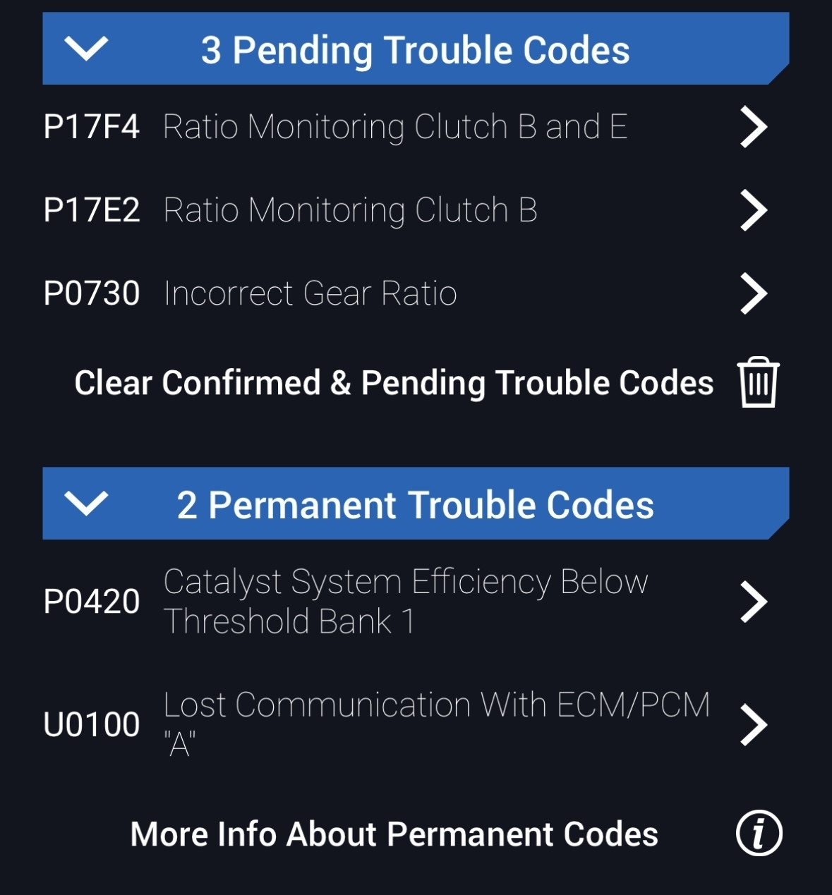

Had these codes pop up on my 340i x drive .

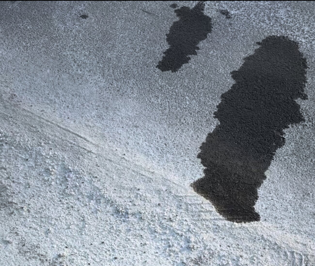

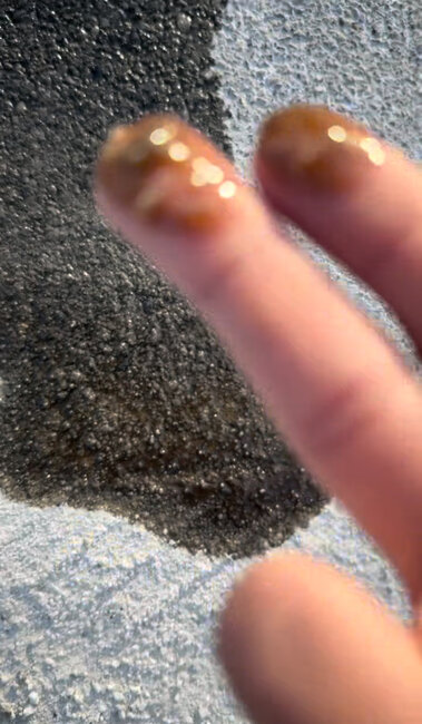

The story: Started up the car in 10-degree weather; I let it warm up and was driving and car started driving 2nd gear and when it went to 3rd gear it like pushed me hard to my seat like a thumb sound. I didn’t think of it much thinking so kept driving and then it went to 4th gear and so I pulled over and put in park and just let it warm up more; after 15 minutes I started heading back home and once I got near home; the chime went off and the car literally skipped from 2nd gear to 3rd, 4th, 5th, 6th really quick and the car went automatically to park and then the car stopped; I tried going in drive, reverse or even neutral and just kept going to park after it stopped it leaked transmission oil about half a regular size water bottle of oil; I got it towed to my house and now trying to deal what’s going on. It has 80,000 miles I bought from a previous buyer I’m not sure if he ever did transmission flush and so if anyone can help will appreciate it.
