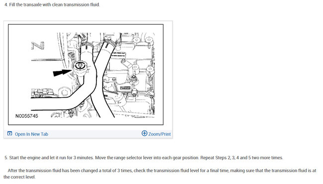

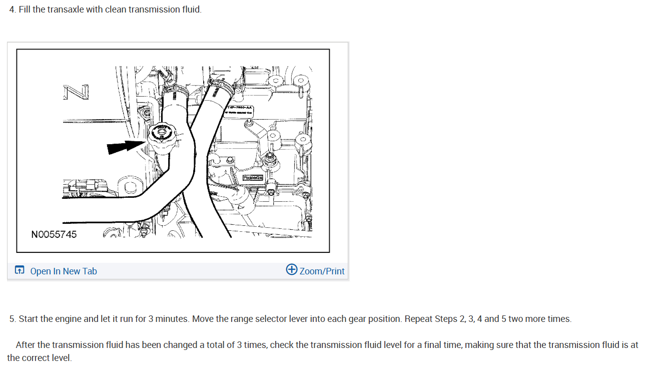

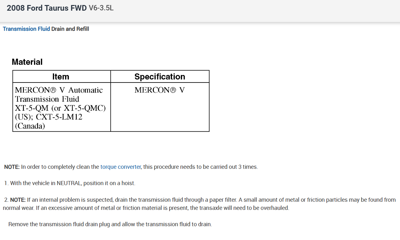

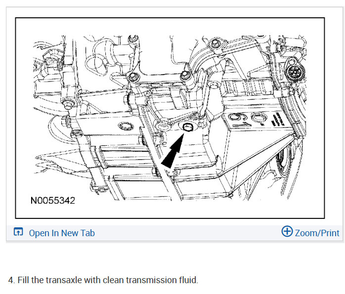

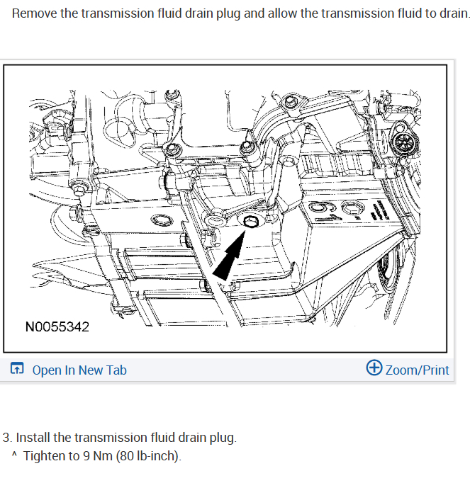

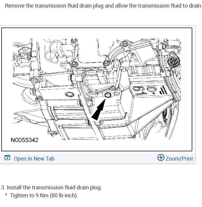

If the fluid is worn out it can make the transmission slip and overheat, this will foam the fluid and force it out of the dip stick, I would try servicing the transmission. Here is a guide to help with instructions below to help with your car:
Please go over these guides and get back to us.
