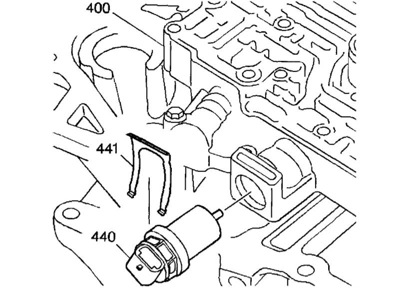

the input speed sensor may be there because the input shaft was not turning fast enough to send a signal.
The sensor is inside the transmission under the side cover on the drivers side of the trans.
