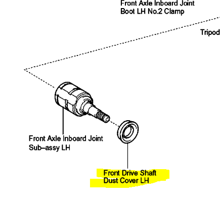

If it is leaking where the CV axle enters the transmission, chances are it is only a seal/dust cover that has failed. See pic 1.
I have no idea why the transmission itself would need to be replaced unless something is cracked. Next, if the CV axle isn't making sense to me unless there is a known issue with the CV joints. Have you ever heard clicking while you make a sharp turn? What does he mean by the tire isn't running true? If the tire has excessive play, I would suspect the hub/wheel bearing and not the axle.
See pic below.
