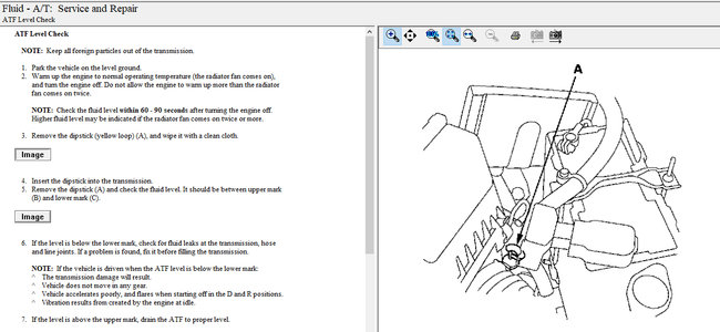

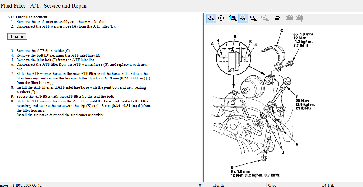

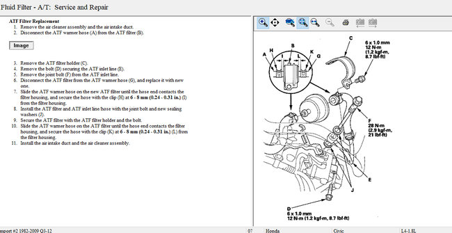

transmission fluid filter located inside engine compartment under the air cleaner assembly, check the picture below.

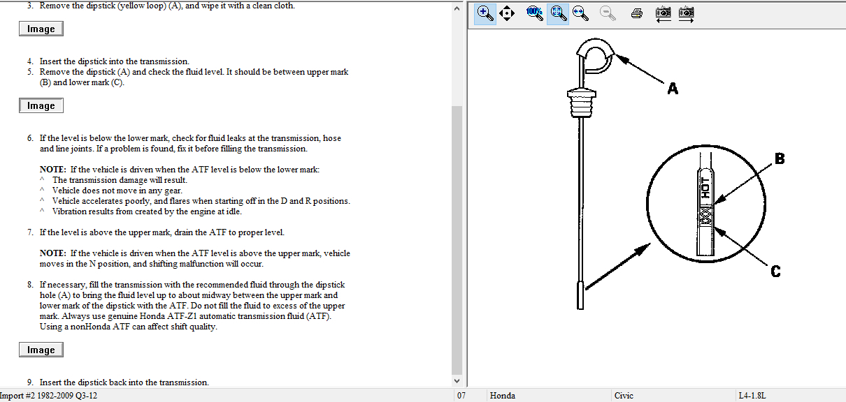

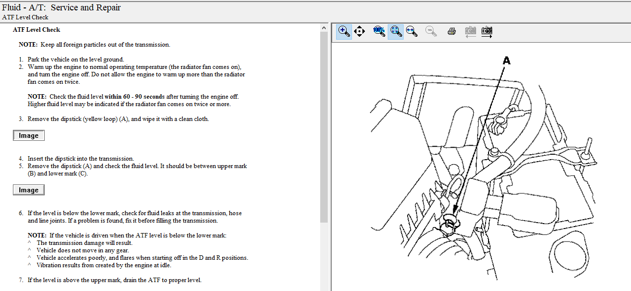

also check the procedure how to check the ATF fluid level.
