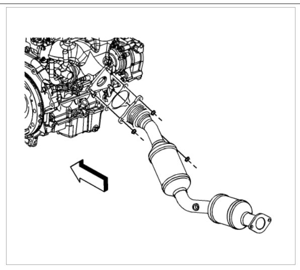

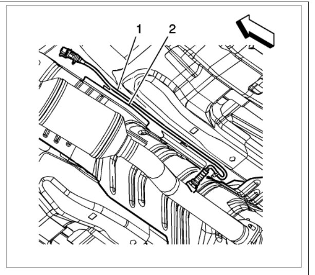

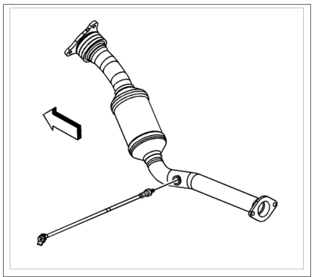

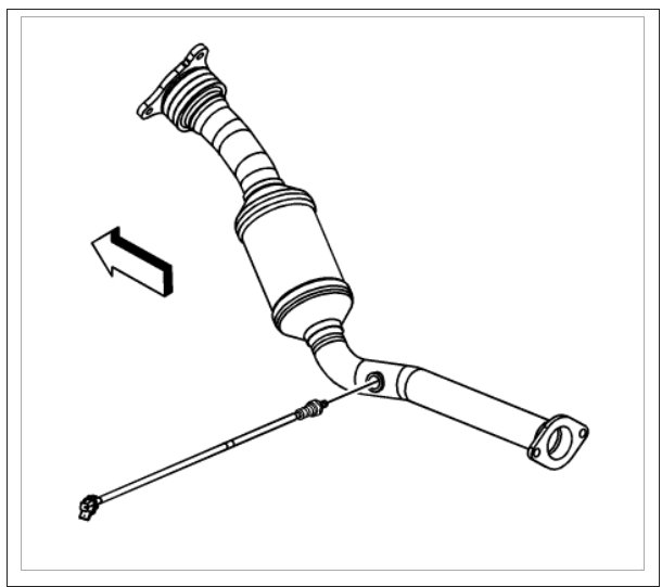

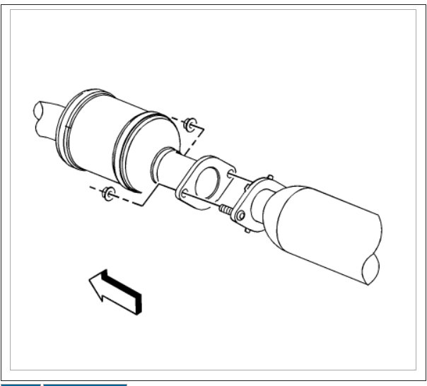

Here is a guide and diagrams (below) of what it will take to replace it;
https://www.2carpros.com/articles/catalytic-converter-replacement
Check out the diagrams (below).
