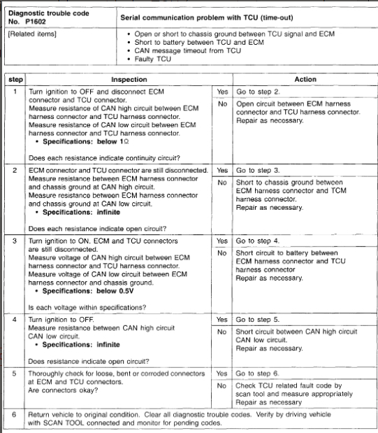

I was finally able to get the code; it is p1602.

It sounds like you are having a problem with the TCU (transmission control unit). I've attached a diagnostic chart below to help test.Hope this helps and thanks for again for using 2CarPros.

By just clearing the code if there is a fault the condition will keep showing up as in the case here until the repair is completed.It sounds like you are having an issue with the TCM (transmission control module) I will re-attach the diagnostic procedure again below.Hope this helps and thanks again for using 2CarPros.

After you tighten the cable let us know if the symptom returns.If so, please use the transmission control module diagnostic chart I've attached previously.Hope this helps and thanks again for using 2CarPros.
