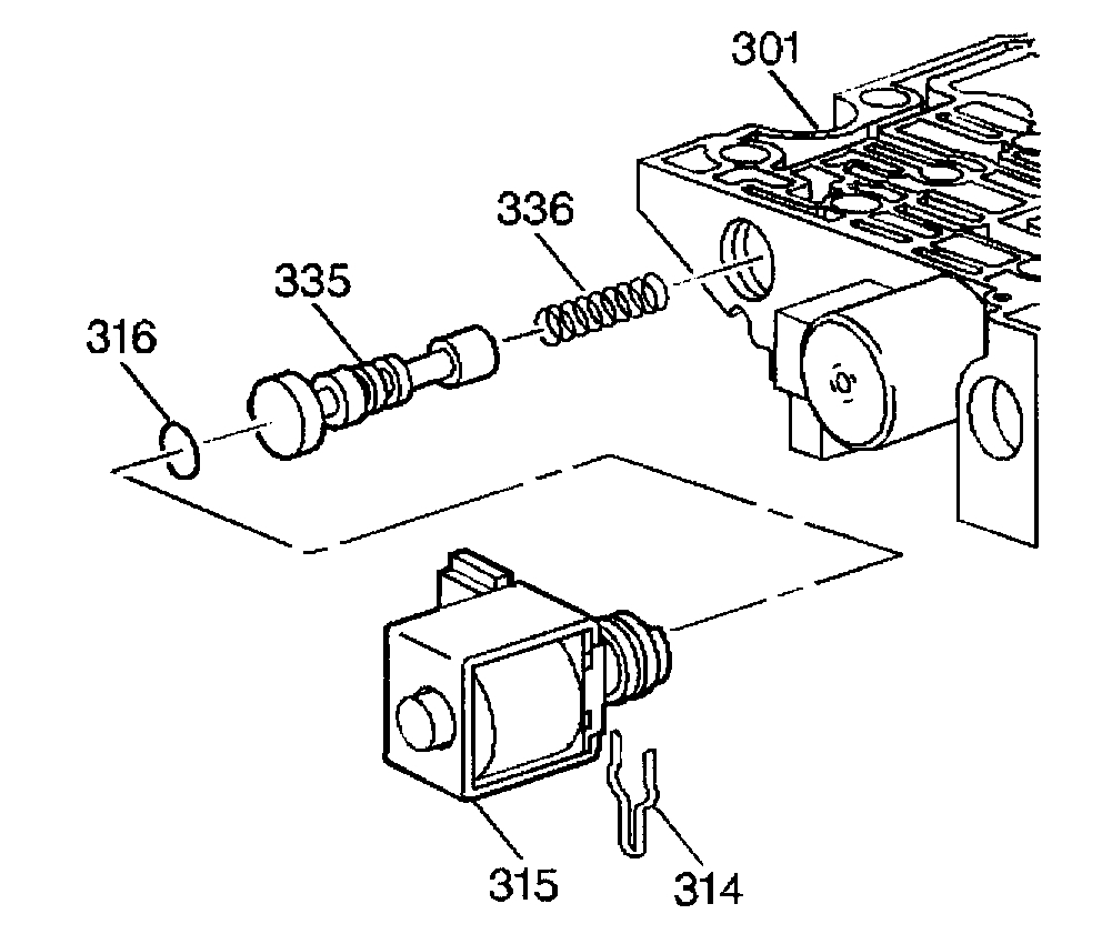

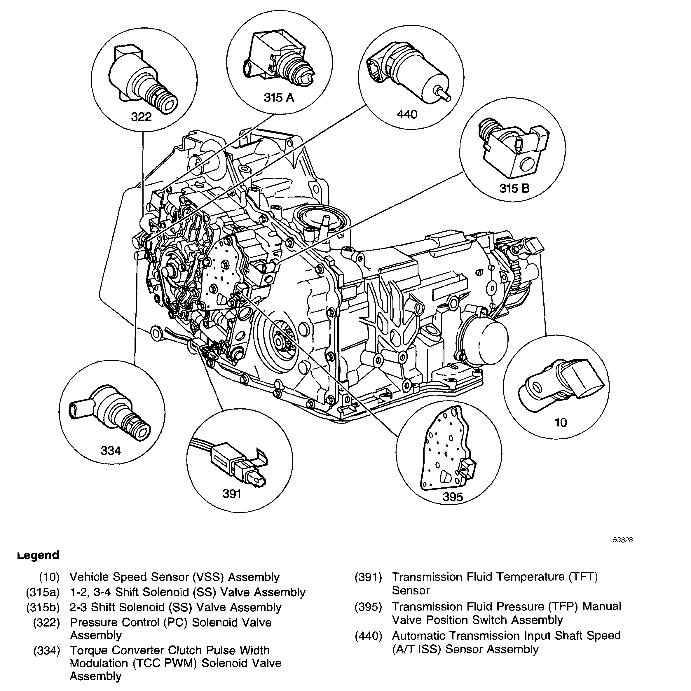

Here are the directions for the TCC solenoid. Picture 1 shows locations of all sensors and solenoids. The remaining are related to the TCC.
TORQUE CONVERTER CLUTCH SOLENOID
Removal Procedure
picture 2
1. Remove the case side cover. Refer to Case Side Cover Replacement.
2. Disconnect the transaxle wiring harness.
3. Remove the torque converter clutch solenoid (315).
Installation Procedure
picture 3
1. Install the torque converter clutch solenoid (315).
2. Connect the transaxle wiring harness.
3. Install the case side cover. Refer to Case Side Cover Replacement.

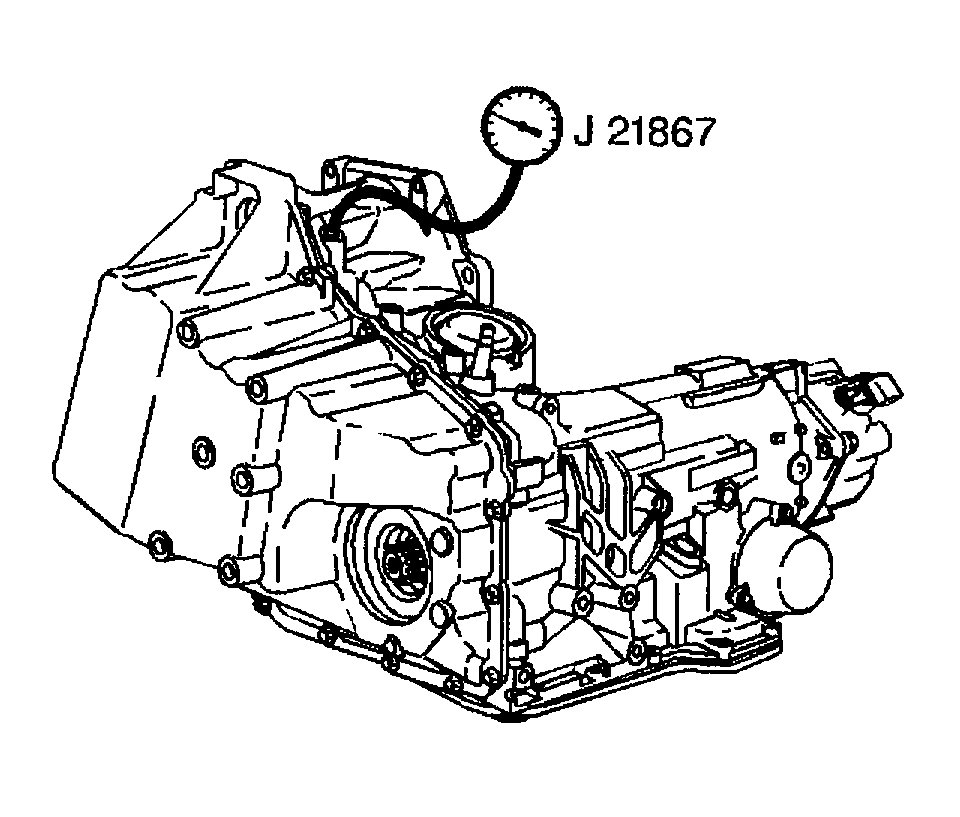

If it isn't shifting into 4th, confirm line pressure. Here are the directions and picture 4 correlates with these directions.
LINE PRESSURE CHECK PROCEDURE
^ Tools Required
- J21867 Universal Pressure Gauge Set
Important: Before performing a line pressure check, verify that the Pressure Control (PC) solenoid valve is receiving the correct electrical signal from the PCM.
1. Install a Scan Tool.
Caution: Keep the brakes applied at all times in order to prevent unexpected vehicle motion. Personal injury may result if the vehicle moves unexpectedly.
2. Start the engine and set the parking brake.
3. Check for a stored Diagnostic Trouble Code (DTC) .
4. Repair the vehicle, if necessary.
5. Check the fluid level. Refer to the Transmission Fluid Checking Procedure. See: Fluid - A/T > Component Tests and General Diagnostics > Transmission Fluid Checking Procedure
6. Check the manual linkage for proper adjustment.
picture 4
7. Turn the engine off. Remove the oil pressure test hole plug and install the J21867.
8. Put the gear selector in PARK range and set the parking brake.
9. Start the engine and allow the engine to warm up at idle.
Notice: Total test running time should not be longer than two minutes, or else transmission damage could occur.
10. Access the PC solenoid valve control test on the Scan Tool.
11. Increase the PC solenoid actual current from 0.0 to 1.0 amps in 0.1 amp increments. Allow the pressure to stabilize for five seconds after each pressure change. Read the corresponding line pressure on the J21867.
12. Refer to the Line Pressure specification table. Compare the data to the table.
13. If pressure readings differ greatly from the table, refer to Incorrect Line Pressure. See: Automatic Transmission/Transaxle > Symptom Related Diagnostic Procedures > Incorrect Line Pressure
14. Remove the J 21867.
15. Apply sealant GM P/N 12345382 to the oil pressure test hole plug
Notice: Refer to Fastener Notice in Service Precautions.
16. Install the oil pressure test hole plug.
Tighten
Tighten the oil pressure test hole plug to 12 Nm (106 inch lbs.).

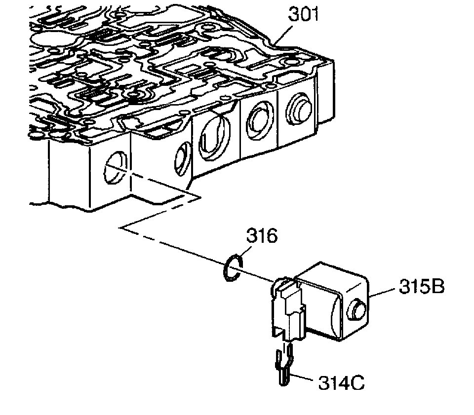

Here are directions for the 2-3 shift solenoid if needed. The remaining pics correlate with these directions.
2-3 SHIFT SOLENOID VALVE REPLACEMENT
Removal Procedure
picture 5
3. Remove the 2-3 shift solenoid (315B).
picture 5 also
1. Install the 2-3 shift solenoid (315B).
